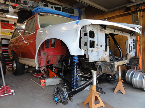

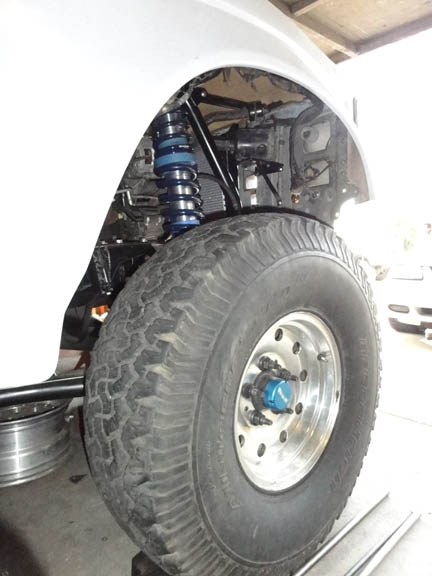

Thanks ChaseTruck754 for the wheels. I had the rotors mounted backward which pushed everything out 1". Once I switch them, it brought the caliper and rotor to where they needed to be. Should have looked at the pictures on John website before installing. The Alcoas will fit fine once the centers are opened up for large hubs.

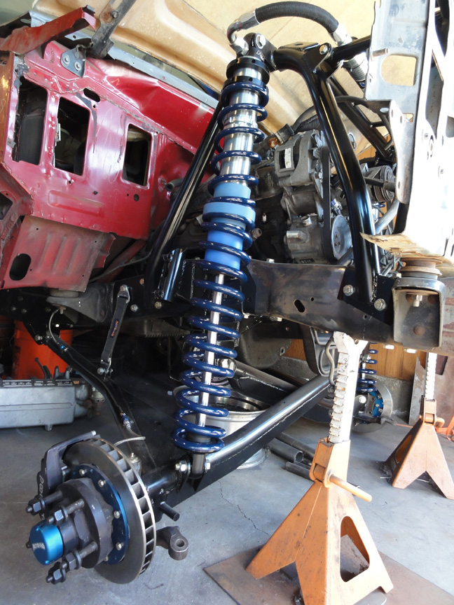

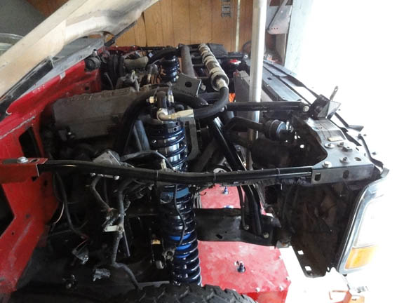

I got the resevoir hoses shortend on the 3.0 coilovers and the spings installed. I had Mirage in Santee do it for me. They are a great help and are really reliable. Installed the shocks and made mounts for the resevoirs. I got everything painted and torqued. Autofab is also making me equal length steering.

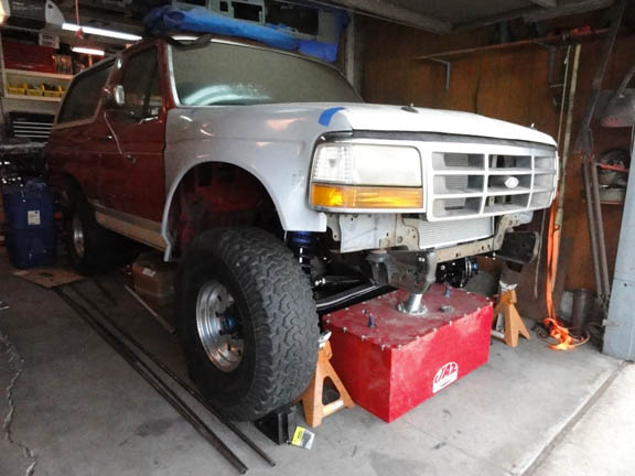

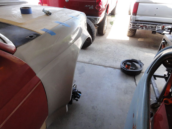

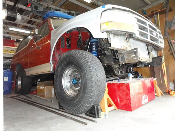

Seeing how these Autofab fenders are going to look. I put jack stands under the front i beams to check the sag of the front end. It didn't sag enough....
So I pulled the shock and having the upper spring change from 400# to 300#.
This should set the front end were I need it. Also taking the front spindles to Autofab to have them modified for the equal lenth steering setup.
Vessel fenders from Autofab.
