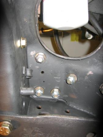

Driver side pics
- No more rivets
- Gr81.jpg (27.7 KiB) Viewed 2872 times
- Dside6.jpg (34.2 KiB) Viewed 2872 times
- Dside mount2.jpg (34.62 KiB) Viewed 2872 times

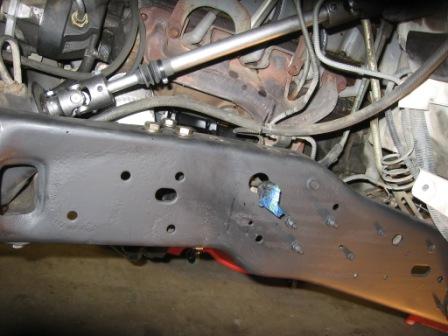

Steering has been very sloppy, I was amazed how much play was in the old steering shaft. New Borgeson was fitted and removed for driveway rattlecan( yes Steve I used self-etching primer before paint).

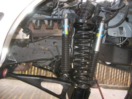

Buckets mounted and playing with cycling to determine shock tab locations and then I will pull it apart and rattlecan the unpainted stuff and do a final assembly.
- Dsidebucket1.jpg (33.64 KiB) Viewed 2842 times
- Passside2.jpg (29.97 KiB) Viewed 2842 times
- Dside1.jpg (34.09 KiB) Viewed 2842 times

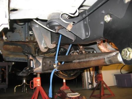

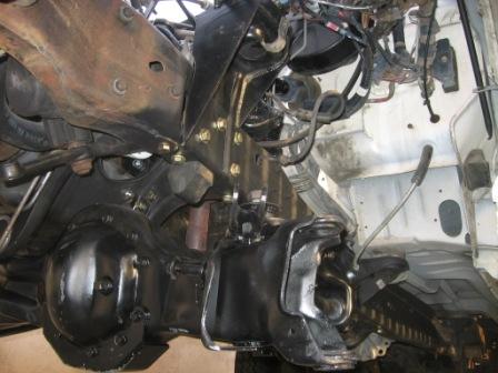

Need to adapt the factory bumps on the bottom of the Spirit Racing coil buckets. More Pics....
Doing some maintenance stuff as well I pulled throttle body for a parts washer spa day cleaning. Upper intake will get the same treatment so I can replace valve cover gaskets and keep the 302 running for a while until I rebuild the 351 and E40D that I have waiting.
- Dside5.jpg (42.05 KiB) Viewed 2843 times
- Dside3.jpg (38.91 KiB) Viewed 2843 times

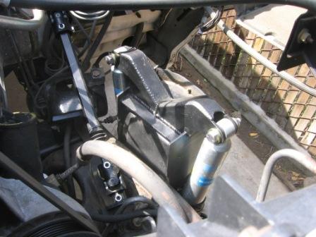

Some update pics on the '87.
Got the shocks cycled and tabs tacked ready to tig. Gotta get a 60 degree or 90 degree adapter to clear the A/C evap so I can drop resi and mount low or rotate up and mount on cross bar.
- 87psd1.jpg (34.01 KiB) Viewed 2756 times
