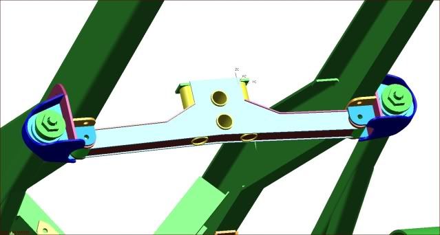

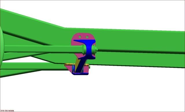

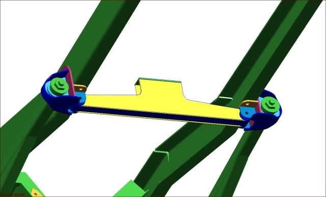

Got some headway with the rad arm mounts, and trans mount. Need to get some measurements where a few componets are located to get a better feel for the trans mount.
May have to go low tech when designing the coil buckets. Cardboard and sharpie. Once done in cardboard I can transfer it to CAD, and clean it up.

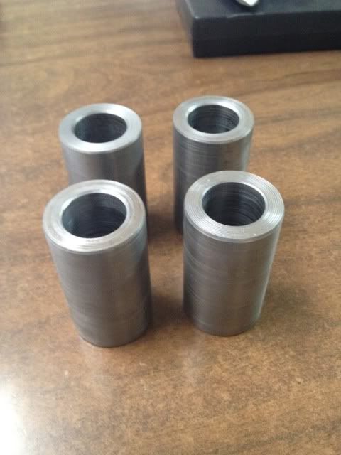

Just picked up 2 bushings for the trans crossmember, and 4 for the cage.
By the sounds of it my hyd bump stops are on the truck for delivery.

Bushings for trans and cage.

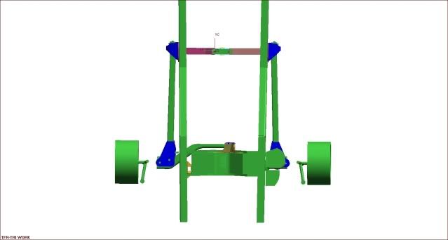

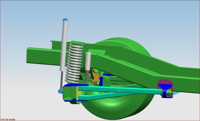

Got a rough model in place for the shocks and bumps.
With the 5.5" deaver coil I should be able to get 21" travel, that is if I can keep the joints from binding.
At the spring it's about 6" uptravel and 8" droop. This is with the 14" travel fox shocks in front of coil and I still have 1" on the bump.

So , are you moving the lower coil mount in on the beam, or moving the top out to meet the f150 coil mount, or have i missed it entirely.

Moving the coil mount on the beam inwards.

Are the bushings polyurethane or delrin/acetal?
I'm sure they're probably poly but the pic makes um look like delrin.

Poly. They are the ruff stuff bushings.

Got it. I figured there wouldn't be a zerk on delrin, but maybe if it was the lower end, non impregnated stuff.

Originally they were not the ones I was after, but a buddy had 6 from a past project and wasn't planning to use them. Couple tweaks to my CAD model and they fit perfect.
