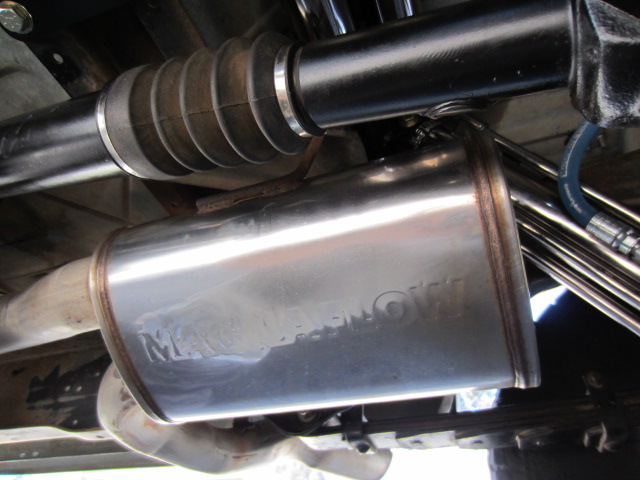

Muffler like this
Then routed kind of like this. It will end up over the frame rail and out in front of the tire. Excuse my sweet paint skills.

Magnaflow makes a same side in n out as well...

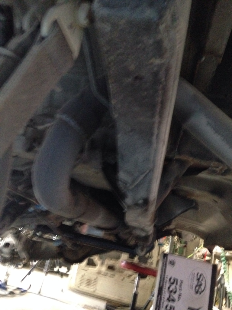

Same idea but turn 90 degrees and tucked up above the driveshaft right under the rear seat.

It's currently running two cats no muffler and turned down right after the cats.

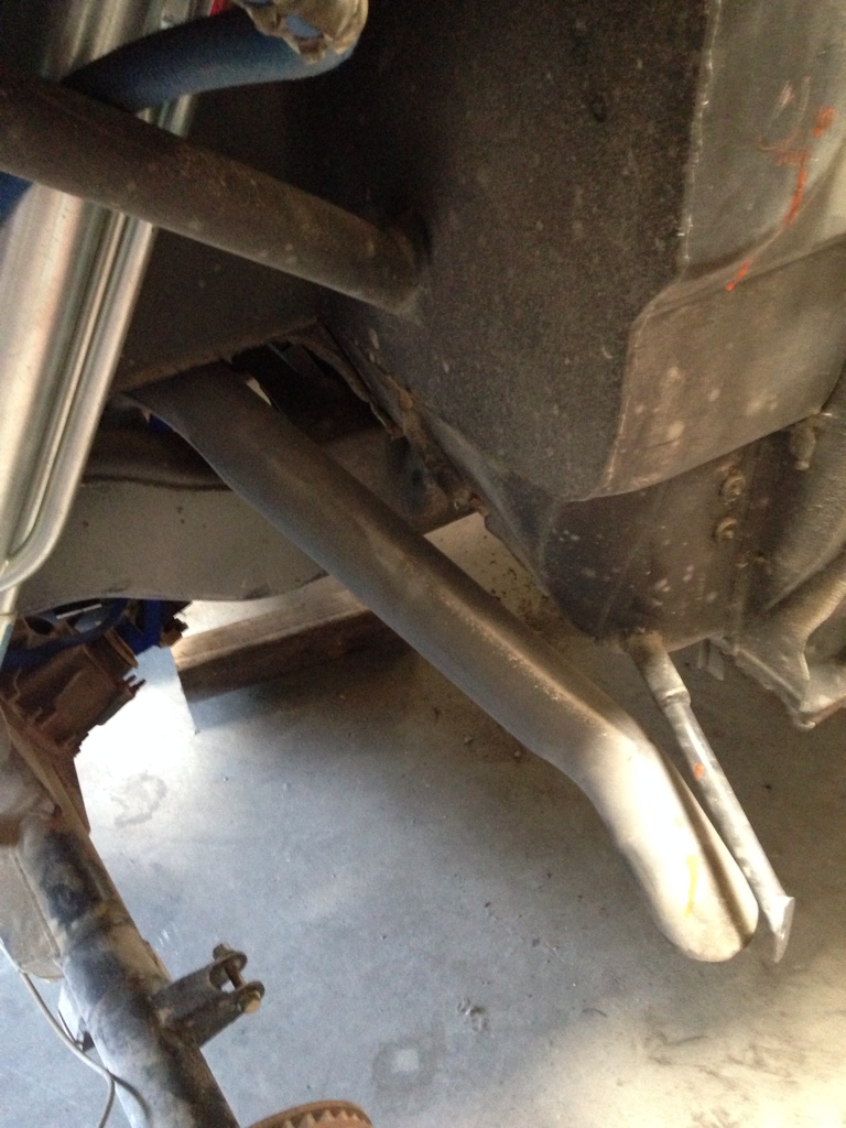

Here is mine. Not sure how much room the upper links need but I'm very happy with this set up. My first trip with the turn down melted my limit straps! This was the remedy and works great. I was gonna go through the bedside but this just seemed more low key.

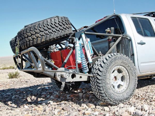

No texting back and forth with Dustin about sway bars.
Re: Tina Turner
Ah gotcha, ya I've seen that style before looks interesting. I've asked a few guys about them who run them they say they work well. I only have experience with the standard style. I'm interested to see what you guys come up with.

Apparently he drives like an Asshole and the body roll is getting the best of him. haha
Just tossing around ideas.

It would take a major rework im sure but if you ran a hub as the pivot point for the canti's then you could use them as a sway bar arm. Could run warn hub for a sway bar disconect on one end as well. It has been done on a few menzinie arms set ups ive seen.

There is not enough room between the frame and tire for a hub like that. That was the original plan. If it was done it would need a wider axle and a custom hub set up.
