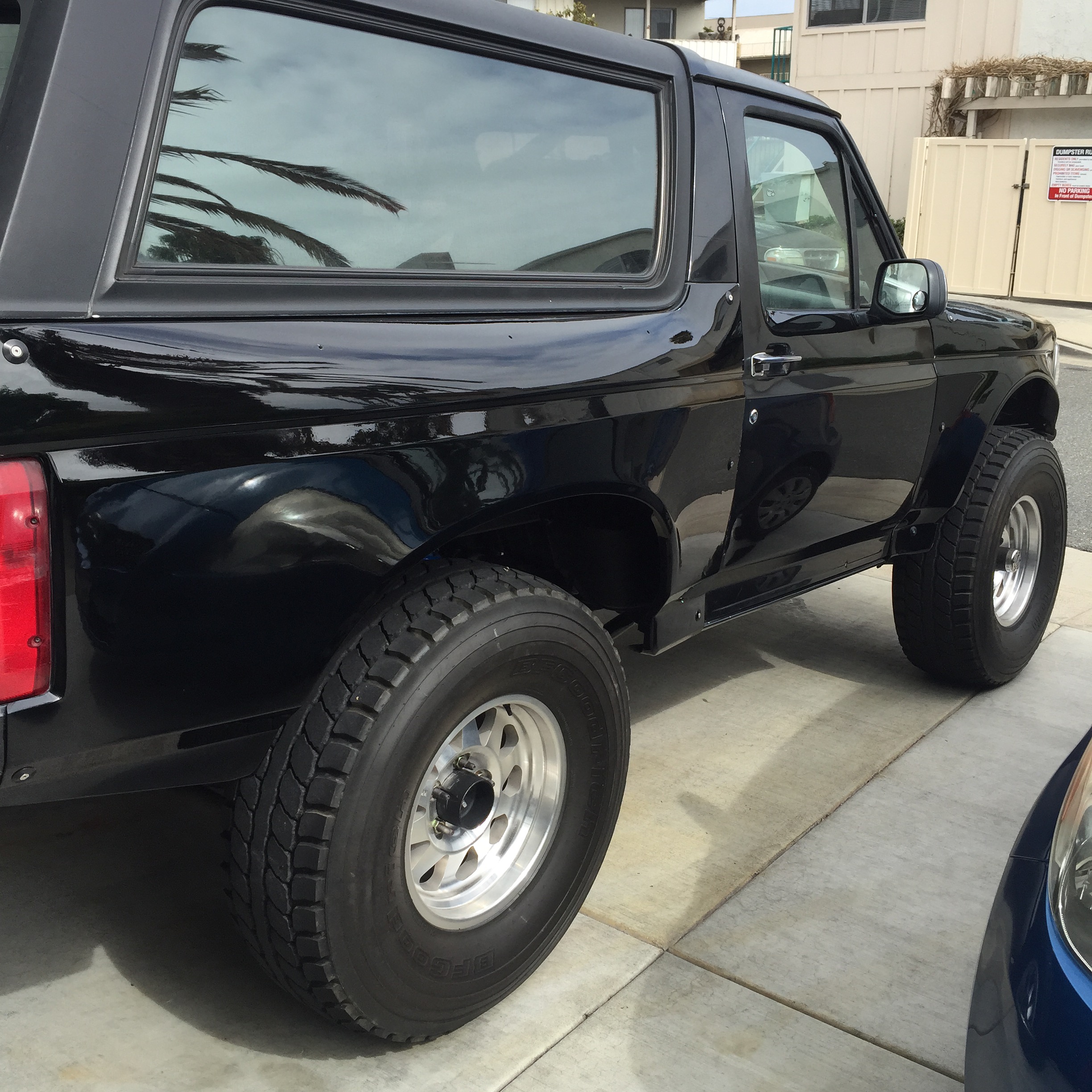

Finished up the front (for now) did big 5/8 wheel studs, limit straps, and single swing steering. All heims are 7/8 4130 FK, tie rods are 1.25" 4130 .375 wall drilled and tapped. Swinger and pitman arm tig welded 4130. Think I got all the buzz words in there! Image the truck handles soo much better with the new steering set up. The ratio is sped up a little bit, has much better ackerman and very minimal bumpsteer on the pass side. ImageImageImageImageImageImageImage
