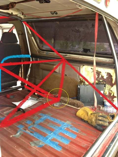

Thanks. Here's what I was thing for the rear seats.
Any feed back would be grate I don't want too do this agin
greaslife
Posts: 1128
Location: inland impire
Re: Josh aka greaslifes 86
Post by greaslife »
The yellow circle ? I don't know if I should bend this pice or use straight tube too another floor plate and attach it to my rear shock mount
Cage is looking great Josh..... Not sure what you mean about the yellow circle
Use a floor plate, and do another down bar to intersect the kicker tube from the back rear corner at the same intersection as the rear seat crossbar, just my .02 cents though.
Looking good Josh.
I agree with Robert on the floor plate for the yellow circle. If you can take it through the floor to the frame there too. There's a body mount close by under that silver plate in the floor. Could be a good place to tie in.
And one more thought/idea is for the B pillar tubes - ones you have drawn in blue behind the pass seat. I'd go from the curve/bend in that one up at an angle to the upper bend where it hits both the horizontal and diagonal down bars to the C pillar area.
I can draw this for you if what I wrote above doesn't make sense.
This won't add a ton of weight or a tube that will really be in the way any more than what you have drawn, but it will add some support for that B pillar corner in a hard roll.

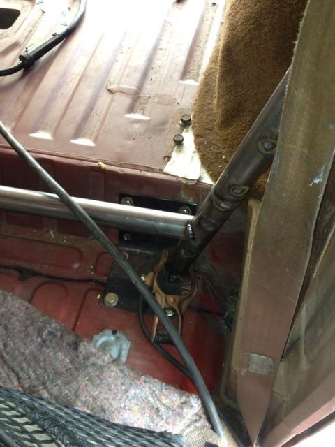

Here's the back all tacked up. I'm stoping here for now. That way I can come through the floor I will decide on that after my trip in two weeks
