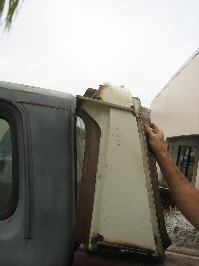

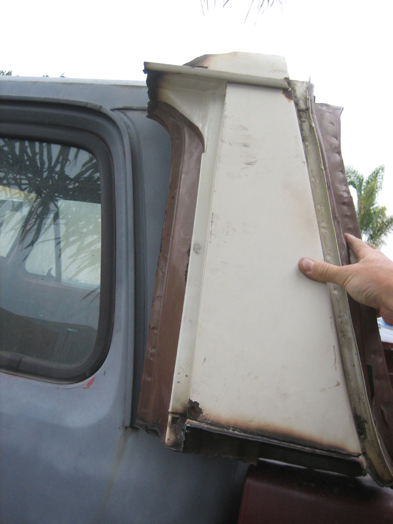

Maybe this will be a bit helpful. Not that you need the cab matchup like I do, but pics may be useful??
I was at the shop last night and I dawned on my I had a scrap pile of what used to be an '87 bronco since my buddy still hadn't taken the load to recycling yet. I cut a bit more off this bronco hunk and held it up to my supercab (still not cut well enough to fit right obviously, but this was a quick test). I was wondering if I might be able to get away with a 80+ donor for the bronco half since I can run a 778/79 tailgate on it and only this section above the bedside would show due to fiberglass bedsides. Looks as if I might need a 78/79 donor to make is a smooth blend from the supbercab to the shell connection part on the bronco. It looks almost doable from the side but you can see the cab angle difference in the 3rd pic.
