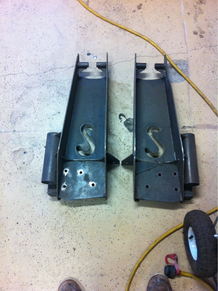

I also have the chance to pick up a set of spirit racing coilover towers with bump cans, all unwelded. Supposedly they mount a 14". It also comes with the engine crossover. What do you guys think?
Re: Nighthawk!
Spirit makes good parts!

do you guys think 650 is a good price. All unwelded. The ones pictured are just tacked. My buddy bought them last night.
Re: Nighthawk!
Yup. Welding is the easy part. Those are good towers.
birdco85
Posts: 837
Bronco Info: 95 5.8 MAF E4OD
Re: Nighthawk!
Post by birdco85 »
Thanks for the replies. Waiting for a call back on them.

And I finally got a hold of Jeremy at Spirit and he said he can make a set of towers by the end of November. So I'll probably hold out for those.
Everyone likes pics so here they are..
