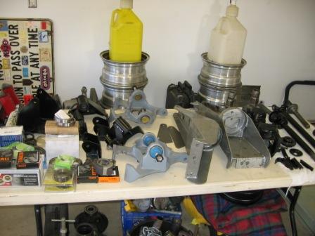

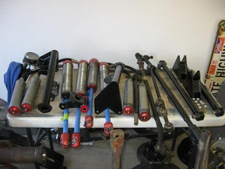

The parts are staged and its time for tear down.....
- IMG_3754.JPG (37.84 KiB) Viewed 1604 times
- IMG_3753.JPG (36.5 KiB) Viewed 1604 times
- more parts
- IMG_3752.JPG (30.6 KiB) Viewed 1604 times
- Parts
- IMG_3751.JPG (34.89 KiB) Viewed 1604 times

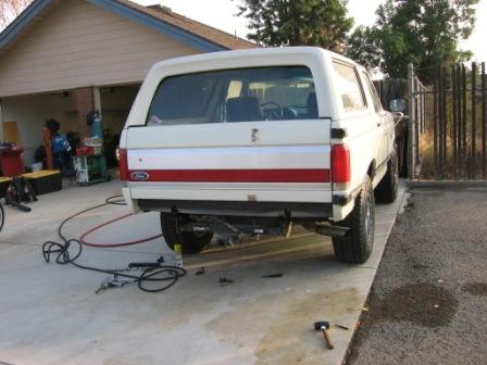

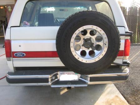

Rear with stock bumper and tire carrier before removal
- IMG_3756.JPG (33.03 KiB) Viewed 1604 times

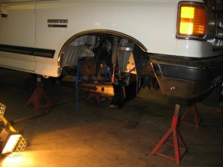

Re: 1987 XLT "Bob's White One"

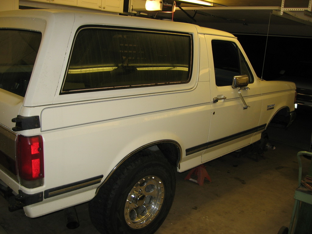

Tear down begins in the AM
- IMG_3763.JPG (70.08 KiB) Viewed 1601 times
- IMG_3768.JPG (185.94 KiB) Viewed 1601 times

I'm committed now!
- 87front7.JPG (183.9 KiB) Viewed 1537 times

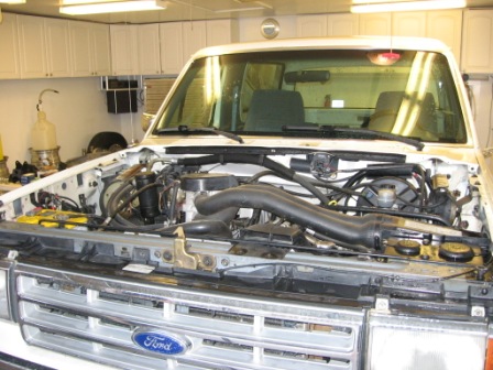

Another bare pic
- 87front2.JPG (38.92 KiB) Viewed 1536 times

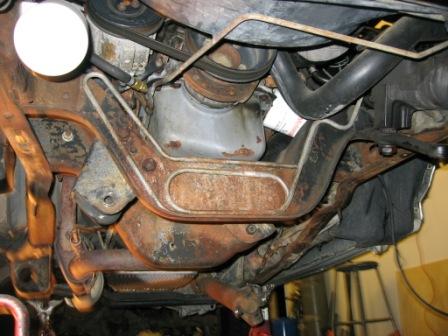

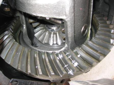

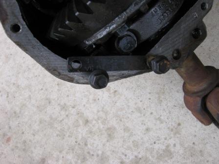

Big surpise came when I pulled the pumpkin and it was an OEM Dana factory limited slip 3.54 and it is very clean. This will be up for donation to the wounded warrior project. I am sure that it would be valuable to someone here or someone on FSB let's see how much it can bring for the good cause.
- IMG_3762.JPG (33.67 KiB) Viewed 1532 times
- IMG_3760.JPG (29.27 KiB) Viewed 1532 times
- IMG_3761.JPG (34.71 KiB) Viewed 1532 times

Bob, what a cool buildup man! This one will be subscribed to for sure. How many teardowns have you done and what travel #'s are you looking for front/rear? is 16/16" about right for you?

James, I'm poppin' my cherry on this one. I've built hot rods and harleys for years, but I have always liked the Broncos and a multi-purpose rig is very appealing. I don't really have a set travel target(14-16" is where it may net out) I just want the Bronco to be reliable/capable and fun to play with and a little forgiving if my self discipline goes away....

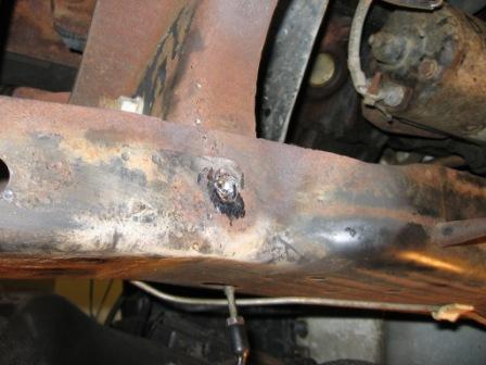

Oh and one more pic there just has to be one rivet that refuses to yield. I will use more aggresive removal means in the AM.

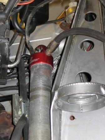

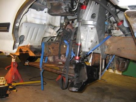

Mocked up one side get an idea for placement and preparing for drilling and fasteners. Question now is shock mount orientation. The location will be behind the bucket with the lower mount positioned on top of the radius arm to keep the shock body positioned 1/2"-3/4" from the rear of the bucket body and frame surface.
Is it best to set mounts at full extension, compression or an estimated ride height????? and is my planned clearance satisfactory?
- 87passm1.jpg (26.81 KiB) Viewed 1500 times
- passbk1.jpg (33.9 KiB) Viewed 1500 times
- passbk2.jpg (35.96 KiB) Viewed 1500 times
What is your reasoning for putting the shock behind the bucket?
Most with single shock setups run it in front. I don't have enough knowledge to tell you why, but i believe it has more leverage that way.
Just curious.
Just curious.
