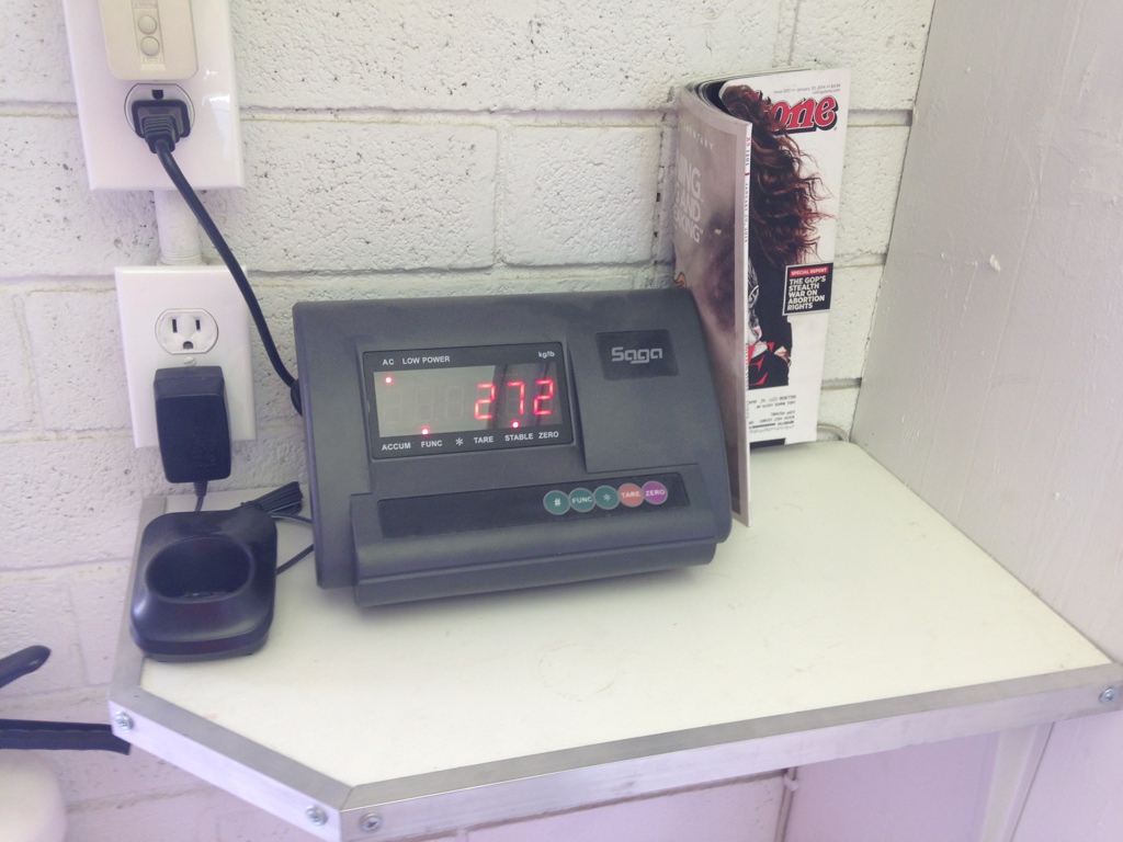

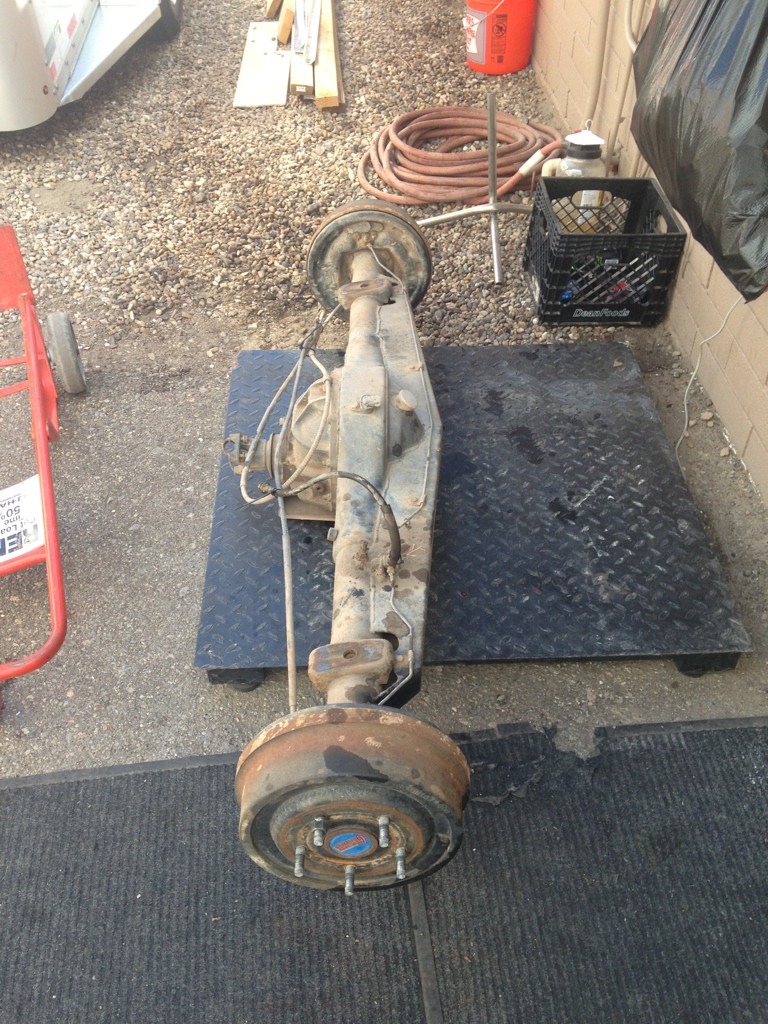

For the record, 9", nodular Yukon case, drum brakes, Giant truss, fluid, factory housing, 4.56 gears, 272 pounds.
I will weight the Sterling once it's welded up and assembled. I'm guessing in the 300 pound range.
