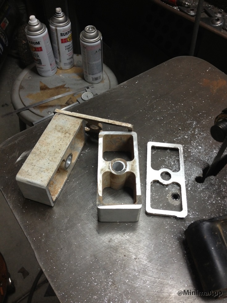

There adapter shackles so to speak, they go from a 3.5" hanger to a 2.5 spring.

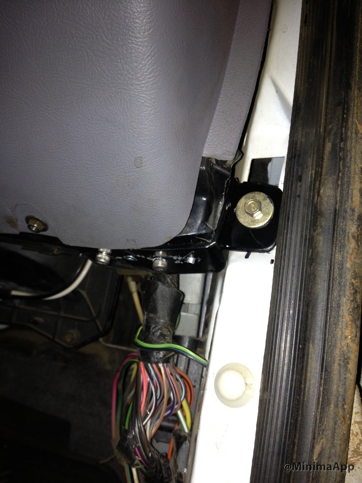

Tonight's home made goody. Dash corner brace.
Re: RMC's el hefe build.
Reinforcing before the dash is falling of... You're doing it backwards!
Naw it's pretty close to that now lol, I had to do something while the paint on my shackles dries. I'm going to start on the door switch next, then another coat. I have to wait till tomarrow morning to install the shackles cause I'm out of 5/8-3/4 bushing tubing. With any luck the shocks n bumps will be mounted by the end of the morning. Disassembling the leaf packs as well tonight.

Made the dash solid, pop rivets pulled out so I had to through bolt it. I like to call it the hybrid effect both pop rivets and bolts.

Worked on shackle fitment, and leaf pack removal and disassembly. I have a few sets of lift blocks sitting around so I measured up the stack and cut a set of blocks down to simulate the removed leafs. I also through drilled them so i can ensure no axel spring pad locating pin issues. Tomarrow on to full tuck, carpet removal and bedcage time!

Thanks for showing pics of the dash bracket placement:) Nice work!

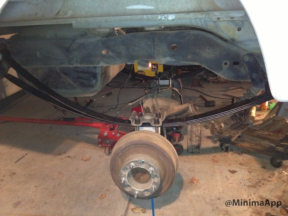

Spacers installed.
Leaf packs ready for cycleing.
Tuck is not as high as I'd hoped but ill make due.
Looks like the new shackles could have been 3/8 of an inch longer also. I may make another set. I don't think the tuck position will change by enough to mess with it though but I may get more motivated later. It's been a long day walking wise, went to the fair and watched demolition derby with the fam. It was cool as always. I'm sure the desert run would have been fun too, I also heard the bee hive was at Elsinore also today. So demo derby will have to fill the racing bug for today.
