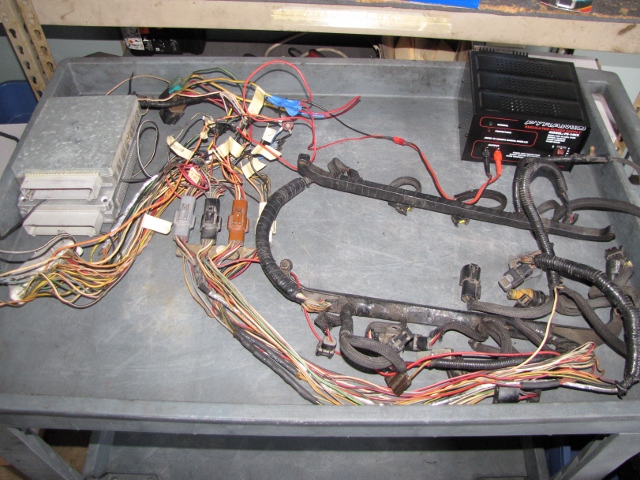

Update: The Bronco was on the chopping block once again but got another stay of execution. In light of said stay, I decided to get back on the EFI conversion.
I've been RACKING my brain and busting my ass trying to diagnose a strange issue with the EFI conversion. From the first time I started the engine with EFI, it just didn't seem right but I just couldn't figure out what was happening. I've spent an easy 25+ hours on this... studying electrical diagrams, tracing,testing and modifying circuits, blah, blah, blah. I just knew the problem had to be a self-induced wiring mistake or oversight. Yesterday I decided to clean up one of the other EFI harnesses I had & prep it for testing and eventually to replace the harness I'd already installed in the Bronco.
I thought I'd made a mistake but I was mistaken. After all that nonsense, it turns out I have a bad ECM!!! Ahhhhh! The harness is half torn out of the Bronco, opened all up and laying all over the place. The bad news is, I'll have to pull the harness out of the truck to clean it up again. The good news is, it functions as intended!!! What a freakin' mess!
On a related note, I decided to start building various test leads to use with my 12v power supply. Rather than fighting a bunch of wires twisted together, accidentally short-circuiting components, I can now plug and play. I might also build some switched test leads... should come in handy the next time I need to tear down the Bronco's EFI harness!
I know you guys are all picture whores, so here's a lame shot for you.

Yeah, I'm happy to finally have it diagnosed. The major hurdle is there is no way of testing the ECM. We replaced the ECM in an 89 F350 with a 460 last week and we happened to still have the core at work. The pin-out for the fuel pump relay (one of the areas I was having issues) is identical to the system I'm using in the Bronco, so I was able to use it to condemn my ECM. I also borrowed another 5.8L ECM to verify my diagnosis. It's verified and the truck starts and runs like it never had with the ECM I originally started with... man, is it nice to have that behind me. Now I can actually start to make some progress rather than beat my head against a wall for hours on end! The kicker is I suspected the ECM a long time ago but I just "knew" I'd wired something wrong. When will I learn that I just don't make mistakes!? Ha!!!
