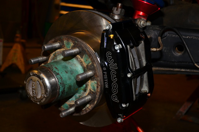

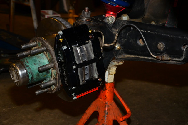

I spent the most greater part of the day in the shop and I got my new brakes installed. And the best part... they work GREAT! I'm not happy with the brake lines so I'm going to reroute them tomorrow.

Saw the beast this morning, brakes are sexy, and the dual rear 3.0s are.......HUGE!
Re: BajaF250
Love the minty green "patina" on the hubs!

Its almost like a cool shade of oxidized copper like the Statue of Liberty.
