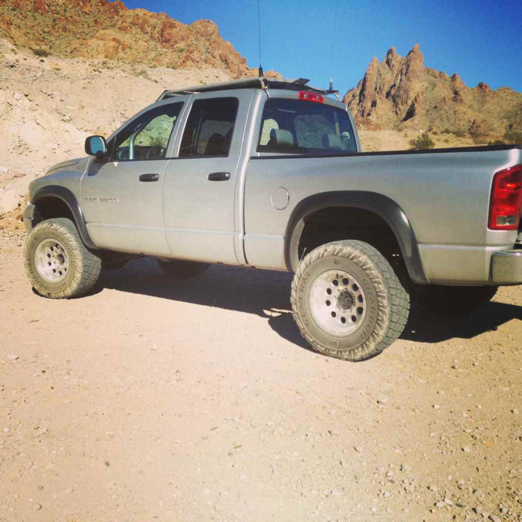

Besides everything that is done to this truck Philo, is there a reason you chose a truck with the 5.9 vs the 6.7?
Re: The Trophy Diesel...
robertcrav wrote:Besides everything that is done to this truck Philo, is there a reason you chose a truck with the 5.9 vs the 6.7?
I didn't want to deal with the delete kit, insurance and registration is cheaper, parts are easier to come by, and finding a non megacab in later years is difficult.
I also have way more experience with 03-06 trucks, back when they were new I did a lot of work on them for the local dealerships. The only plus I see on the newer trucks is a better trans and EFI live.

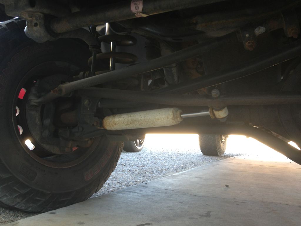

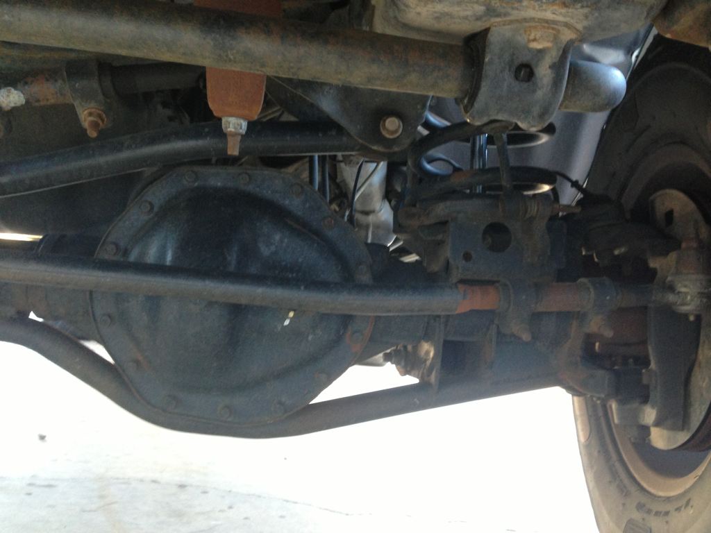

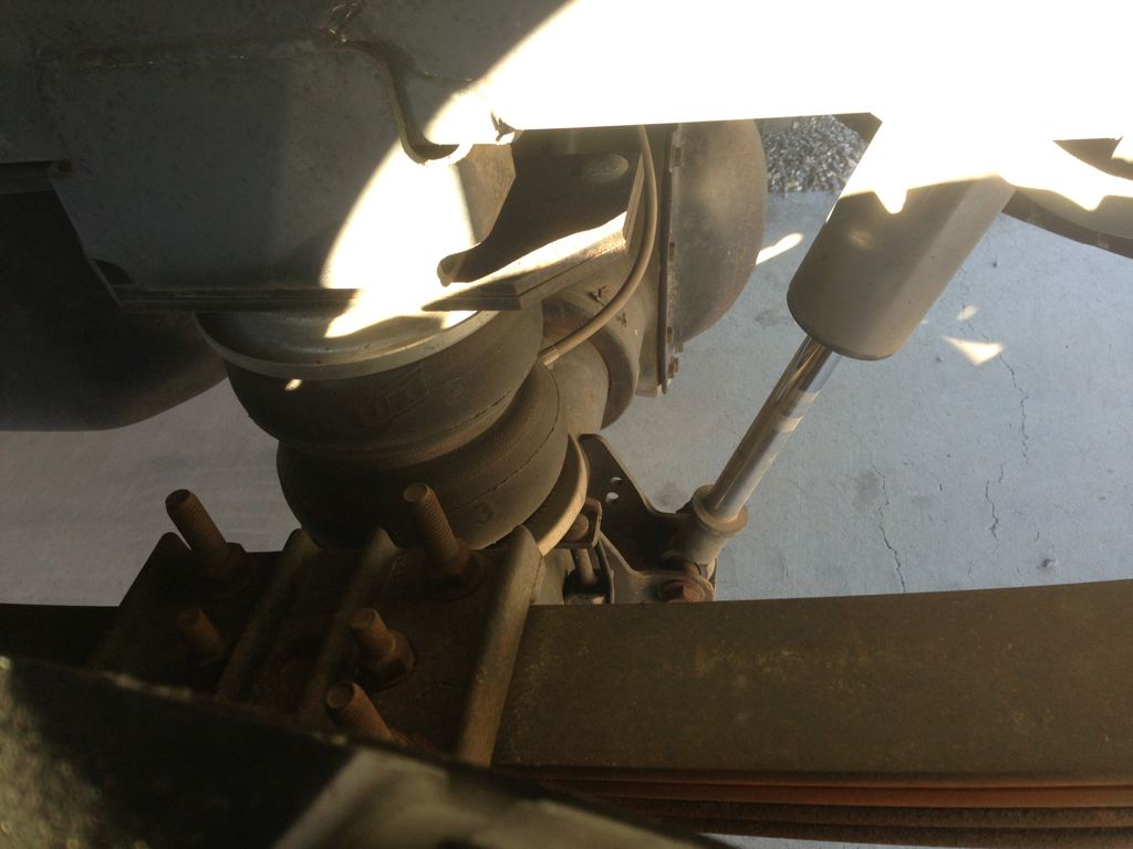

The rear leaf pack is probably a lot of my ride problem, looks like the factory main leaf and secondary leaf with an aftermarket two leaf mini pack that has a different arch to it. Thinking about ditching the air bags as it won't ever tow more than a 8-9K loaded car trailer.
Rear axle needs a truss, front axle needs the 'C's welded/gusseted.

Very nice buy bro, I'm with you on ditching the airbags and old leafs, I think a decent set of deavers will change it up alot out back. I'm curious if the shock oil is dark too.

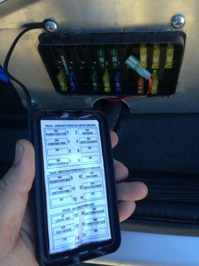

I was all ready to tear into the wiring to make the GPS and radios work with the ignition off, luckily the first person to wire this did it correctly and the second only did that horrible splice for the air bag system(soon to be removed!). Only had to move two fuses!

But did you get the excel/word template so you can re-print the fuse box diagram? :D :twisted: :lol: .... like this thing more and more
robertcrav wrote:But did you get the excel/word template so you can re-print the fuse box diagram? :D :twisted: :lol: .... like this thing more and more
No, I did not. I use a Dymo printer so I doubt I would be able to use it...
