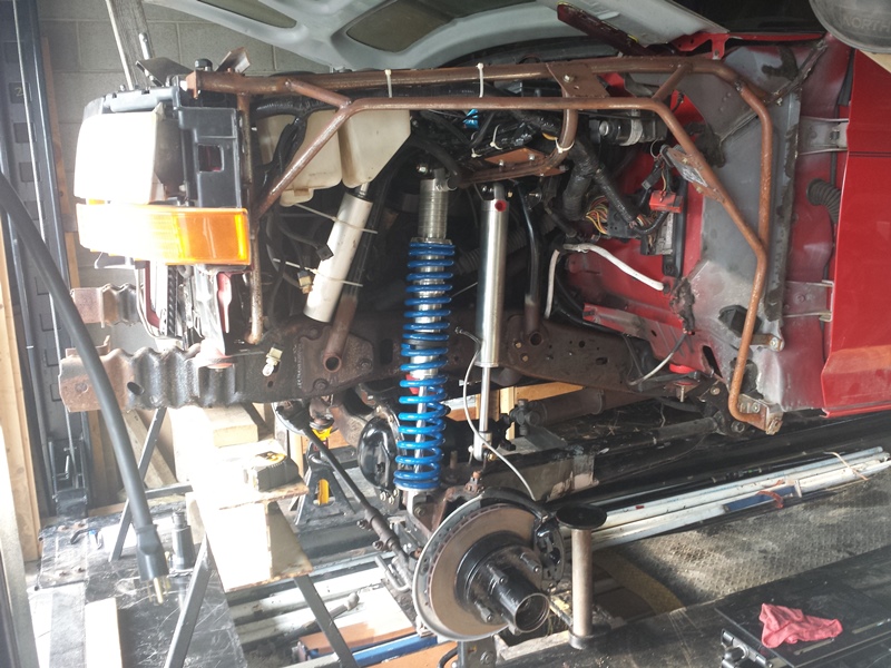

Not sure about "nice" but here is what I came up with so far. Autofab tube fender mount to Solo engine cage. Still working on the details.

Where did you pass bolts thru the fuse box?

I did a quick edit on his pic.the red arrow shows the nuts from the fusebox studs
Re: Fuse panel under hood bracket
Chopped and cropped but here's what I did.

my fuse box doesn't have studs. Its an odd shaped piece of plastic. Did you keep the metal tray it was clipped to and that's where the studs came from?
I think so, I'll have to look.
There is a metal tray that holds the fuse box.
