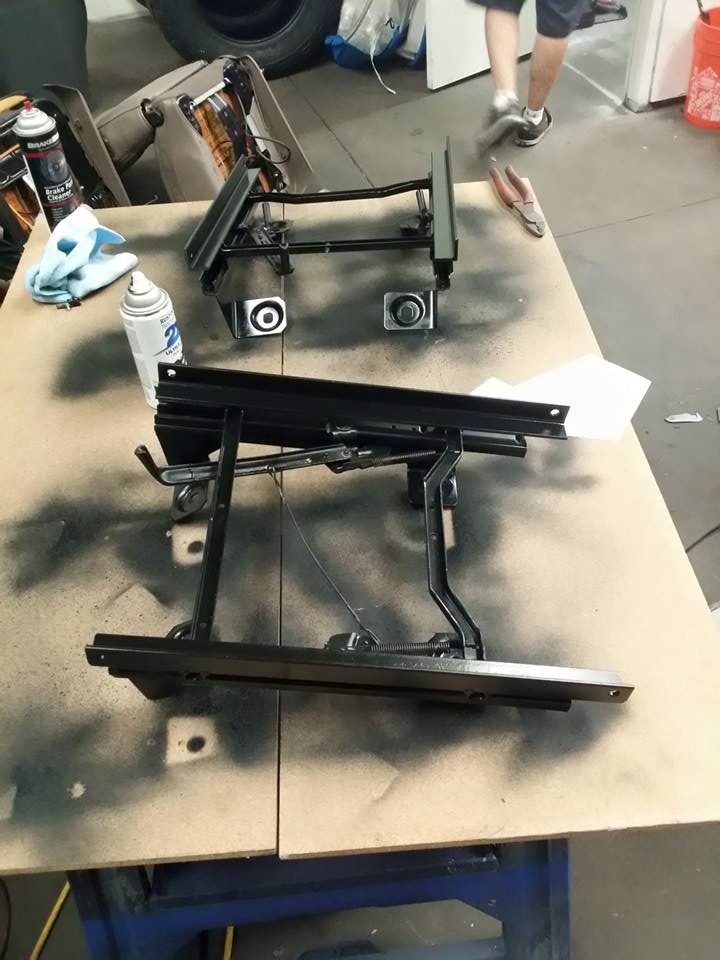

I have done a few sets for customers. It is easy to do the front sliders and takes about 4 hours to cut down and clean up and fab. We also have a tubing rear seat frame that we cad up that uses all factory seat mounts to bolt in either 1 bucket, 2 buckets, or bucket bench depending on customer request. Its all easy stuff just time consuming. The first set up we did cost about $100 in materials. Hers some pics I hope it helps.
Suspension seat on stock slider. Who's done it?
The fronts seem easy enough but may have to pay someone to do the rear frame. I like this one southwest built because it picks up all the factory bolt holes. I'll try first and see how it comes out. How much is your rear bench frame Hollander? PM if you want.

Ya our frame you can place seats at any width. This customer chose packaged together so you are not staring at the back of the driver and passenger heads as well as placement of tool bags to the side. Depending on what you want with harness mounts and stuff we are probably looking around $350- $500 for the rear and $250 for the front and I need you stock sliders after you receive the Hollander Motorsports modified ones. Honestly the fronts are easy so if you have a good welder to glue it all together than it is worth it. But cutting up cleaning, and welding then throw a rattle can job on it and it will look great. Like I said we set it up to run any configuration of rear seats and it will still hold a 37" tire flat in the rear. And they are completely bolt in so no mods required.

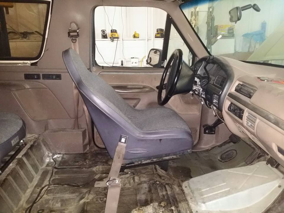

Did anyone else only use the bottom part of the front sliders, like Hollander's pics? Does using the whole assembly make the seats too high?
Posts: 2337
Re: Suspension seat on stock slider. Who's done it?
No not too high but there's no reason to weld those brackets to the seat frames IMO.
Agreed with Vintage on the no need to weld. As with most stuff I build my angle iron brackets were bolt on. It only took maybe 10-20 more minutes, if that and I just HATE having to cut & grind off work (usually some one else's that I'm fixing).
Anyway, I've done both ways with the slider (run both or just the lower). You just lose a bit of travel for the slider without the upper. Not a huge deal to many, unless you are 6'-6" and your wife/girlfriend is 4'-11" and you both drive the truck...
Height isn't a major issue with both sliders for an "average" height guy like me at 5'-10", so I don't think you'll have an issue going with either the single or both Ryan.
In the front the race type buckets do look odd/tiny to me in comparison to the stock seats (see Hollander's pics above), but they sure are comfy.
