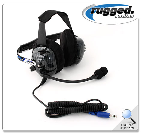

cs_drums wrote:I found these are the best for cutting down the noise....Image
Have to respectively disagree. I've found these to be the best for cutting down the noise.....and I just put 1,200 miles on them to prove it.
Rugged Radios H42-ULT-MD.jpg (31.77 KiB) Viewed 568 times
Just kidding. You're right.....I was not a believer until this last trip. Thank God for an intercom.

Are those the noise canceling ones?
1Hondalover
Posts: 819
Location: Santa Clarita
Re: Dynomat, peel n seal , and b-quiet
Post by 1Hondalover »
Yes Sir.
Features:
• Carbon Fiber style finish
• Dynamic noise cancelling mic
• Hard wired coil cord
• Molded Offroad plug
• Large comfortable gel ear seals
• Cloth ear covers
• Easy to use volume control
