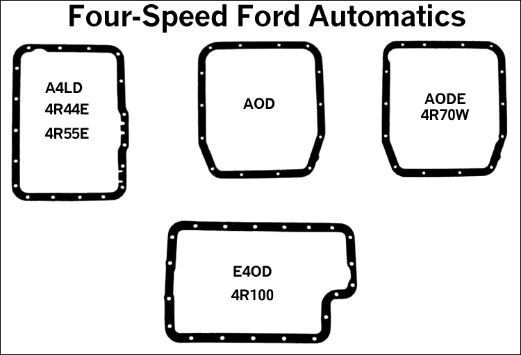

I am getting ready to order a deep pan for my 1994 5.0 bronco. I thought I had a E4OD but in JBG they have up to a 96 with a AODE. Can someone confirm what i have or tell me the difference. Maybe one has more pan bolts than another. By the way I have been doing a good amount work to this thing so it should be ready soon!!

If you go to the JBG site or any others that sell trans parts, you can look at the shape of the gasket for that trans or the amount of bolts it uses and compare it to yours. You can usually find it in the Chiltons or Haynes manuels too.

This should help a bit. Just compare it to your trans oil pan and you'll be able to determine it.

Thanks for the picture. That is what I needed. I feel the 3 extra quarts of fluid is a good thing. I already have a big cooler and my trans does not run too hot but the cooler the better. more fluid=cooler temps.
E4OD it is!!
