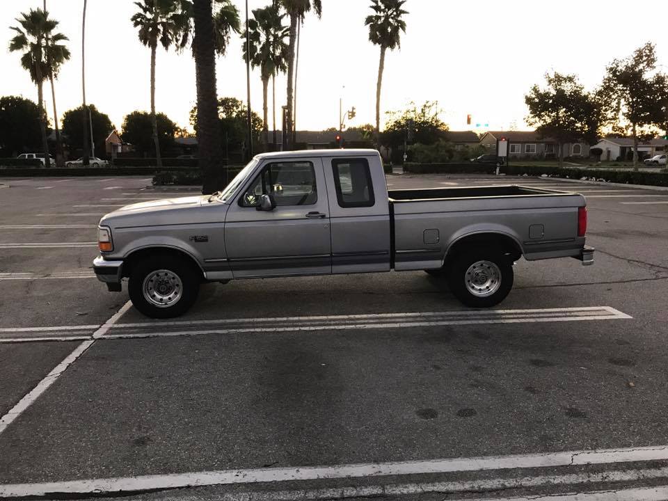

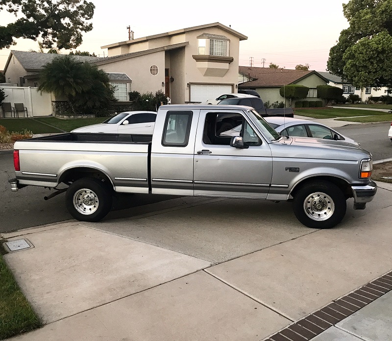

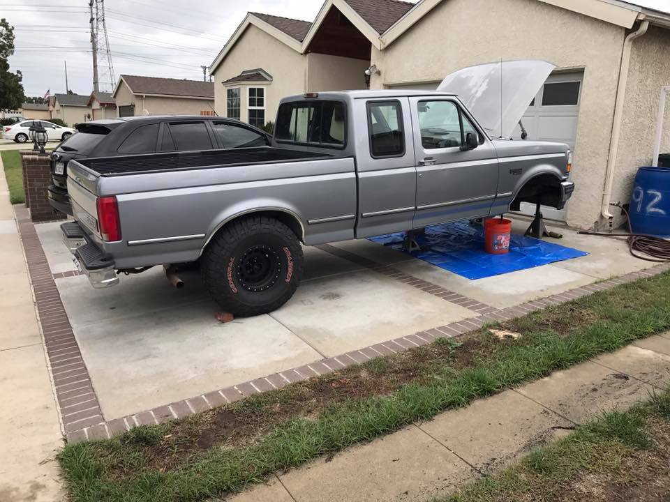

A lot of you guys already know, but I picked up a super clean F-150 a few weeks ago.
1995 302/Auto with 184,000 miles. The truck still passes smog and the AC blows ice cold. I have all the stuff to convert it to 4x4 which I will probably do after desert season is over. As of right now shes on track to make me all over Baja for the 50th 1000 next week.

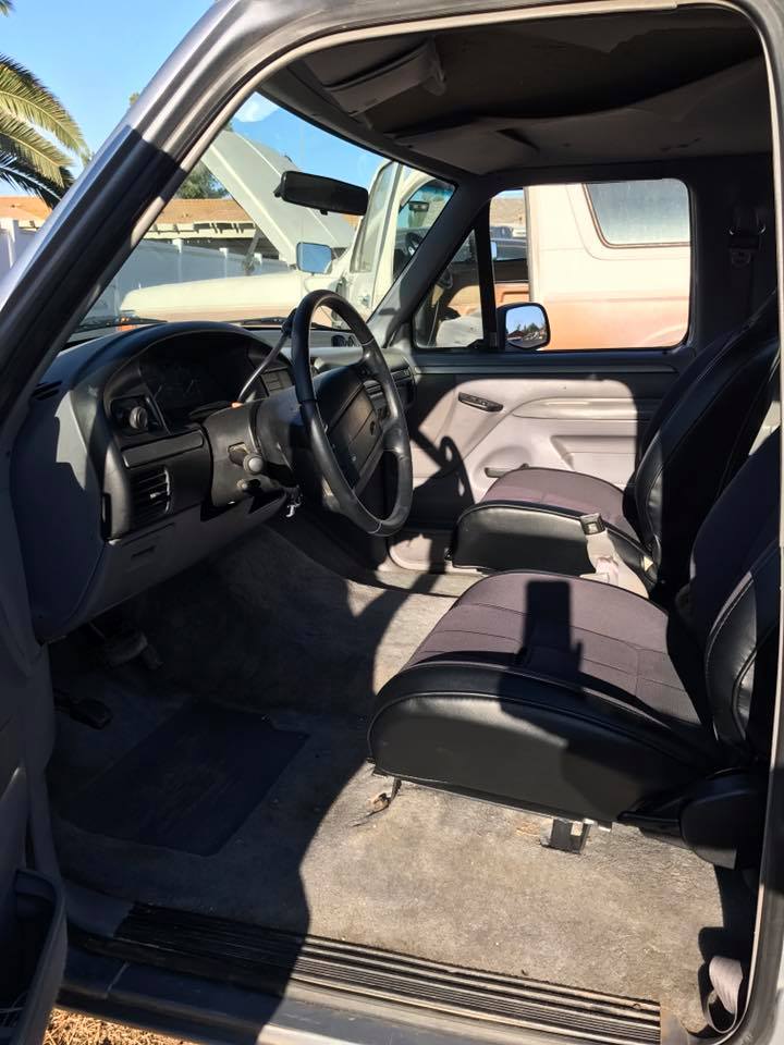

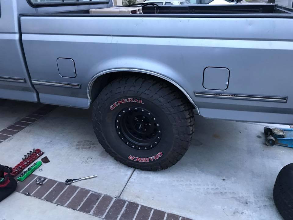

Went ahead and swapped my Corbeaus in though because i picked up an expedition console I plan on swapping on for my race radio and GPS (not going to have time to get it done before the 1000 though.

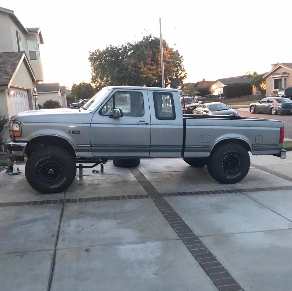

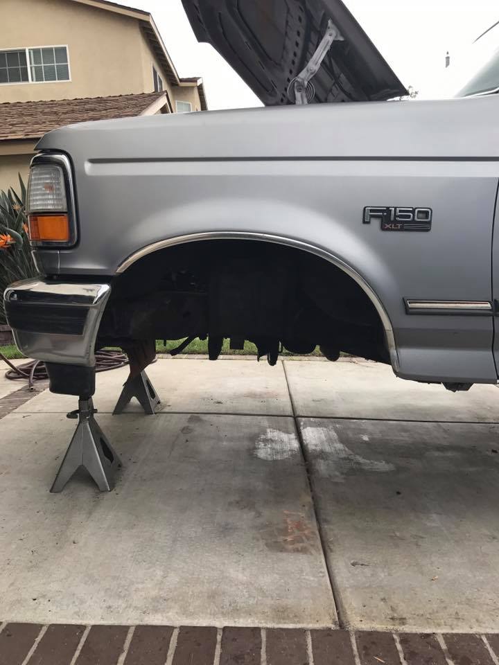

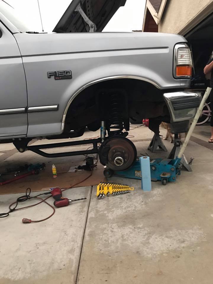

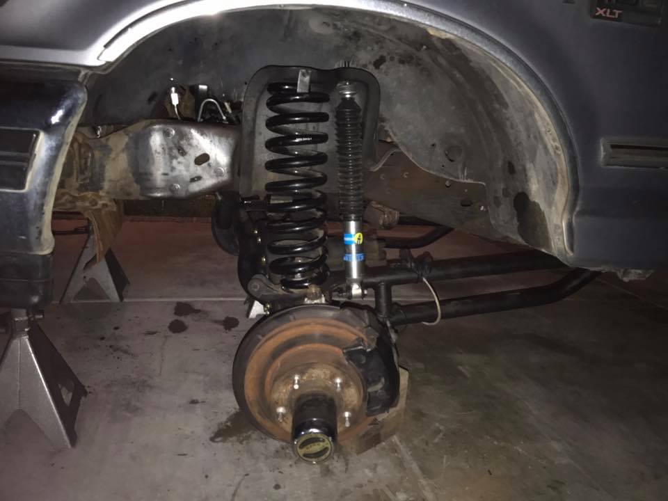

Decided to throw my ttb stuff under this truck with some 5100s and deavers so I can drive this thing to mexico next week.
