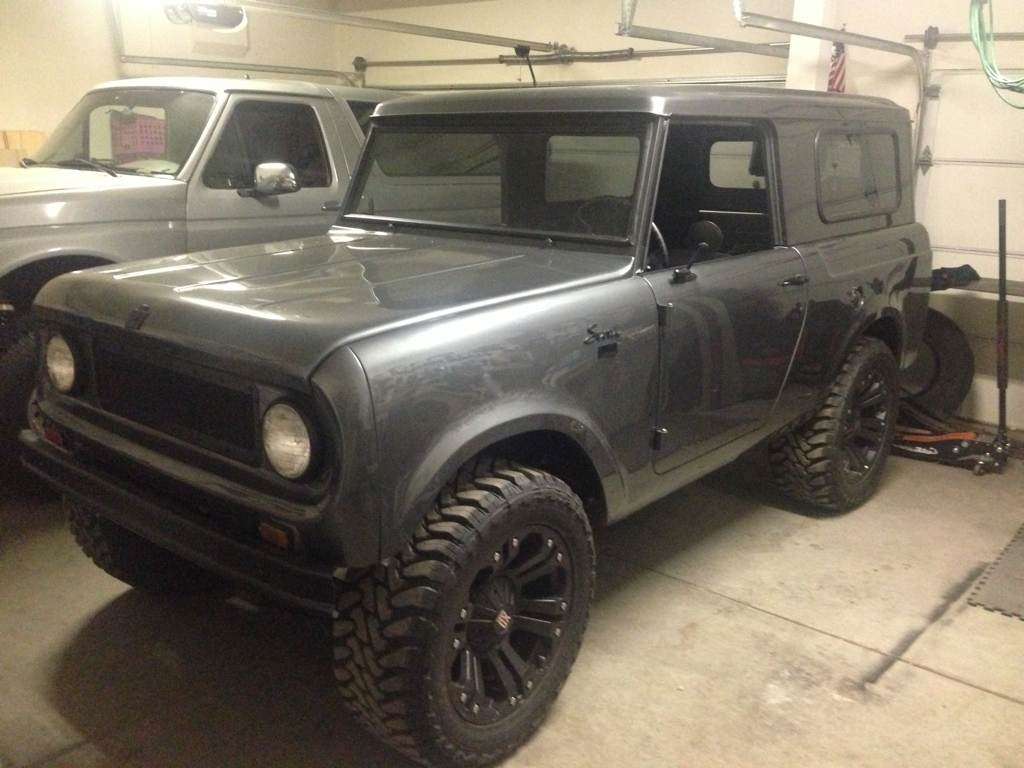

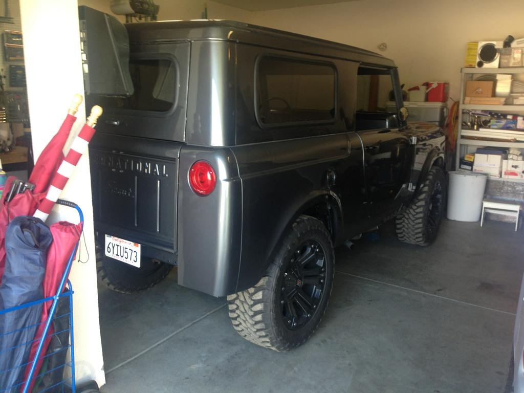

You had me on the fence about the peel and seal with your first review. I've been doing a lot of reading and was seriously thinking about going with second skin but now I think it's safe to finally step up and buy the P&S. The scout looks nice btw.
Posts: 6026
Re: Jose's 94
Considering 90% of scouts are bondo and primer or faded old paint that thing looks great. Refreshing to see one restored and modernized.
