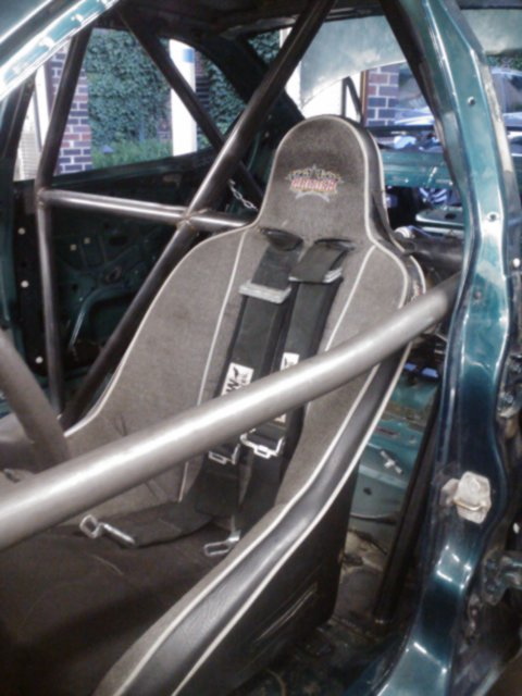

I didn't work on the bronco....but I caged this Dodge neon for beater x racing....

Then I didn't work on the Bronco some more, but I caged this BMW so we could go chump car racing....

Are both of those cars your / shop cars or were they customer cars you were doing?

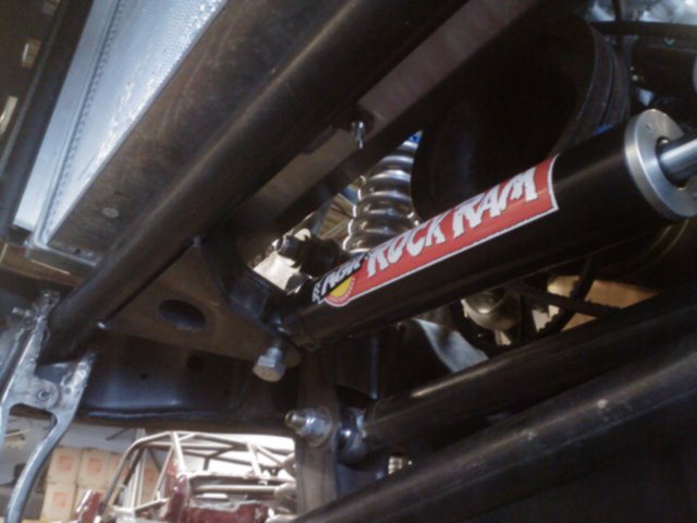

I decided to add a ram to the steering. I have all the fittings and hose, just need to put the lines together.
STEERING RAM.jpg (105.79 KiB) Viewed 1286 times

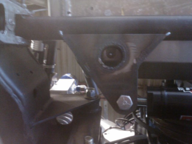

Chassis side mount.

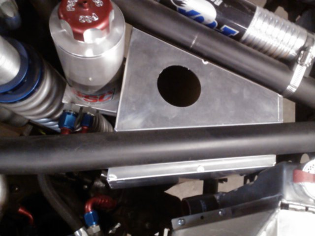

Got lucky on this hole placement, I can access my fan shroud bolt through it!! :lol:

ChaseTruck754 wrote:Are both of those cars your / shop cars or were they customer cars you were doing?
The Neon is for my buddy's kid. (The owner of the class 10 team I co-drive/chase with) And the BMW is his that we are going to race the Chump Car Series with.

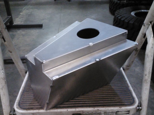

Started on a radiator overflow tank while I'm waiting for some more of my plumbing stuff. It's all .080 aluminum. I know you can buy them for like 50-100 bucks, but then it wouldn't fit where I want it or take an extra long time to get done.
rad overflow2.jpg (85.18 KiB) Viewed 1192 times
rad overflow.jpg (85.12 KiB) Viewed 1192 times
The last pic makes it look like it gets into the steering reservior due to the angle of the pic. It's close, but I have about 1/4"-1/2" clearance.

That tank is sweet! I would like to see how you mount it.
Thanks for the compliment on the tank, it's complete, I just have to mount it now. I have a few tabs welded on the front and back that bolt to chassis tabs. I haven't been able to give this thing much love lately as it has been a pretty busy summer, (moved to a new house, designed new suspension for the 10 car....) but I hope to be able to spend some time on it in the next couple weeks!

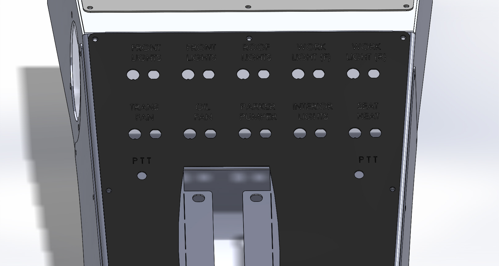

I have been working on my wiring diagram and collecting parts to start wiring it. Here is a center console I designed for it. It will all be 14 ga sheetmetal powdercoated white to match the truck, and the top plates will be black aluminum with the switch naming laser engraved in it. Just need to cut it out and put it together now. Here's some "progress" to look at.
Posts: 4619
That looks awesome! How many switches are you running?
Posts: 6026
Very nice! I dig it.
Thanks! I'll have a few switches on the dash too, but I should probably end up with about 12-14 switches? I am still working on finalizing my wiring diagrams so that may change a bit. The two holes side by side are for a switch and a circuit breaker. I wanted to put the breaker and switch side by side to keep wiring short/simple, and to eliminate the need for a stand alone breaker panel.

Here is what I have so far if any one has suggestions/comments/real life experiance. On the dash I have ignition, start, defrost, and wipers.
