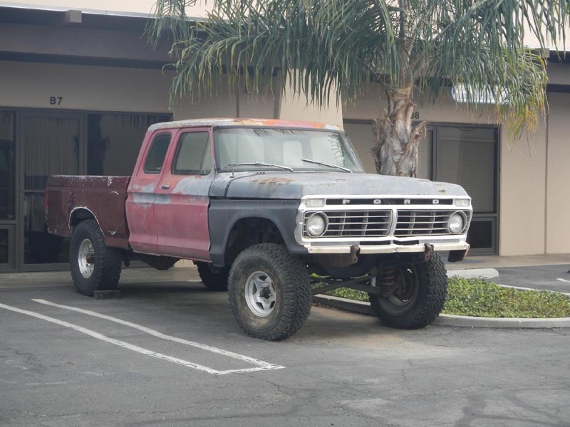

oh, and if you are going to go 4" it might be worth while to just keep your eyes on CL and some desert classifieds for a used autofab kit. For some inspiration, here's a 4" autofab kit with 35's. Stock rear.
