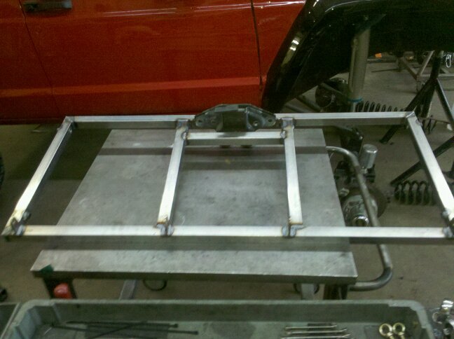

Rear seat mount:
bracket uses factory quick remove hardware slightly beefed up.
Front uses bossed (factory bracket and frame)quick release pin with ball detent.
Rear uses factory hinge.
Two wide suspension seats with room in the middle for an AO 12 pack softie.
Now I just need to get the front seats budgeted in.

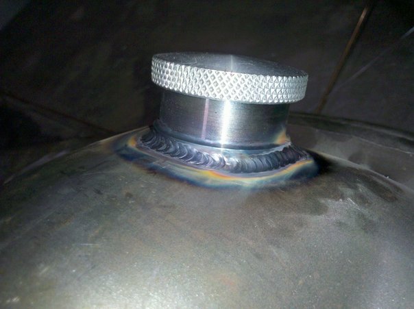

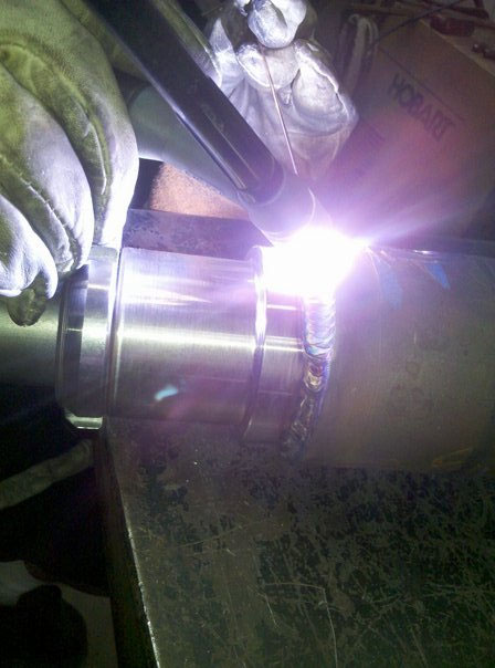

A couple housing shots...
- Snout on 2nd pass
- housing.jpg (69.16 KiB) Viewed 1784 times
- Fill Plug
- cap.jpg (44.06 KiB) Viewed 1784 times

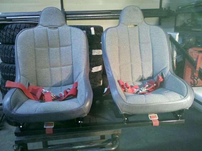

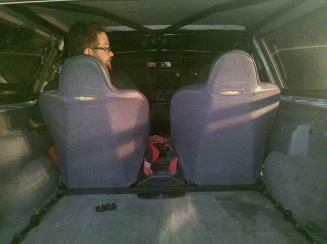

We got the seat mount finished this evening...bitchen and solid as shit. Skyler at 210 and me at 280 dont even touch elbows. Head room is good to 6'3"
Seatbelt bar coming this week.
