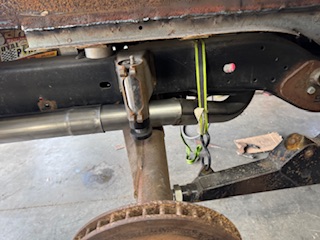

Picked up my trailing arms last weekend Thursday I cleaned my barn and moved the bronco to the middle of the floor. I also started mocking up my link brackets on the frame side. This location should get me to about 112” wheel base.Image

Well been picking away at this some lately.
I removed all the rear suspension still need to cut off the front hangers but the rear are goneImage
Cut a hole to figure out shock placement. I still need to buy a bypass yet.
I will end up notching the frame to get everything up higher but been waiting for weather to get colder so I could start working on this again.
