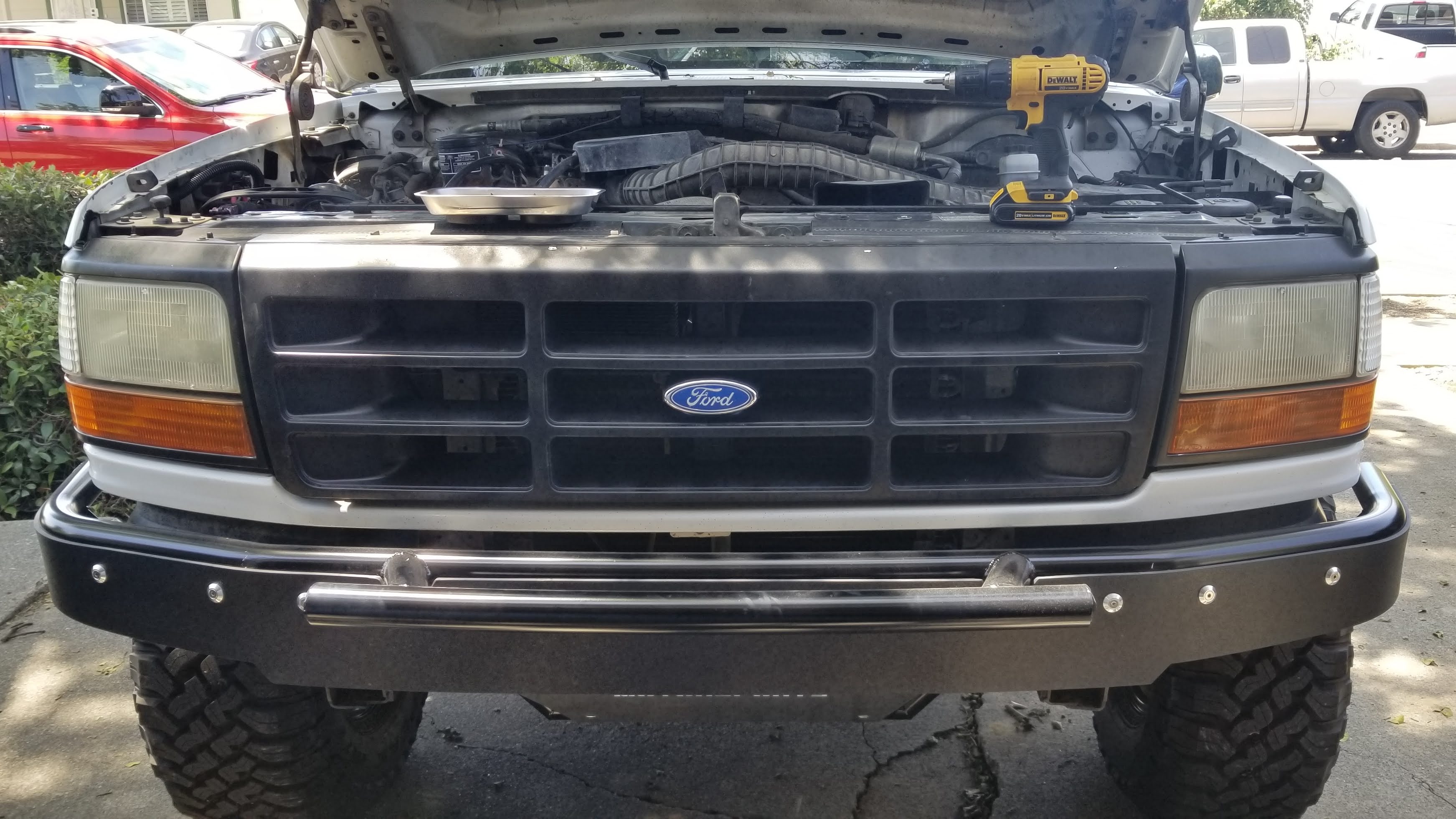

Got the tires mounted and wheels on. Had to replace the driver side window motor and got to put in the CPP driver side switch panel fix plate (already had the passenger side one on). Most importantly I got the Solo front bumper. Got it painted semi gloss black and mounted up on Friday. That along with the wheels totally changes the image of the bronco.

Also got the front end swapped out. The factory grille and headlight surrounds were plastidiped and the headlights were very faded. Got a new grille and painted it black and got a set of cheap black lights for now. I used silicone sealant around the edges so hopefully they wont leak and get fogged up like most cheap lights do. Eventually it will get a full set of HIDs but this looks a ton better until then.

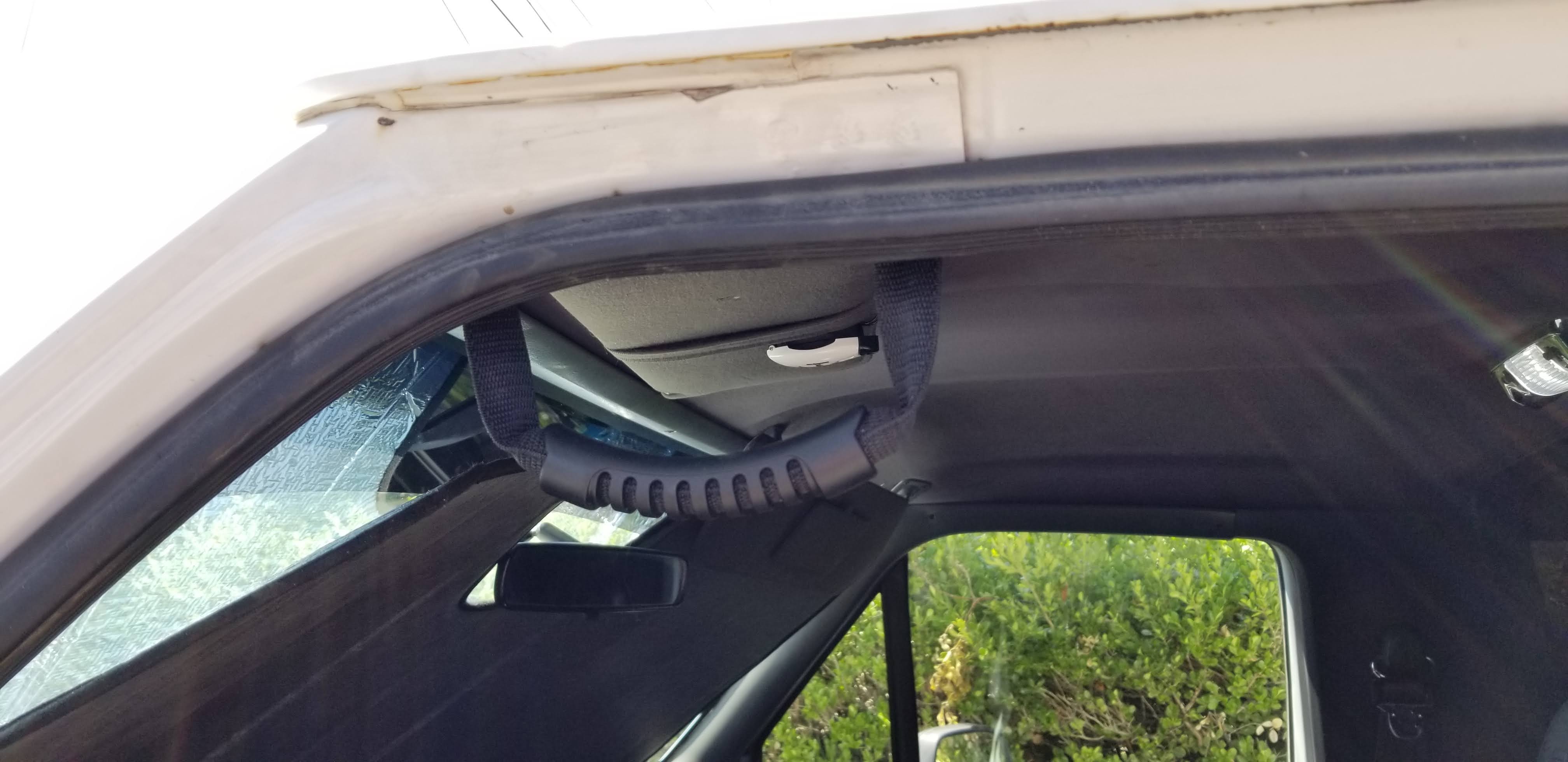

When I purchased it it had cheap aftermarket steps on it that were quickly removed. Now with the lift and bigger tires its hard to get into, especially for my gf on the passenger side. Eventually I will get some sliders made and installed with a step but for now I chose to add some handles.
These are just generic Jeep grab handles I got from 4WP. I drilled the holes in the roof where it had enough room and put nutserts in. I trimmed the a pillar covers so it goes around them and looks ok. They support my weight and are a big help and double as o S*** handles when off roading.
