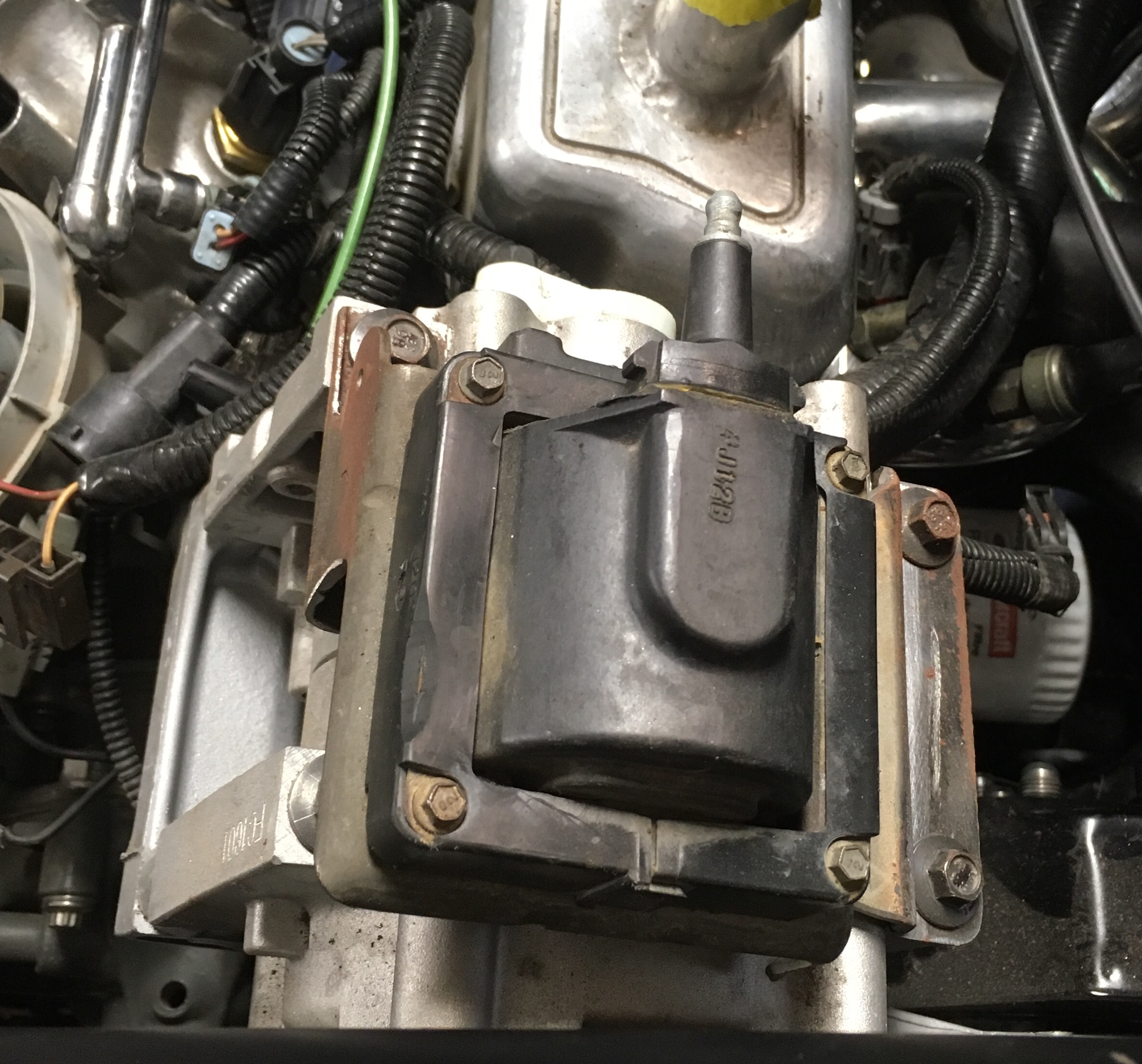

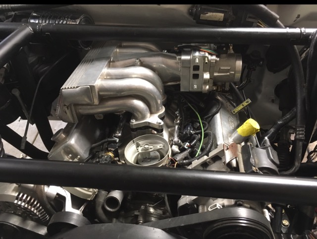

Finally got the intake bolted down, all the plumbing for the Lightning upper sorted out and oil in the crankcase. Just need to get the hoses/lines for the trans installed so I can test fire the engine without making a huge mess! So close I can taste the exhaust!!
Here's also a pic of the stock coil bracket I massaged and made to fit on the a/c bracket- hopefully a tad cooler than in the back of the engine

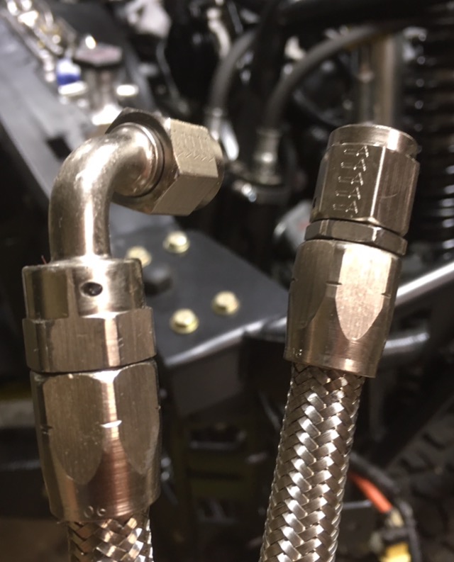

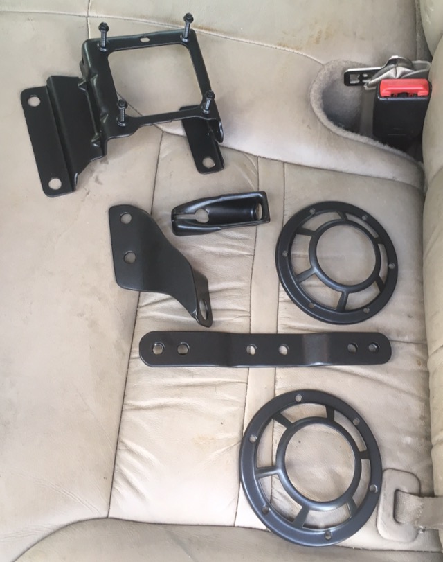

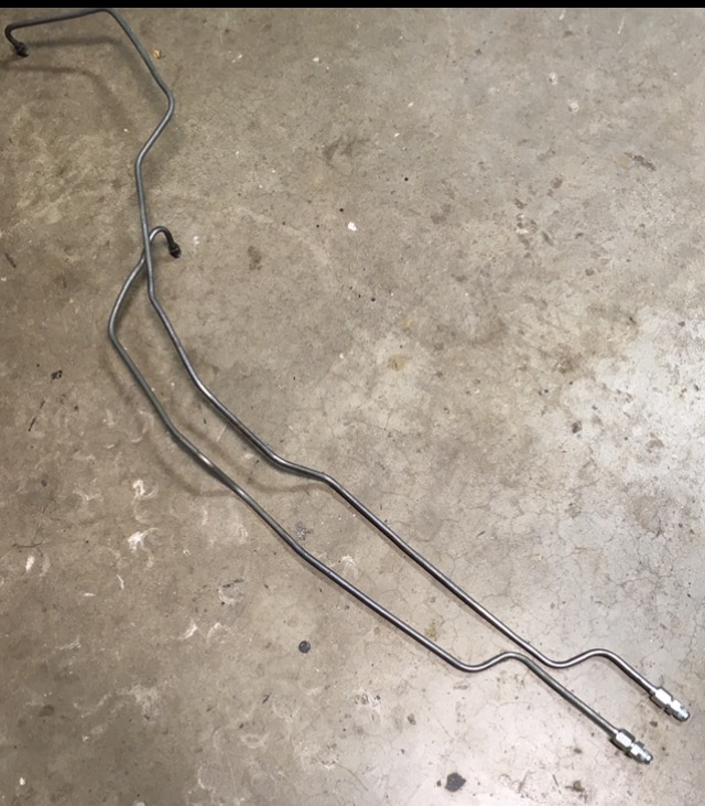

Got some parts I fabbed up powdercoated and some cool guy Hella Sharptone horns. Modified the factory trans lines to accept -6an lines for a big cooler up front (more on that later)....

Re: 95 F150 - Project Marilyn
Compression fittings or some such for those AN fittings to the stock lines?
- Posts: 2338
- Bronco Info: Bronco List:
- Location: Phoenix, AZ
While the trans lines have almost no pressure that really matters I'm just not a fan of compression fittings after seeing them used in oilfield treater applications. The factory lines are 5/16" so you 37* flare and use a -5an to -6an male/male adapter- never see an issue doing it this way.

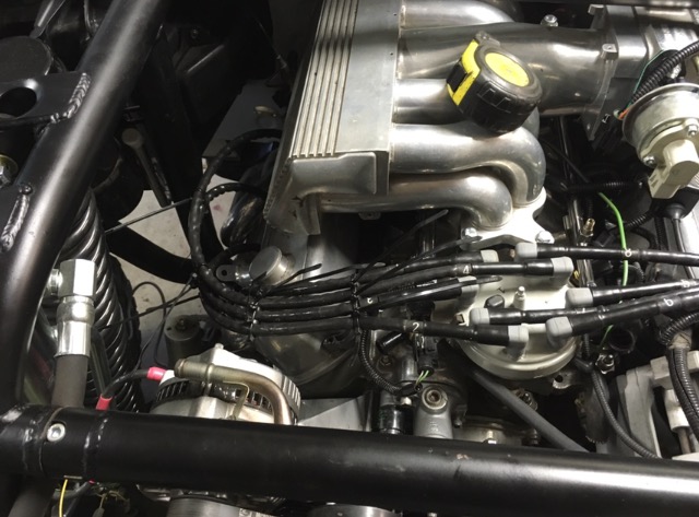

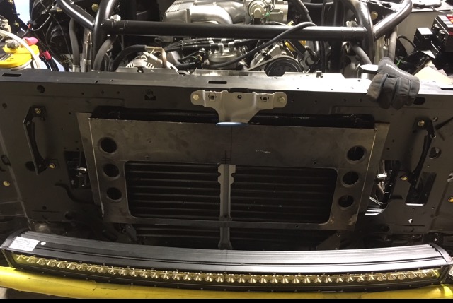

Got fuel pressure to the engine, then finished up a killer set of plug wires and I got a quick 1/2 second fire and shut her down. So great for morale to know the engine kicked over.

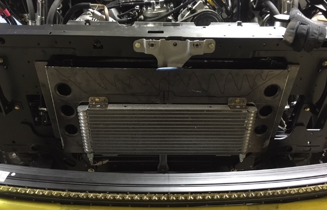

Then started on the trans mount - the squiggly sharpie marker line denotes approx the material I'm going to remove to keep airflow to the radiator flowing.

I was able to get the fuel pump to prime the system fully. Finished a killer set of plug wires, then heard the engine kick over for about a 1/2 second and I shut it down. It's so good for morale to know the engine is fine and ready to run!!! Got the transmission cooler mount about 8O% done and mocked up.

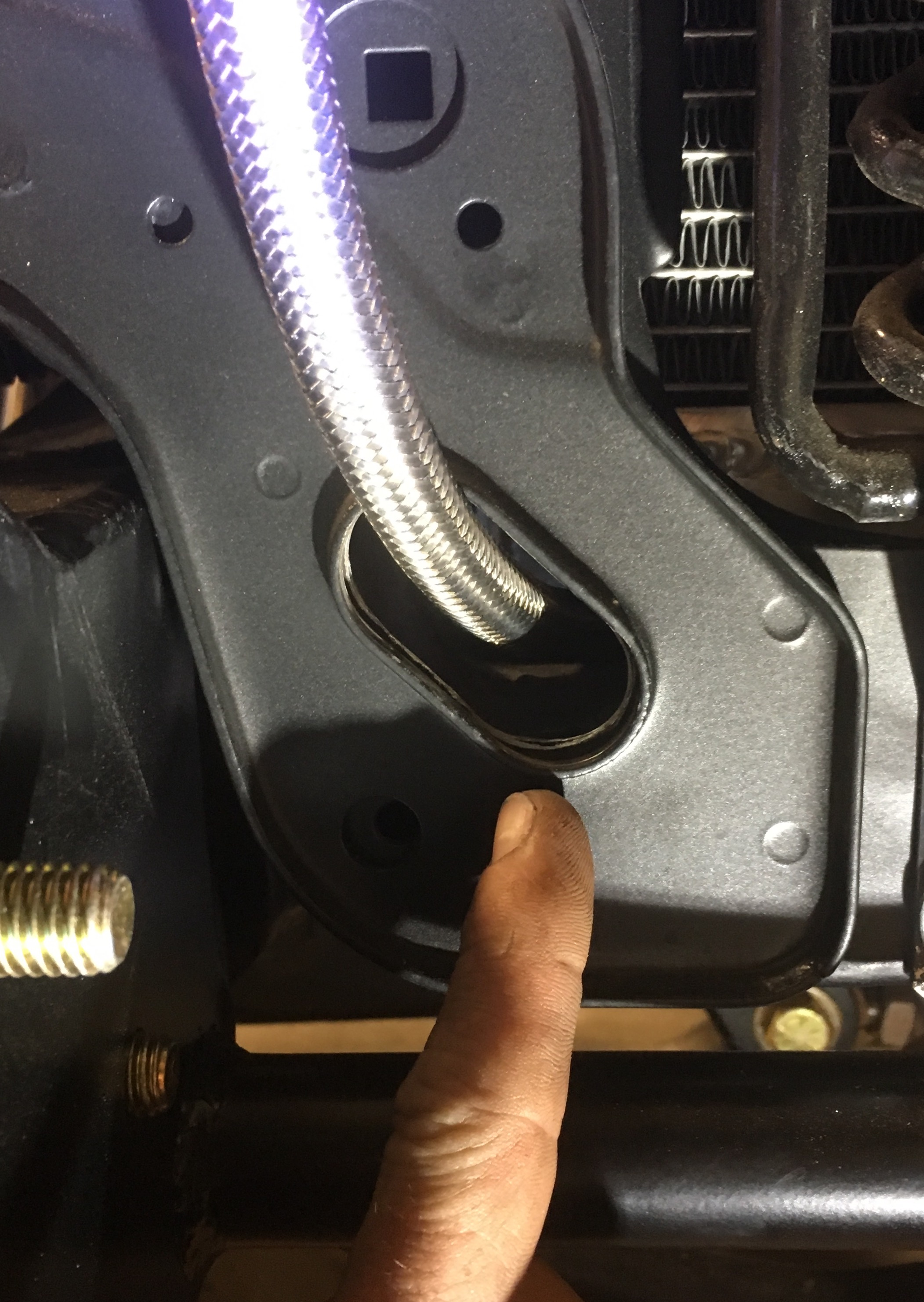

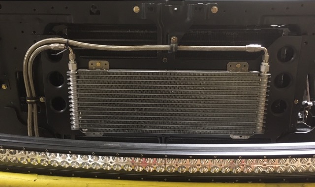

Finally got the trans cooler mount done---mount finished and powdercoated, lines made, and clamps oriented. Hope like hell itau
