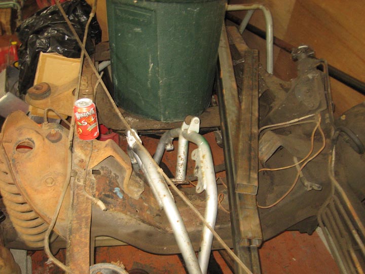

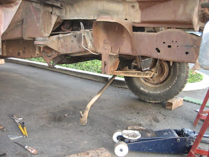

Note there are 2 different coil buckets on these trucks and the top wind on both of them is a bit different than the TTB bronco stuff.
Here is coil bucket type 1 = lighter duty trucks. It's a bit shorter than the next one.
9-23-09 F100 susp off.jpg (93.78 KiB) Viewed 1171 times
This is coil bucket type 2 - found on more heavy duty or higher GVW trucks. It's taller than the 1st one shown above
76 frame section.jpg (82.99 KiB) Viewed 1171 times
