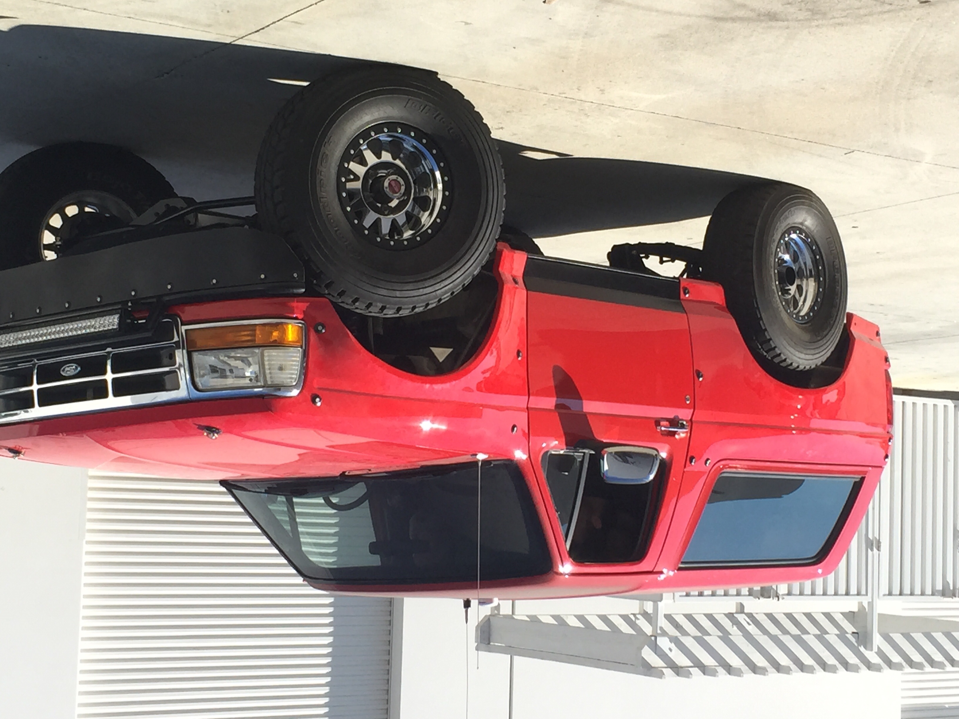

Let's see some build pics !!
MOSS2
Posts: 317
Location: Northern California
Re: Things have changed
Post by MOSS2 »
Hopefully you are not trying to tell us you rolled that beautiful Bronco!!

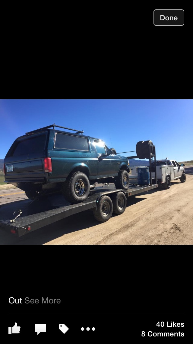

He picked up from Richer yesterday
Things have changed
You Sir have a beautiful bronco. Needs a cage though
