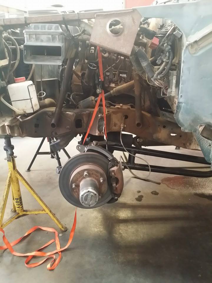

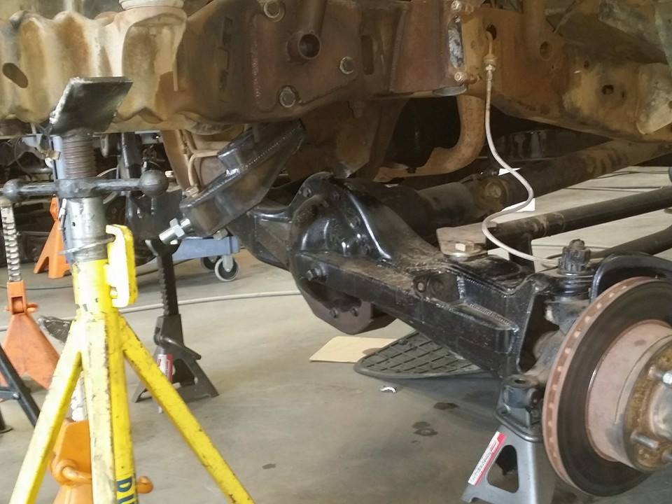

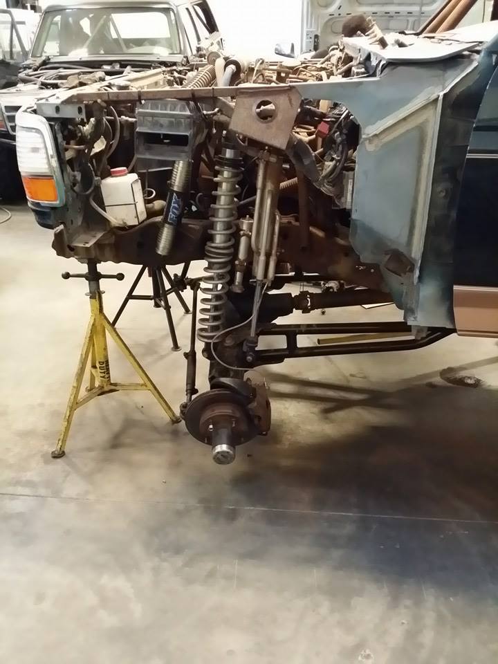

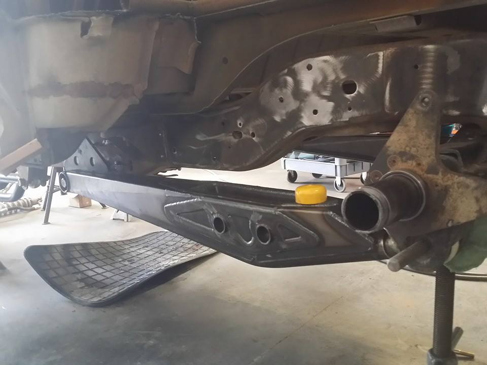

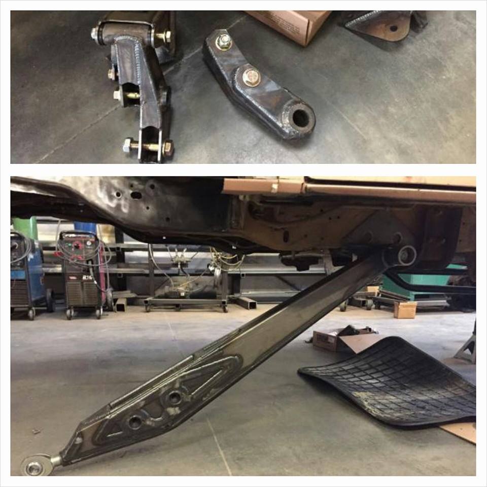

Her is some of the progress that has happened at Richer Racing over the last 24 hours. Pretty stoked on the progress. The Solo Motorsports parts came in and they are awesome.

Solo is amazing I love that place. This will be sweet I can't wait to see more pictures

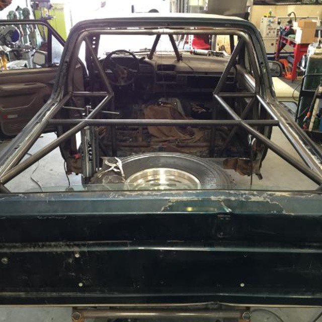

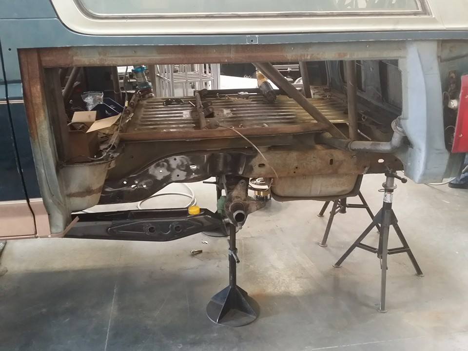

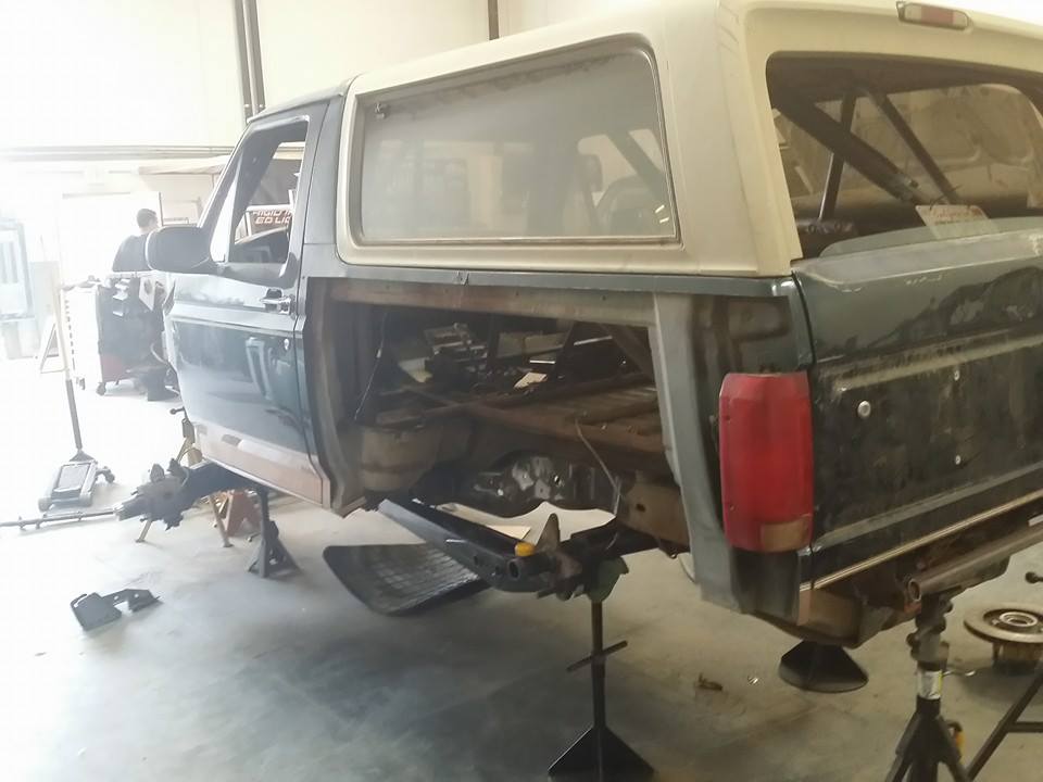

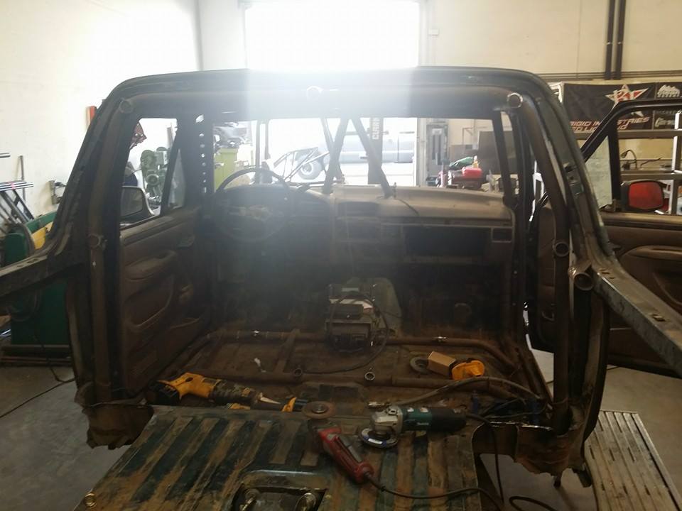

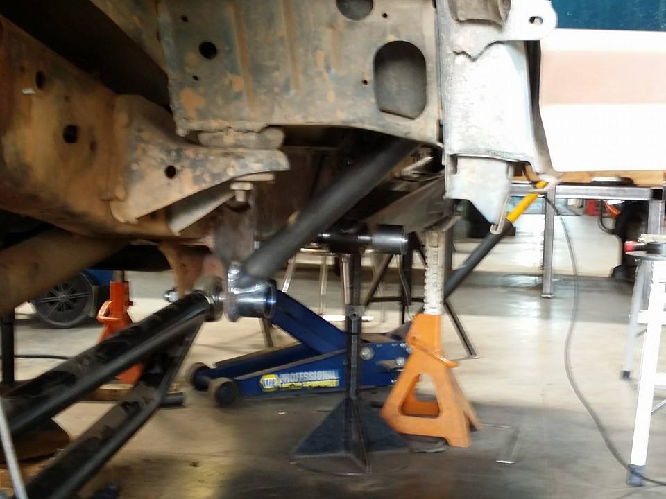

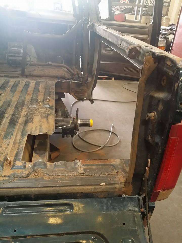

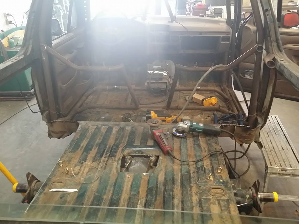

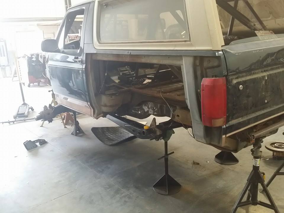

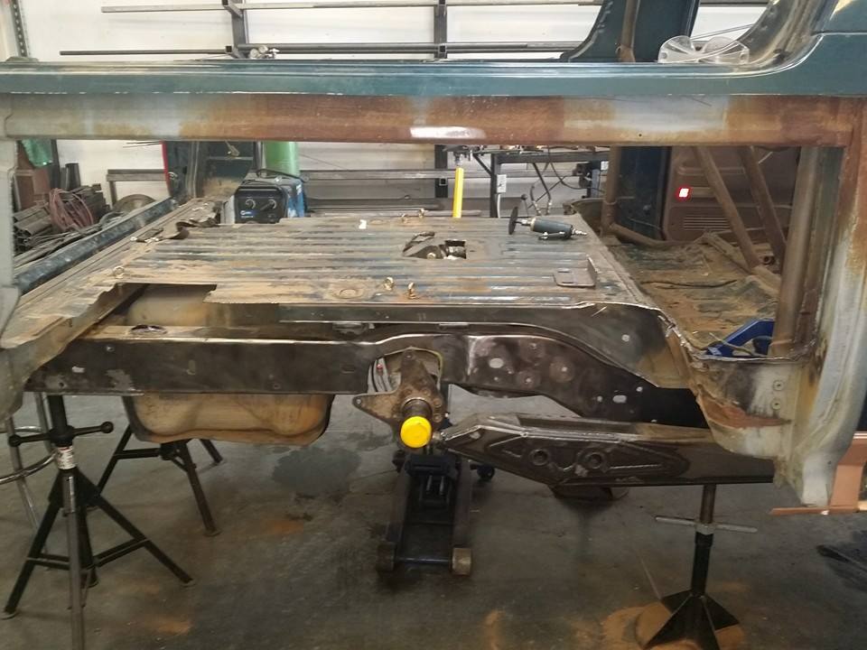

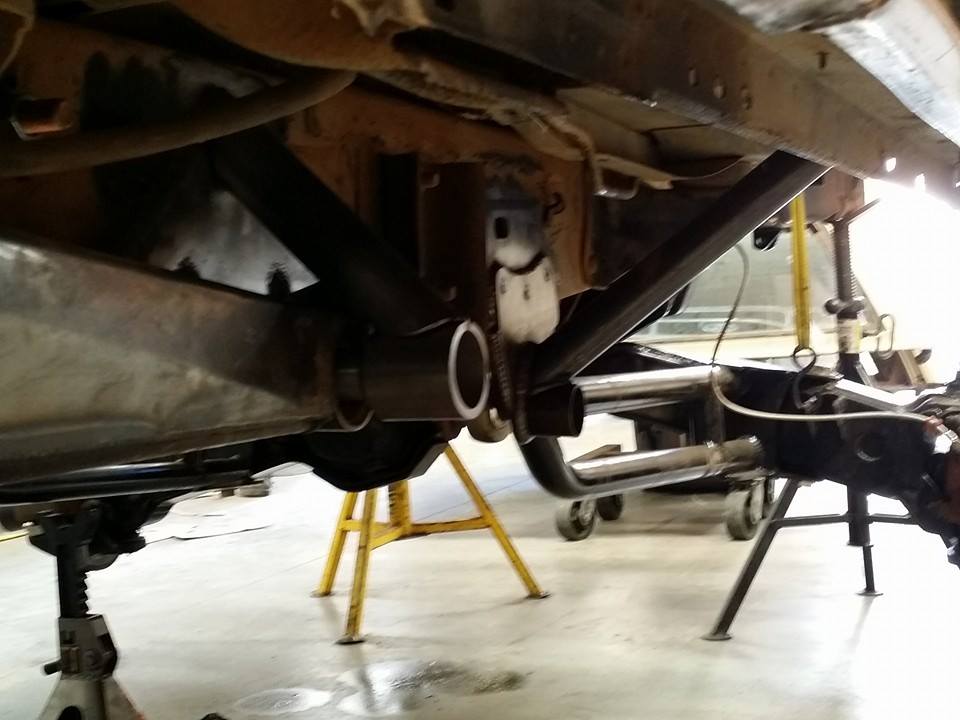

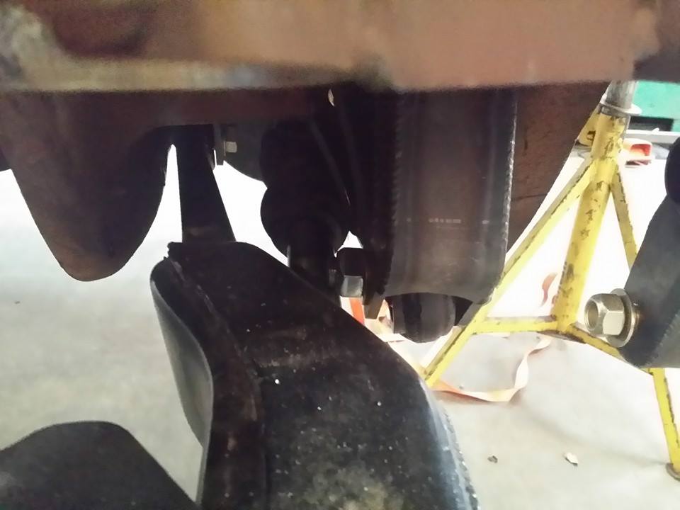

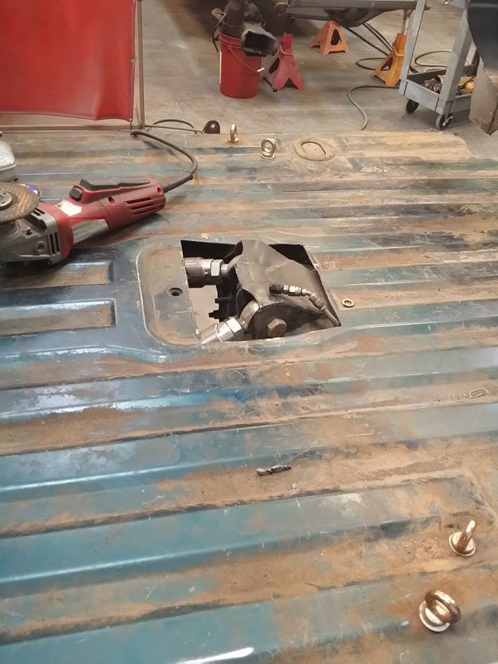

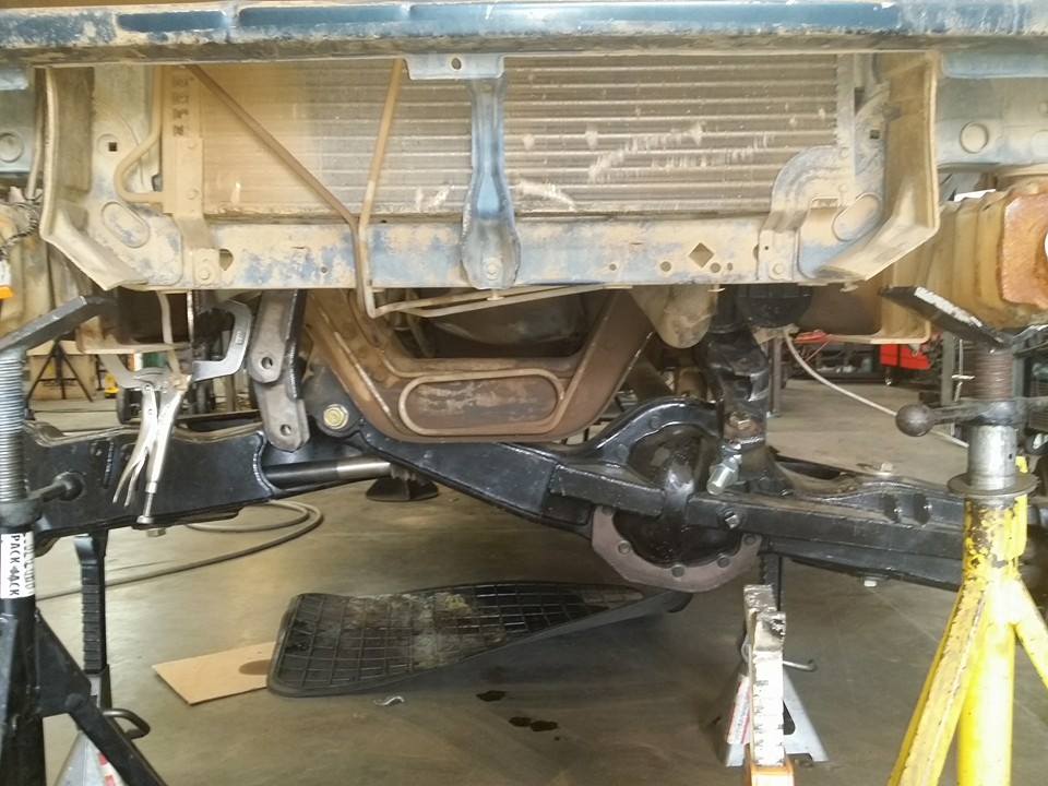

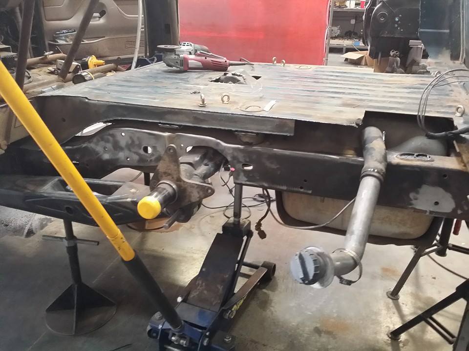

Well now that cycling is happening we decided to notch the frame and play Peek a boo through the rear floor with the upper links and housing. Our goal is to make the bronco sit as low as possible. We also made the decision to cut the rear cage out. CHO and Jonny are planning to maximize the space in the cab and the old cage was not going to cut it. It will also give me some peace knowing that the quality will be top notch. These guys are good. I have worked with several fab shops over the years with racing and building different trucks. Hands down the guys at Richer Racing are good and quick. I have known Jonny for a few years and I should have started doing business with them years ago. Here's some more pics from yesterday afternoon.
Brandon

Liking the quick progress! Looks good.

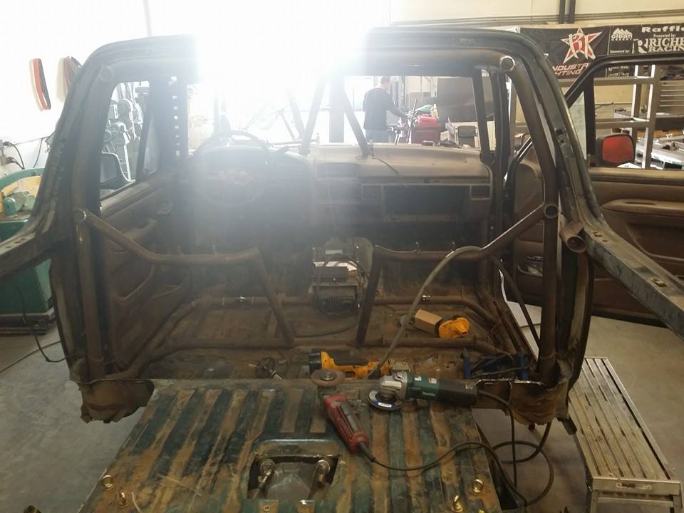

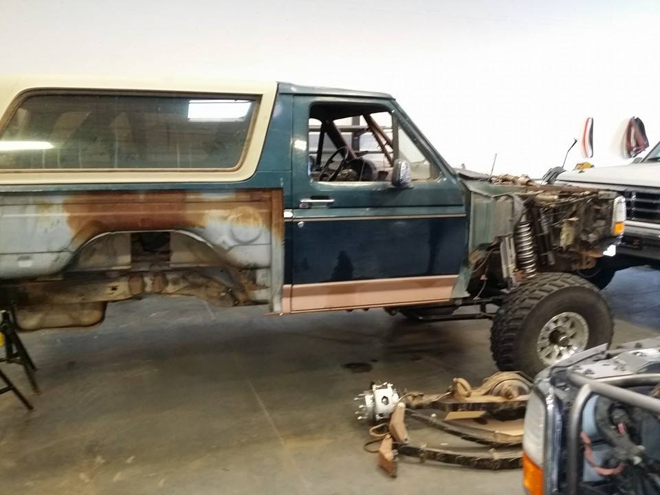

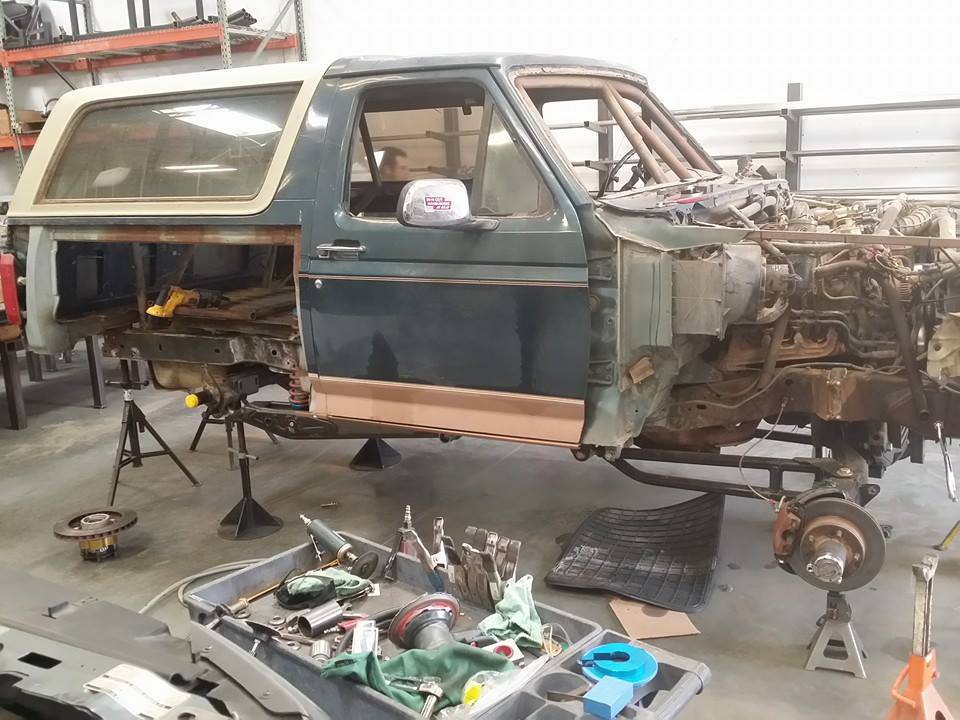

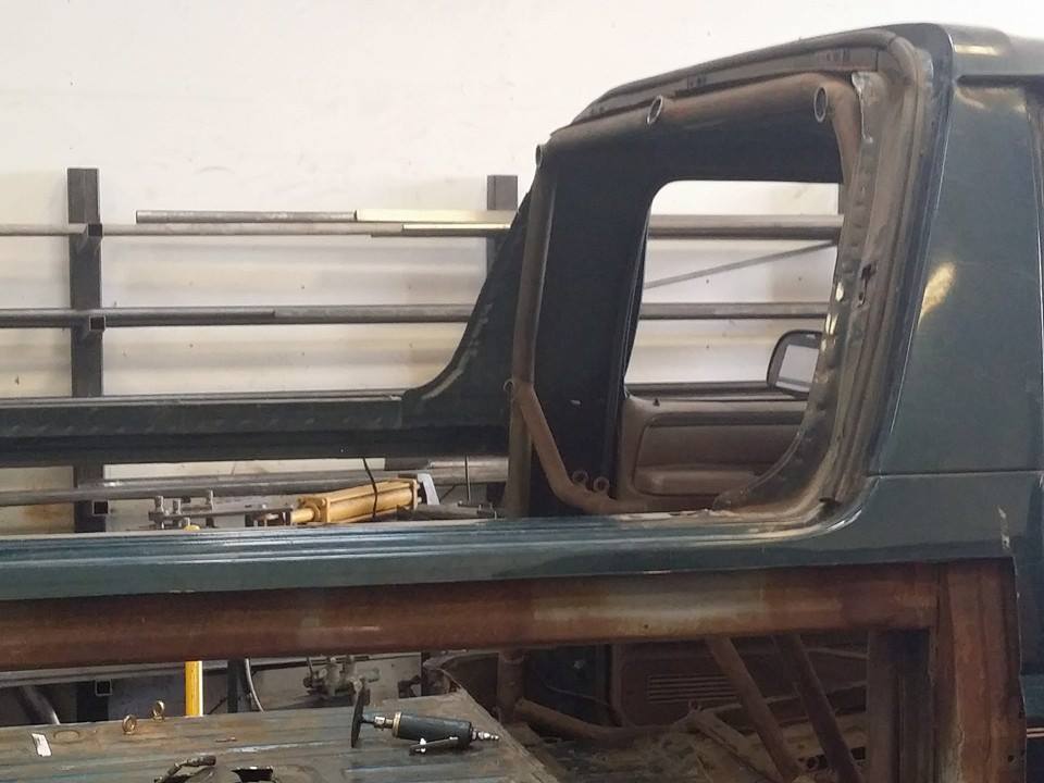

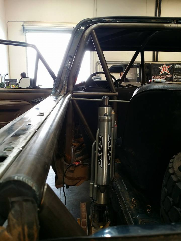

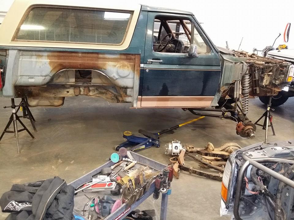

The Richer racing team is cranking on the Bronco.

Loving how tight the cage tubes are to the body!
