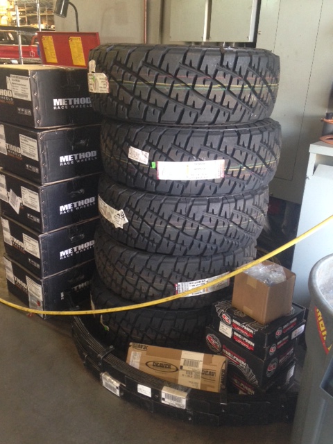

- Sneakers on!
- photo 2.JPG (120.74 KiB) Viewed 2932 times
- New sneakers!
- photo 1.JPG (147.93 KiB) Viewed 2932 times

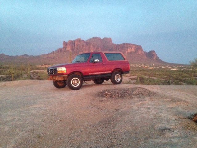

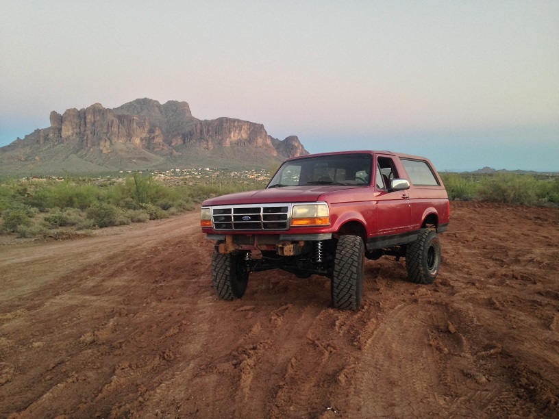

- First night of miles and dirt
- image.jpeg (124.75 KiB) Viewed 2932 times

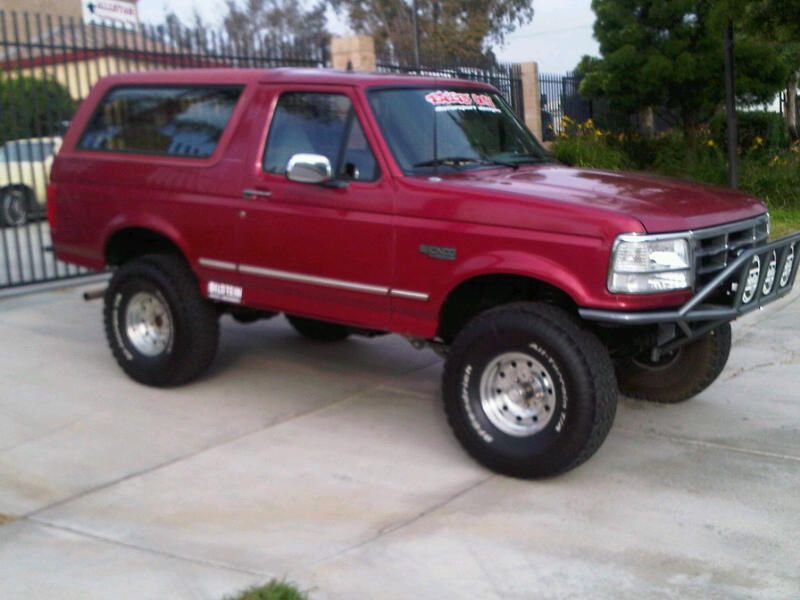

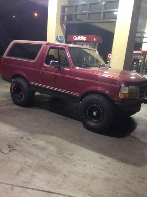

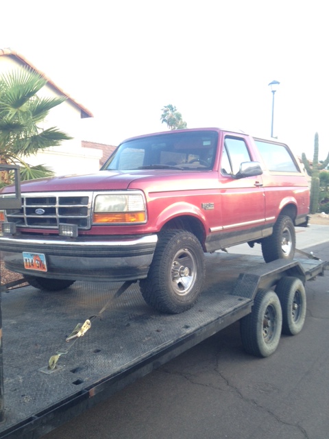

- The day she came home
- image_2.jpeg (114.62 KiB) Viewed 2932 times

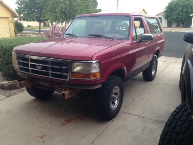

- No Bumpers!
- image_1.jpeg (114.75 KiB) Viewed 2932 times

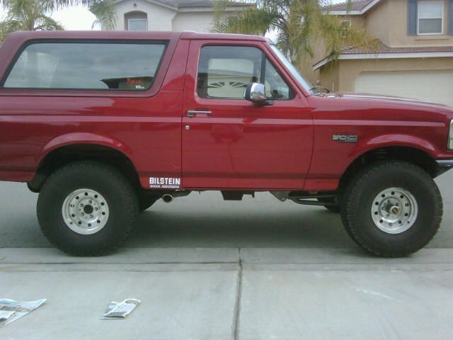

- Front 3/4
- photo 5.JPG (162.65 KiB) Viewed 2430 times
- Side
- photo 2.JPG (180.05 KiB) Viewed 2430 times
- Front
- photo 1.JPG (169.7 KiB) Viewed 2430 times
