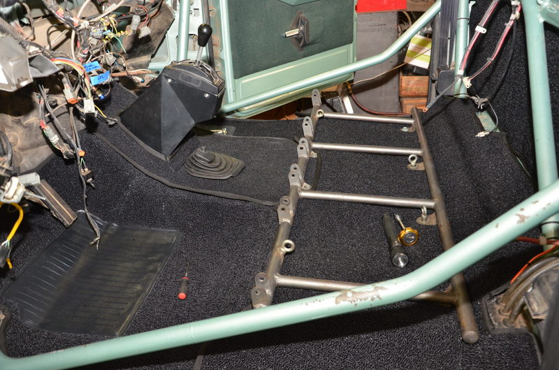

I ended up reinforcing all of my seat mounts and then made a frame to mount the seats to. I wanted a structurally sound base to mount the seats to. I wasn't comfortable sitting the seats on the original floor pan. Thus far, it's worked out very well... I've been using it for about 10-years now. Still tight as the day I built it. Don't know if you want to go to those lengths, but thought I'd throw it out there for consideration.

Ok, I lied... I do have a pic... but it doesn't show the reinforcement in the floor that I did (just the bitchin carpet)... just the subframe. The tabs you see are the seat mounts that have the sliders integrated... I used the MasterCraft sliders... they were pretty cheap. I think they were $75.

Doesn't John make a pre-fabbed seat mount like that, Tom?BajaF250 wrote:Ok, I lied... I do have a pic... but it doesn't show the reinforcement in the floor that I did (just the bitchin carpet)... just the subframe. The tabs you see are the seat mounts that have the sliders integrated... I used the MasterCraft sliders... they were pretty cheap. I think they were $75.

Ya know, that's an excellent question... don't know... but I can find out. I'm heading over there today and I'll ask him.SteveG wrote:Doesn't John make a pre-fabbed seat mount like that, Tom?BajaF250 wrote:Ok, I lied... I do have a pic... but it doesn't show the reinforcement in the floor that I did (just the bitchin carpet)... just the subframe. The tabs you see are the seat mounts that have the sliders integrated... I used the MasterCraft sliders... they were pretty cheap. I think they were $75.
