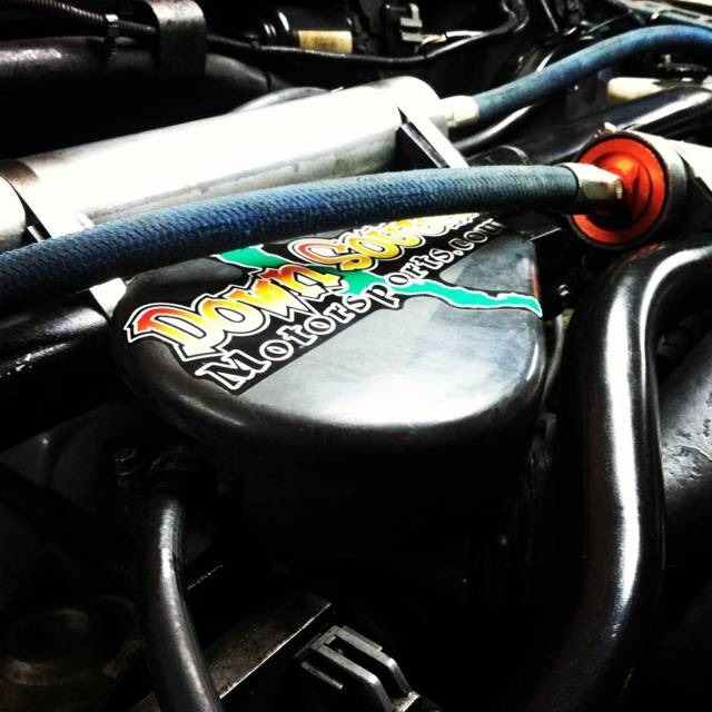

Check out the front cross member, some serious bend action, still need to get the resi's solid mounted. Also threw a little gusset on from the shock hoop to the frame.

Sick bend! I like it

Bends like that suck to do! Good work.

I can't take credit for the bend. Our fab guy at Fiberwerx busted it out for me in 10 minutes. I stared at it for longer than he took to build it!!!! I've chipping away at it every night though, list is finally getting short.
