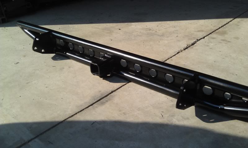

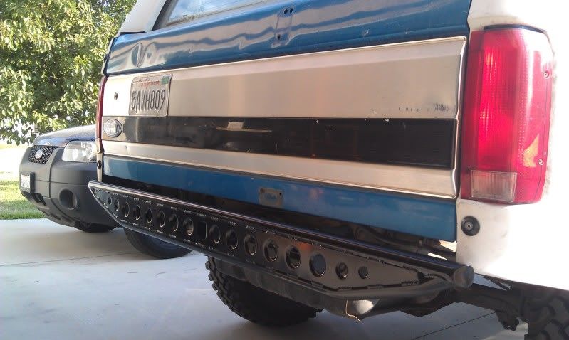

Finally finished the rear bumper and relocated the license plate.
Kelly @ Kel Fab Creations
Sweet, speed holes for aerodynamics!!
economig
Posts: 1101
Location: SW Riverside County
Post by economig »
robertcrav wrote:Sweet, speed holes for aerodynamics!!
Ha ha ha nice Robert! it just so happens, i'm in the market for a new set of aerodynamic hole dies i can't afford!
Bumper looks sweet Kelfab
bumper looks good Kelly.
Yeah...btw, I likey as well
I like it Kelly!! Really adds a nice touch!

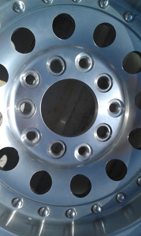

So I have been trying to sell the wheels that came with my tires for a few months with no luck (5 on 5 pattern) so I decided to make them usable and machine a 5 on 5.5 pattern.
I've always liked the outlaw 2's so I may put them on mine. I really like the look and function of the beadlocks I made but they have been difficult to balance. They're good up to 50, after that its pretty noticable. What they probably need is a welder next to the balancing machine and a series of welds instead of sticky weights that fall off . Or maybe I should stick the wheels on the lathe to face them and zero out the bore of the ring I welded on. What do you guys think?
Get tire beads.
philofab wrote:Get tire beads.
X2. I've been running them for 4+ years with zero issues.

I've read that if your cruising and hit a pothole or something the beads will throw it out of round bad till they rebalance. Can u give me a link to the ones your using Brian? So u have no weights right? Just beads?

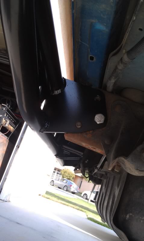

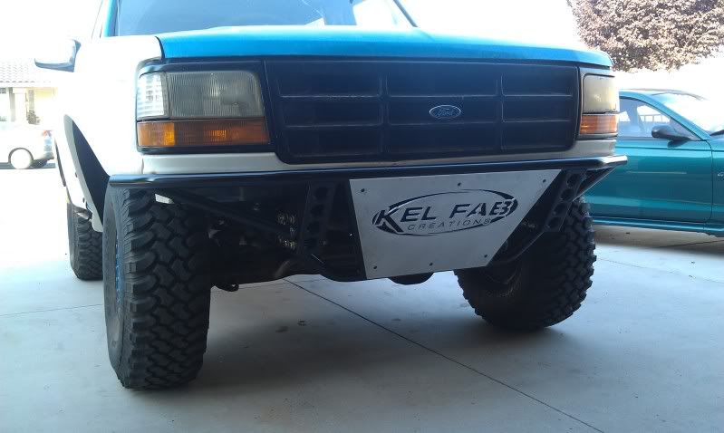

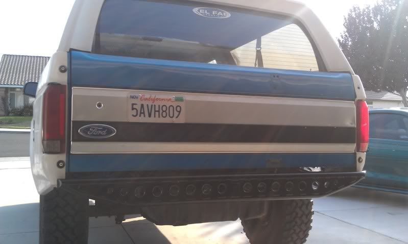

new bumper
Mojo
Posts: 444
Location: Prescott, AZ
Post by Mojo »
looks nice... love the dimples :lol:
Far out man!!!!

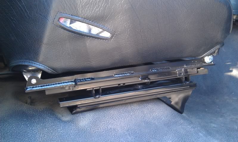

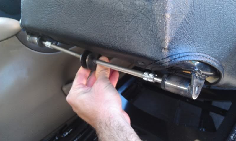

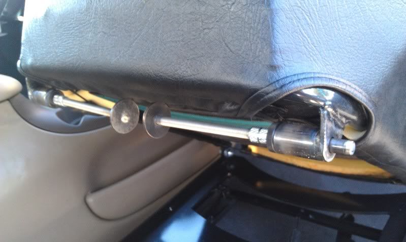

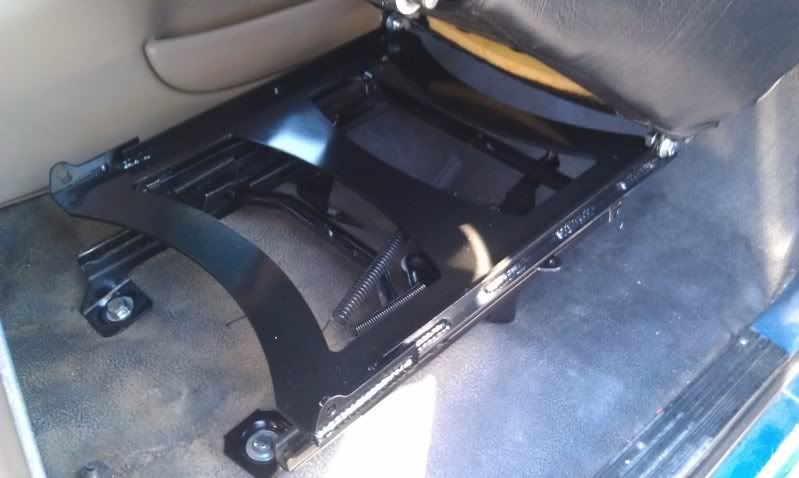

pass. side tilt seat mount. simplest/functional way I could think to do it. What do ya think?
That can work. I think a lowback or removable headrest seat works best for this, but as long as you're not hitting the roof & stopping the seat when you try & lean it forward it should be good to go.
I tried it before in the ranger but seat hit the roof before it leaned far enough forward to do any good.
