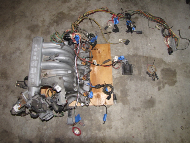

I've done about 95% of the wiring work that can be done outside of the truck. I'm still trying to decide what to do about fuel delivery. I should just put the pump in the tank as that would be cheapest and this is a super low buck project, but I just don't want the pump back there... we'll see.
Once you strip down the EFI harness to it's bare essentials and weed out non-EFI wires it's actually not that bad. I just might start doing this for fun!
