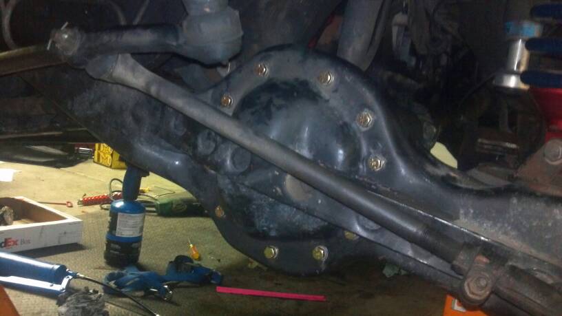

Man Mark is the man! He regeared the front diff welded off the cover and ground down the axle for more clearance. Oh and its as clean as its ever been. He also modded the spider gear to run the c clip.

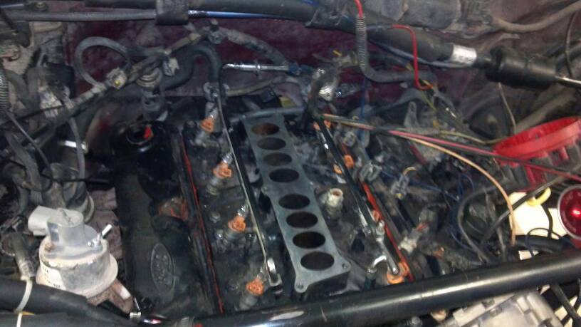

So i found the coolant leak! It was the lower intake manifold. A pic of it apart.

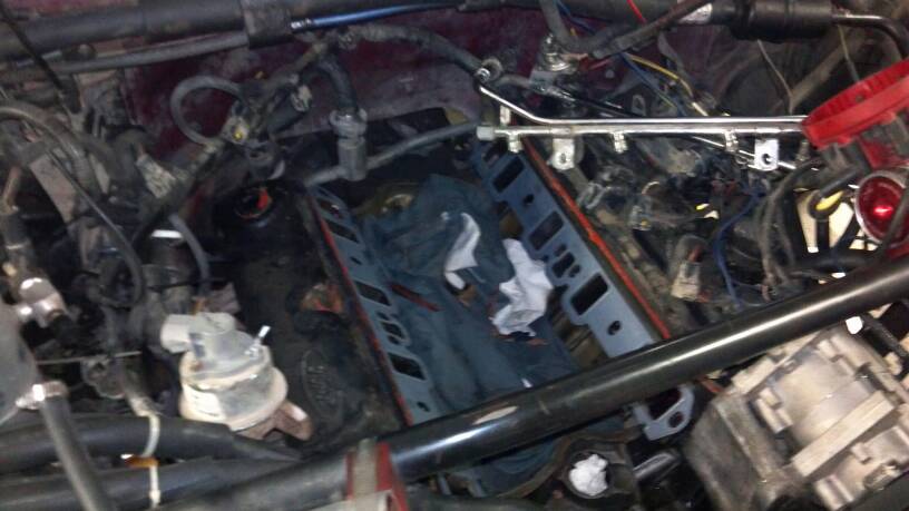

Haha were not too far from oc. Got the lower intake back on!

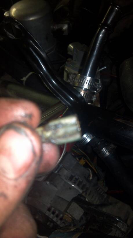

So i got the diff in and added some bling. Also i thought the starter wasnt engaging but turns out it was another noise. Earlier i had replaced the lower intake manifold gaskets and heard a clacking noise after i started it up. Found this little guy in the first picture sitting behind the lifter. Still cant figure out how it got there...
