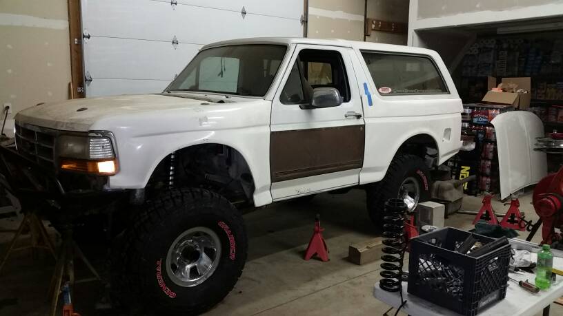

Couldn't wait had to set the glass on to see what it was going to look like.
ChiroMatt
Posts: 191
Location: Calaveras
Re: snowman429's 93 Bronco v2.0
Post by ChiroMatt »
Looking good.
Did u replace the plastic that runs across in front of the radiator?
More pics please.
