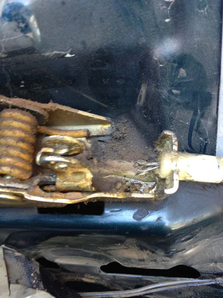

Pre Baja carnage
Before we arrived to toms this happened.
This is the inside of my passenger door handle. The link broke so I can only open it from the outside

Re: D1cker1 93 Build
D1cker1 wrote:Pre Baja carnage
wtf is that?
Re: D1cker1 93 Build "The Croc"
glad I'm not the only one who was lost with that pic...
wtf is that?
lol
Door handle?
