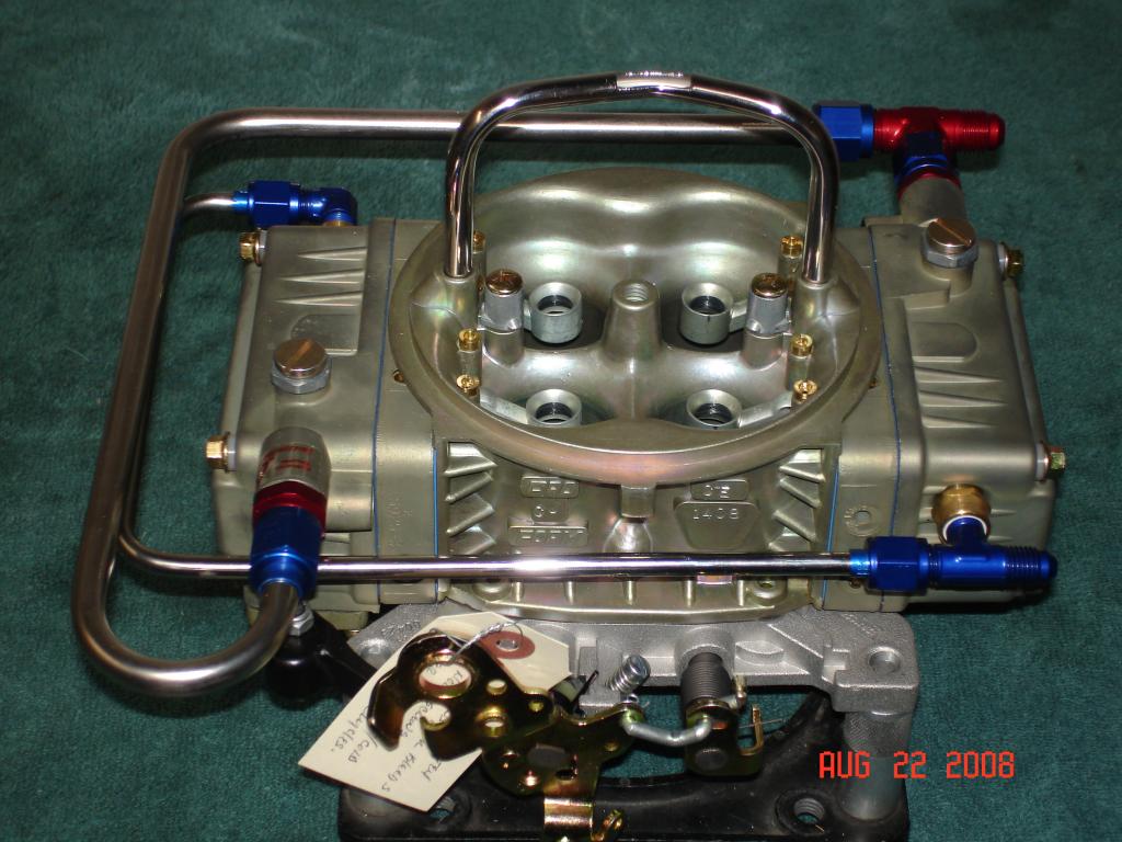

I have my carbs built by John @ C&J Engineering
http://www.candjengineering.com/
He has built the one on my prerunner and race truck. They cost a little more but they run like fuel injection. They will run at any angle and never even a bobble in the whoops.
Here is a pic of the off road carb like you will need, (based on 600 cfm, vacuum secondary Holley) it is about $800. for one like you will need including the sucker pump. Spend the money once and forget it.
