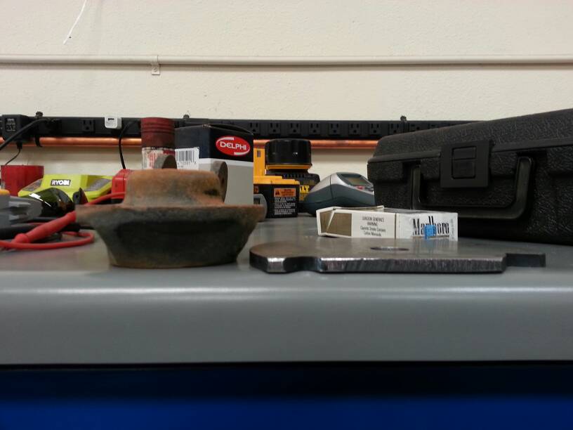

Deavers going back on. Used Balistic fab spring plates to lower ride height.

With the new spring plates and deavers ride height only went up a half inch. I still have a slight rake, 3/4" higher in back. Rides sooooo nice.
- Posts: 6028
Re: Ryan's '96
The way I did mine was leave one side bolted up to hold the axels orientation, remove the factory leaf perch. Weld on a replacement at the correct angle. This allows you to shitcan the wedge block and will lower the rear almost an inch. Then repeat on the other side. If you've already done this sorry, I'm at work and don't have time to look through the preceding in the thread. Also you can go +.75-1" easy with the shackle further lowering the rear.
