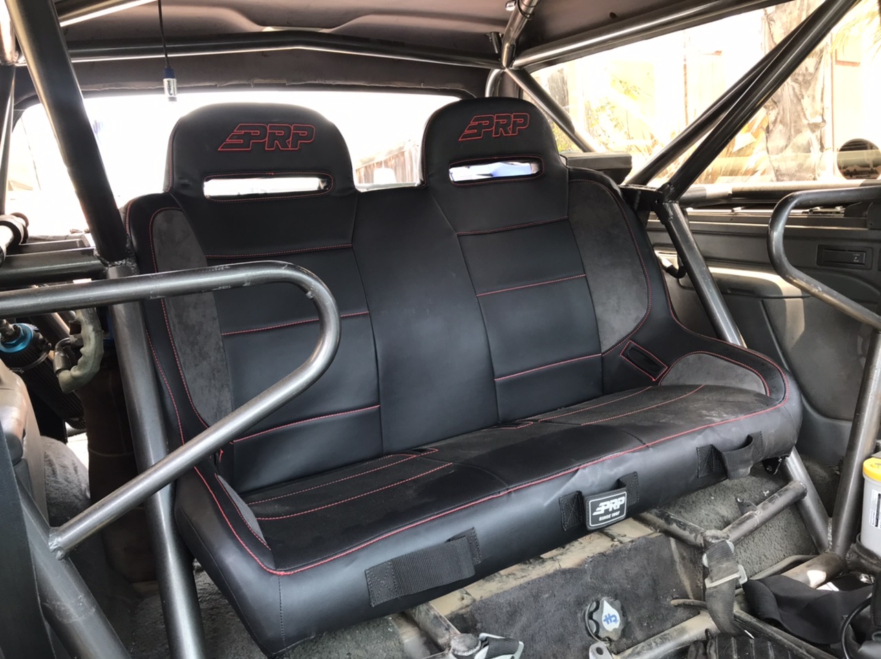

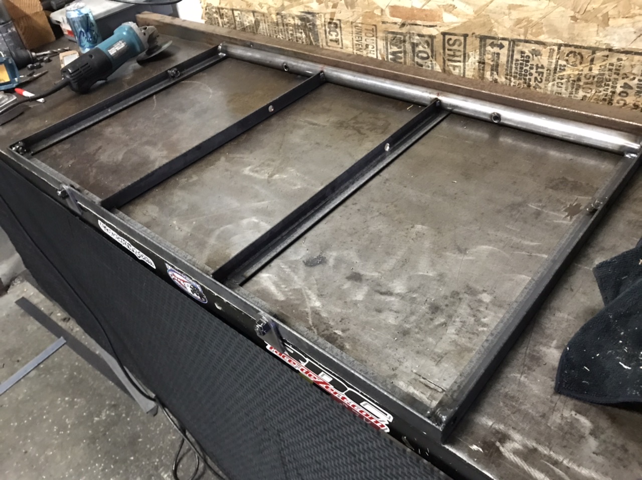

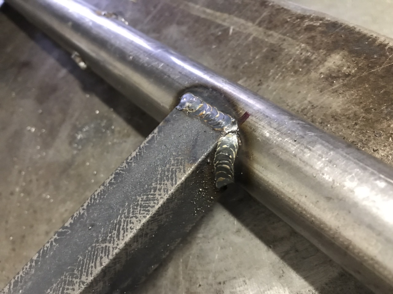

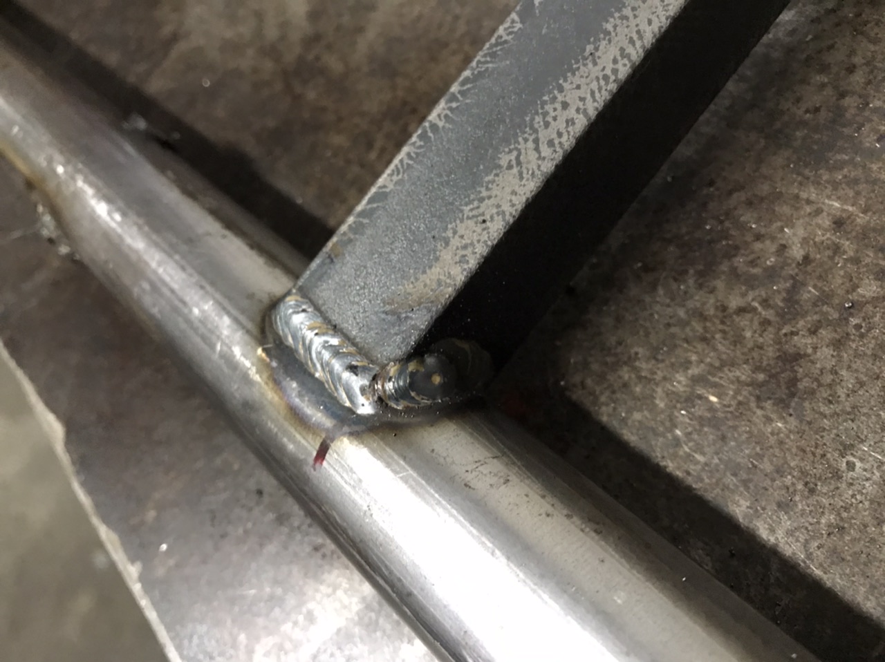

Back seat upgrade. PRP 45” wide bench, seat heaters and garage fab mount. Please note I am not a fabricator. Please be nice haha.

Looking rad!
Re: Willie's.....1992
Cool idea on the brake light! And that seat mounts looks pretty dang good for not being a fabricator.

ChaseTruck754 wrote:Cool idea on the brake light! And that seat mounts looks pretty dang good for not being a fabricator.
Thanks, desk jockey by day at 4WP. I have some fab tools but I haven't welded or anything in years.

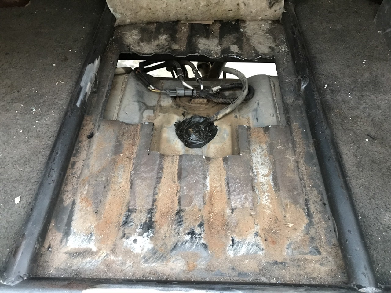

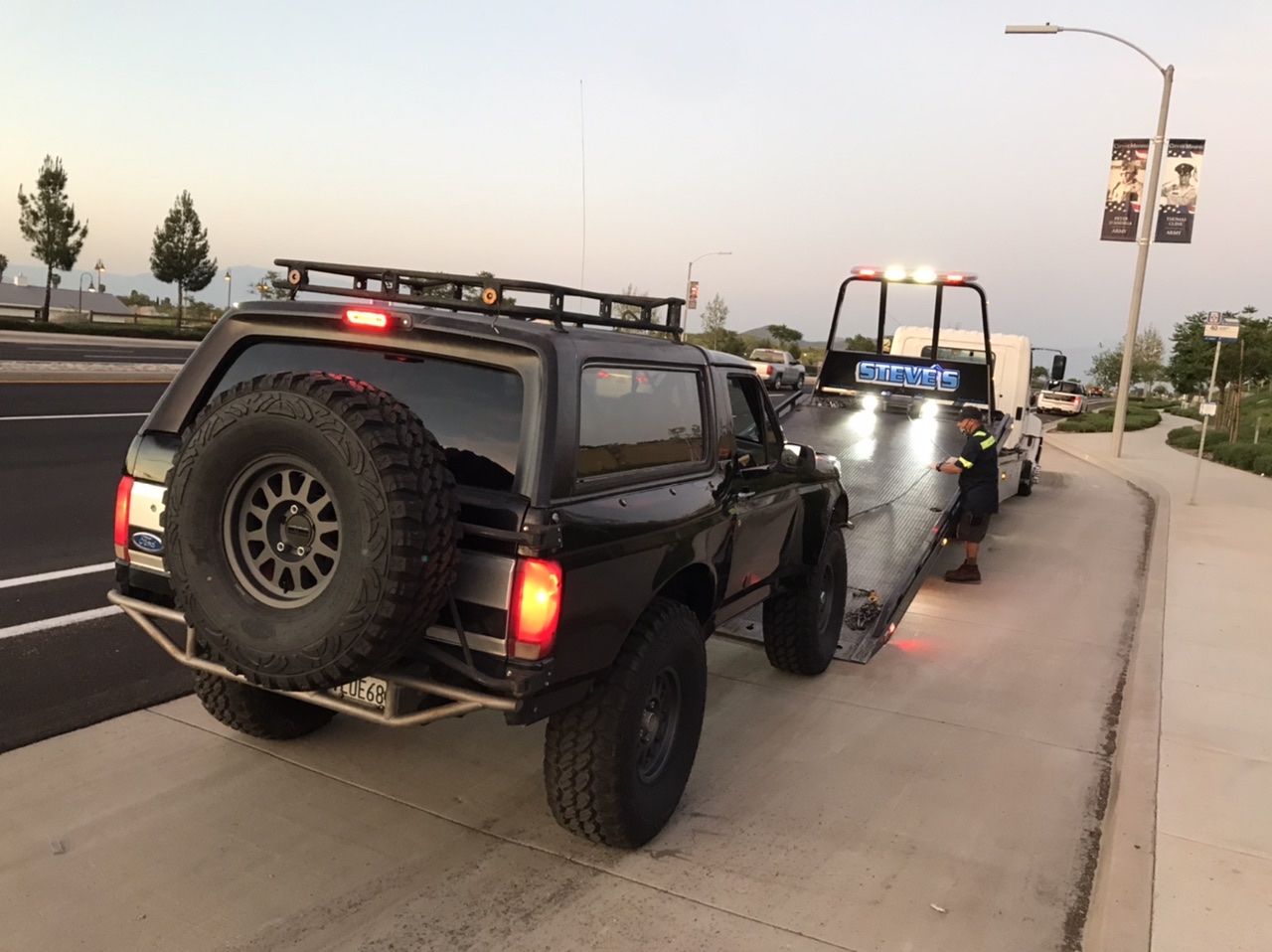

Back on the tow truck. Damn fuel pump.

Back in action. I installed a nice Delphi pump.

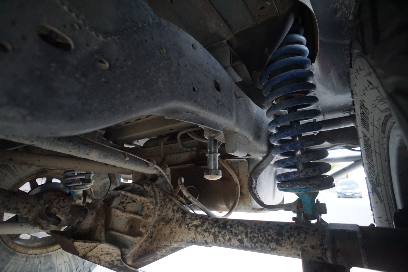

I have a few questions for the Bronco Masters.
1. What coolant is the best for this application?
2. What gear oil do you guys prefer and why?
3. Any suggestions on spring rates for rear shocks? It feels stiff in the rear and bucks like crazy.

do you want to deal with the shocks yourself or do you want a recommendation on someone who can get you fixed up?

I am looking for input to see what others are running.

too many variables especially since you are linked to the axle. typically in my experience if the rear is 'bucking' you dont have enough compression and potentially too much rebound.
spring rate is simple. keep it to 2-3" of pre load in the rear, 1-2'' in the front, with a 100-150 spring rate split.

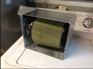

I will do that. I have not pulled the console yet to access the controller. On a separate note, do you know what filter this is?
