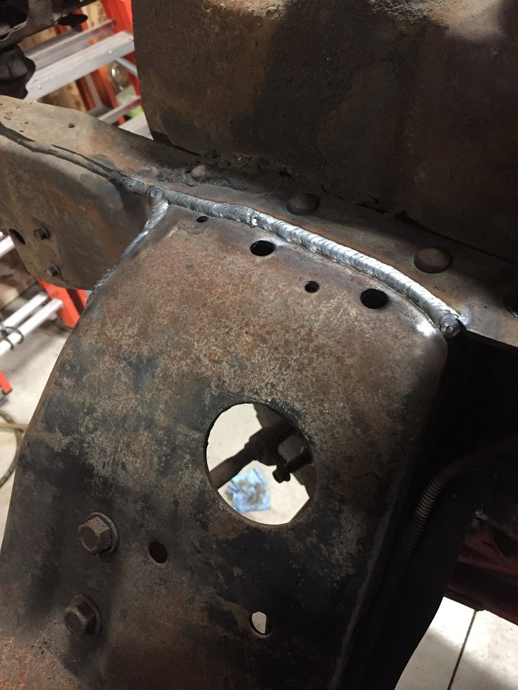

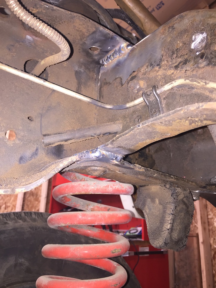

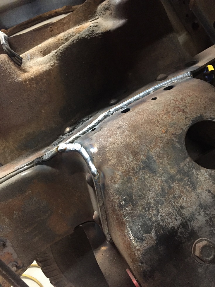

Got a little more progress done over the weekend. I removed the factory frame motor mounts. Then I was able to weld the engine cradle to the frame rails everywhere I could. It actually welded better than I thought it would being that it has 37 years of oil and crud in all the seams.

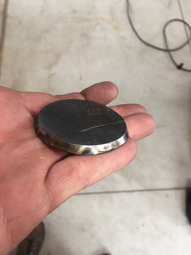

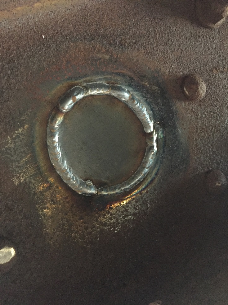

I also filled in the 2 1/2" holes on both sides of the frame rails above the front leaf spring perches.

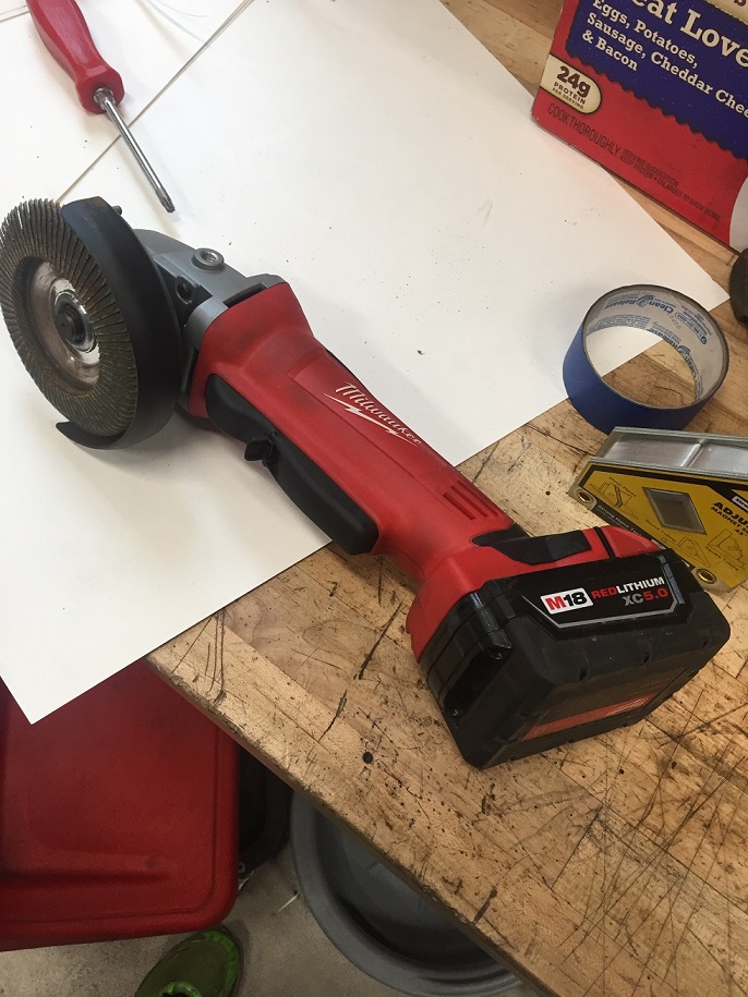

My new cordless Milwaukee 4" grinder is MUCH better than I thought it was going to be. It's got more power then my other corded Milwaukee 4" grinders and it's quieter.
