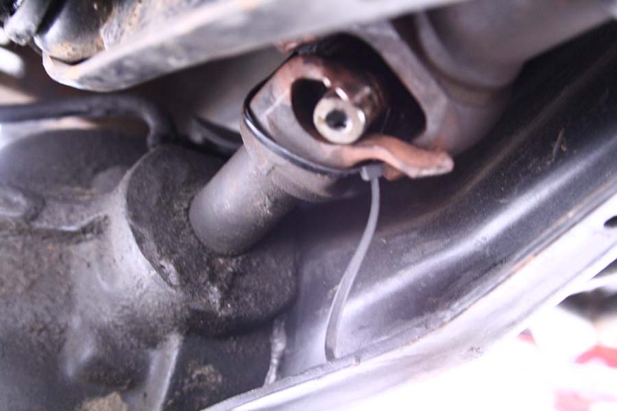

I had a little to much fun in pismo lofting off the dunes and found out the hard way that its not a good idea to jump in 4 low...HAHA
Does anyone have a extra rt inner axle for sale?

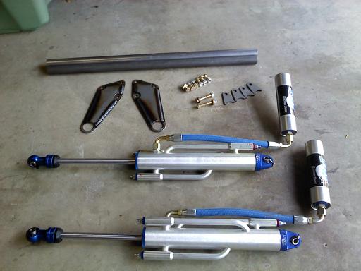

Picked up a set of Fox tripple bypasses and Solo Motorsports DIY rear shock mount today. Got everything installed and is looking sweet. Just need to cycle it and set the bump and droop then its off to play! Big thanks to Bobby at Solo for all his help!
More pics comming soon...

Hey looking good Randy. I like the rear shock mount. Can I ask how much they charged you for it? I've been looking for a rear shock mount like that.
Re: Randy's 93
They sell them for $250 and its well worth it, pretty simple and straight forward install!

Nice to know my shock mount over at solo went to good use. It has been revised since then.Rwies wrote:Picked up a set of Fox tripple bypasses and Solo Motorsports DIY rear shock mount today. Got everything installed and is looking sweet. Just need to cycle it and set the bump and droop then its off to play! Big thanks to Bobby at Solo for all his help!
You need to tie the shock tab back to a bolt on the mount or you will break the uprights.

Oh wow that was your design? Very nice Kris...so did you hook them up with the templates?
Ive got some 1" im thinking about using to reinforce the shock mount...Just below the shock tabs to a flange then from the flange to one of the upright mount bolts, sound about right? Got any pics of the new revised mount?
So i confirmed that i do in fact need to revalve the rears...I had both compression bypasses closed and was on the rear bumps multiple times...I tested the shock usage with the "ol zip tie" technique. The rebound felt pretty good. So maybe when you have some free time i can swing by and drop these mamba-jambas off!

They have the whole second hoop I lasered out sitting at Flynns bench but it is a take apart design that meets in the middle. I should probably get him to bring it to me.Rwies wrote:Oh wow that was your design? Very nice Kris...so did you hook them up with the templates?

Most dont pick up the factory 3 shock mount holes so no drilling is required or at least I didnt see any like that prior to making mine. I only saw autofabs prior to making mine that was bolt together and since drilling was the biggest complaint of the autofab one I made mine without drilling.philofab wrote:Everyone has that template file huh?
