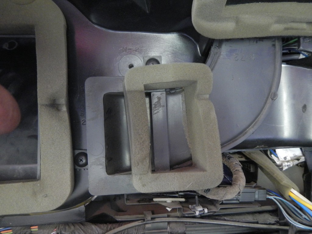

As this renovation approached, I did plenty of reading about the factory HVAC deficiencies, especially the defroster ducts. I know Ford issued a TSB back in the day to address a few of the problems, but since we never used the air in our rig before the boys tore it apart we never knew how much it wouldn't have worked. Look what they found behind the brown dash.....
DSCN0510 (Medium).JPG (171.4 KiB) Viewed 3469 times
If you ever have cause to take your dash out......be aware!

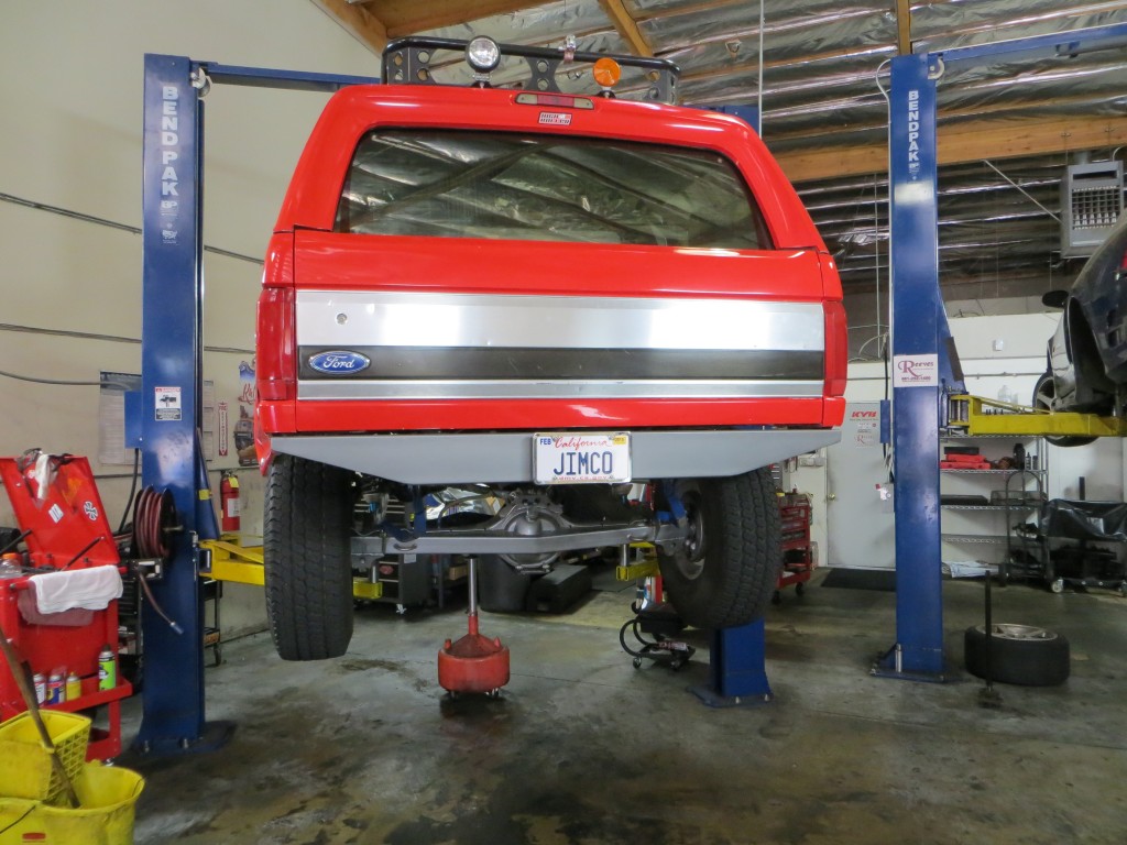

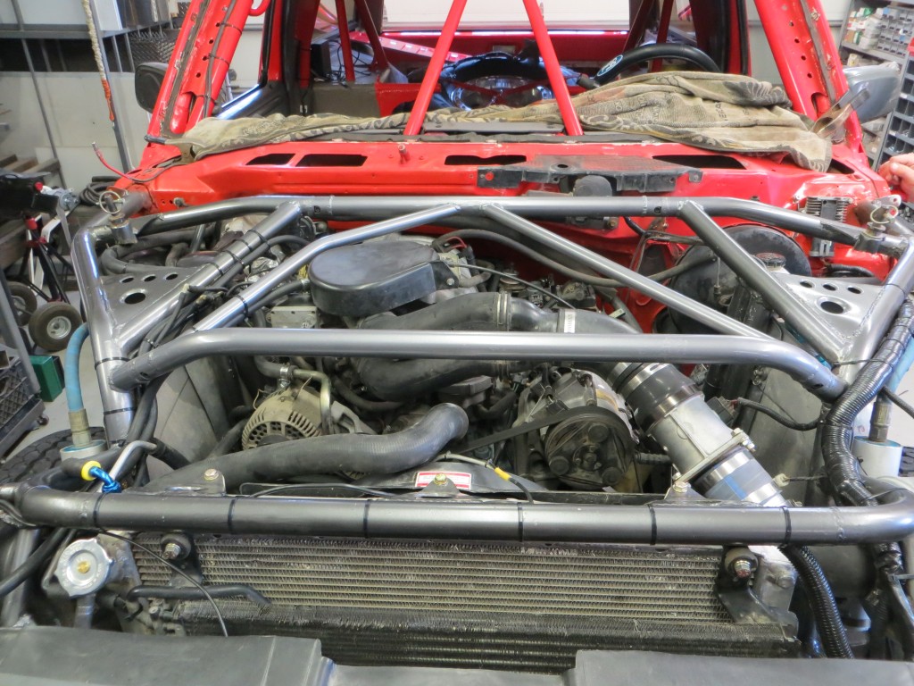

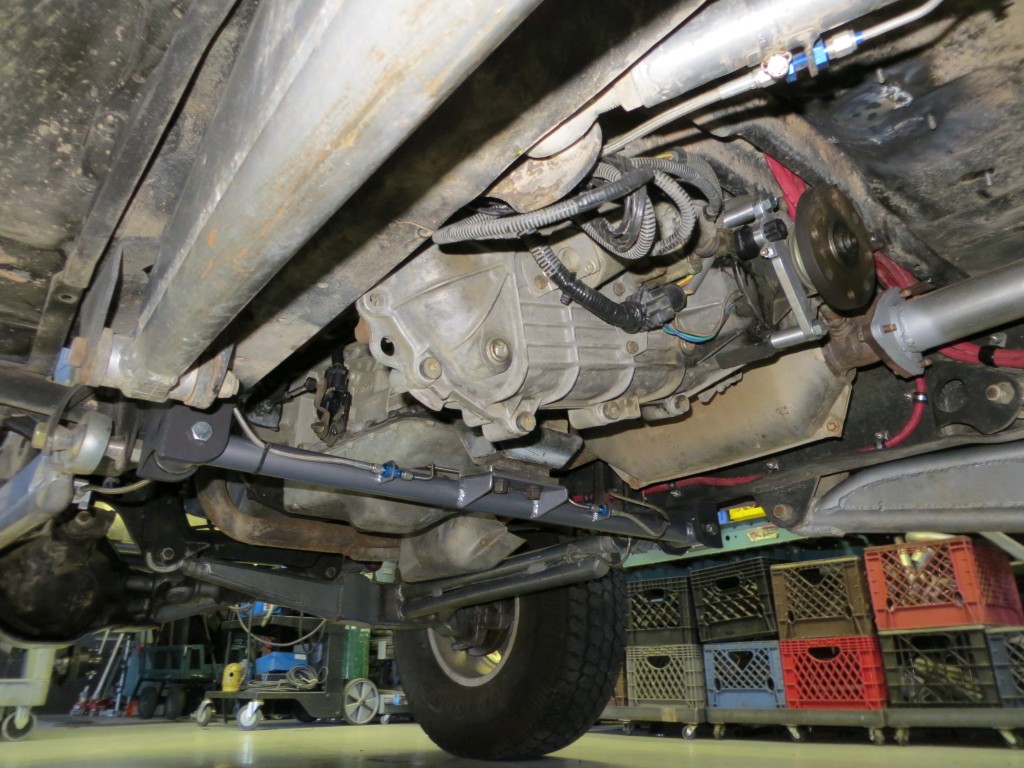

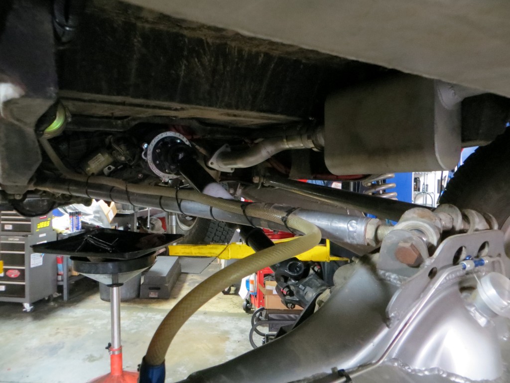

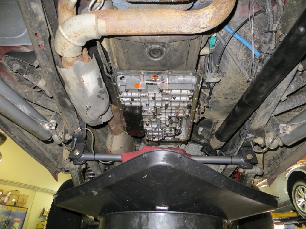

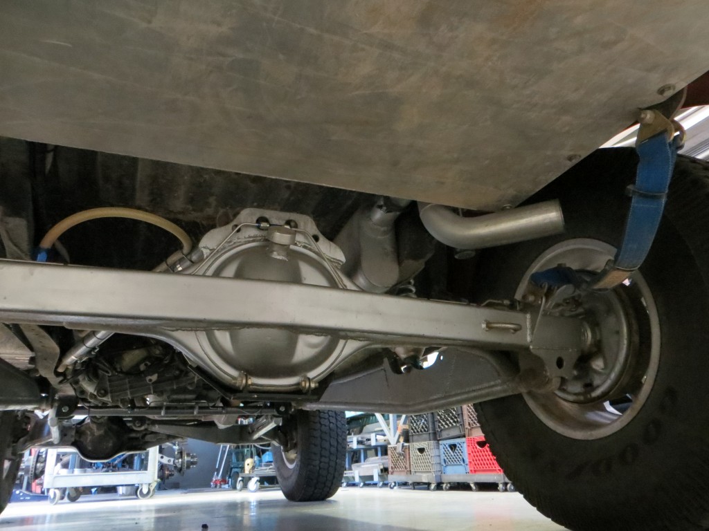

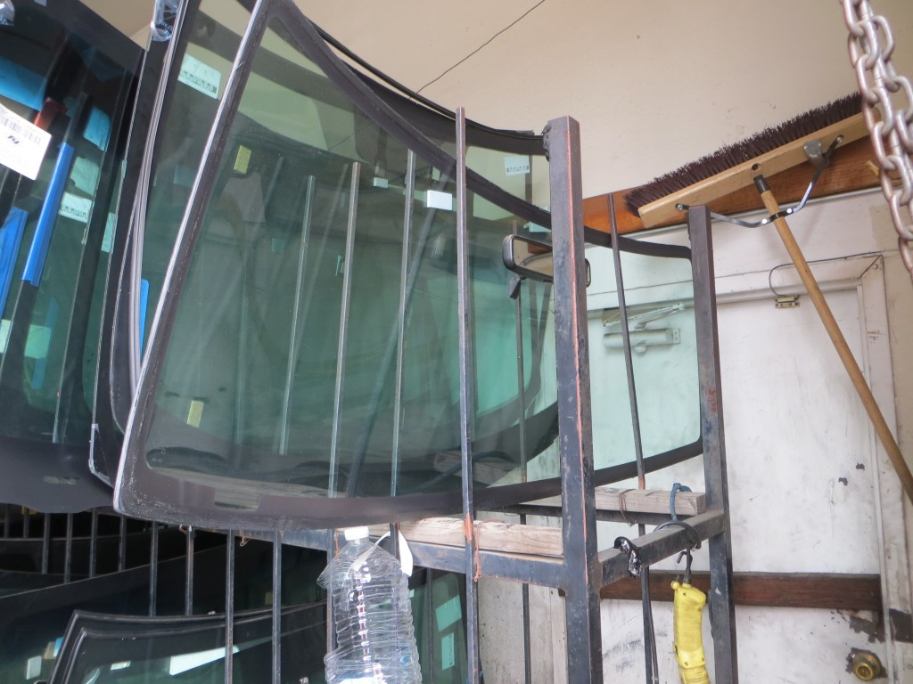

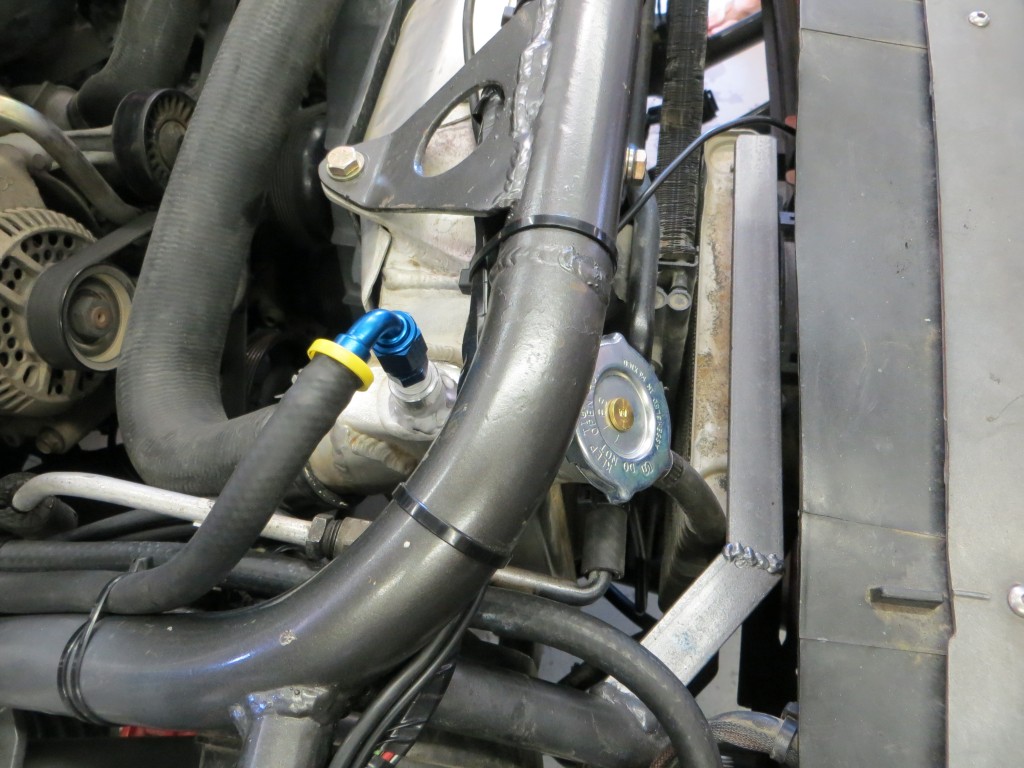

July 11 - It runs!

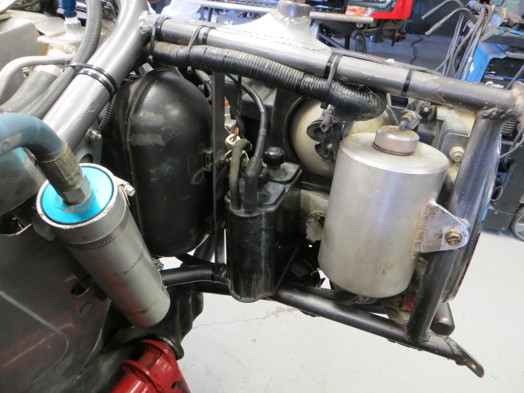

Literally at the first hit of the key and the now-96-in-a-92 shell comes to life, purring like a kitten. Greg and Blake finished up the basic wiring and a few final things under the hood. The engine cage is complete and all of the emissions components are in place, save for a bit of vacuum line cleanup Greg had to order some fittings for. The exhaust is mostly routed, and we're considering how best to deal with the tailpipe exit.....again not too many options with my links and skid but there can be no turn down (aka dust maker) and must have proper exit so the tailgate doesn't suck the fumes in.
Greg took his son to orientation at ASU, and Blake is studying a few wiring schematics to troubleshoot a few bugs that remain. They will resume tomorrow July 16 and it appears this Bronco will leave the shop under it's own power on Friday! The custom driveshaft will arrive by then, and Greg will have the temporary fuel filler complete by then. I'll be making a few stops with the Bronco on the way home to work on the accessory wiring:

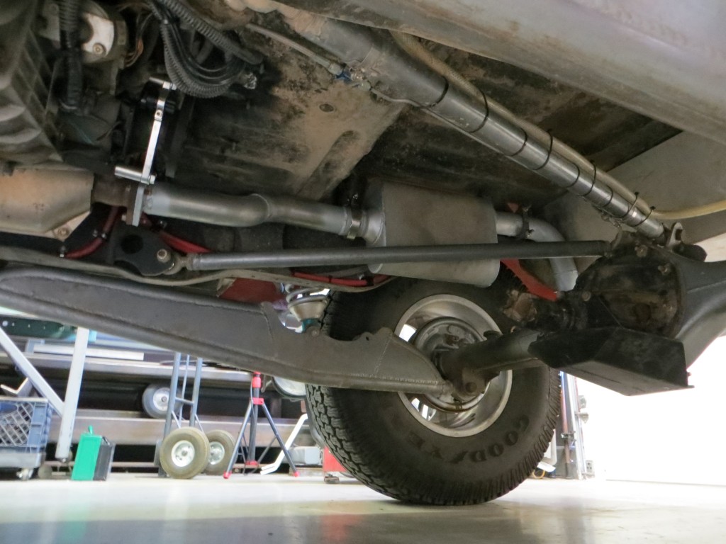

Was wondering why you are doing new beams? Going wider or back to stock width?
Re: Jim & Paige's Bronco
I think he said he was just rebuilding everything, not replacing.
Whos beams are those? Don't see too many with heims for beam pivot (although I hear it works just fine).
1Hondalover
Posts: 819
Location: Santa Clarita
Post by 1Hondalover »
Silverslk wrote:I think he said he was just rebuilding everything, not replacing.
Correct Silver.......nothing wrong just refresh and fix the broken R&P.
I have to guess the beams are Mexicali customs. They're nothing like most of what I see, but they work very well and most importantly keep coming back after a beating. We hit a huge hidden rock at speed in Cal City this past Spring and I thought we were done for sure. The wheel didn't fall off so I kept it to the wood and checked everything at the margarita stop.
Solid......unless Jeremy tells me otherwise.

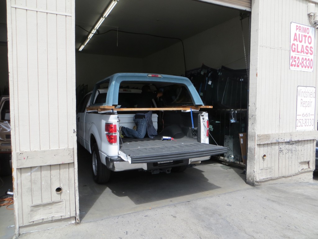

We left Greg's shop on Friday and drove to my buddy Dave Reeves' general repair shop with no windshield. Only a few miles of surface street thankfully.....I think my hair is still standing straight! Dave left the Bronco in his shop over the weekend to tackle the Punisher and A/C service. The next day I took the 96 roller and shell to the auto glass shop so they could pull the windshield and side glass to put it in Jim & Paige's Bronco. On Monday, Dave's team got our rig on the lift for the E4OD Punisher & pan, followed by a full fluid evacuation and fill. Everything there went flawlessly and then they got under the hood for the A/C, where all of the O-rings were replaced, a new dryer was changed out and the system was cleaned, oiled and charged. This pup blew 41 degrees in the hot afternoon on Wednesday!
Yesterday I moved the Bronco to the glass shop and they switched out the glass, using the OE 96 black trim around the windshield instead of the painted Mexicali mess we had prior. Now we have the Ford Carlite glass to match the rest of the renovation's original pieces! Jim & Paige's Bronco got home last night for a temporary stay, as necessary for me to assess the interior wiring design and schedule with Jeremy at Sprit Racing for the TTB rehab. I'll have Synergy ball joints in my hands in a few days for them to install.
