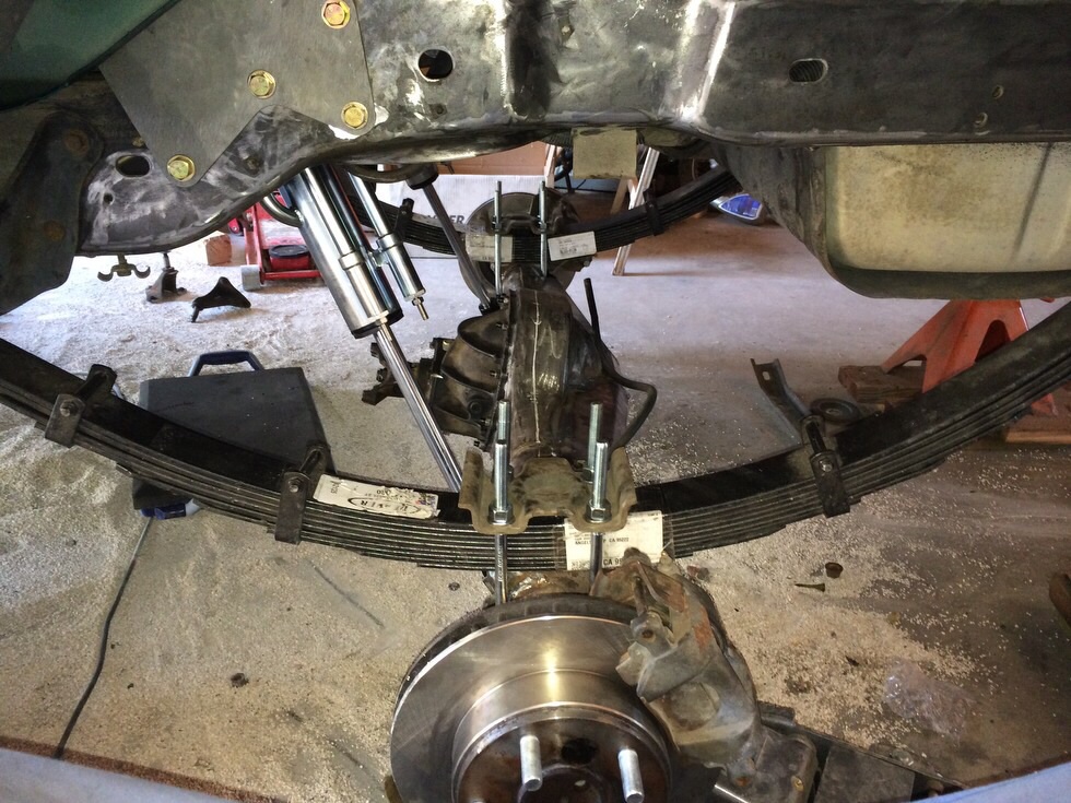

Re: Another Bronco Build
9" trussed
Q80's
New u bolts
Threat upper shock mount
Foa 12" triple bypass with reservoirs
ARB air locker
Disc brake conversion
New rotors and studs
Q80's
New u bolts
ARB air locker

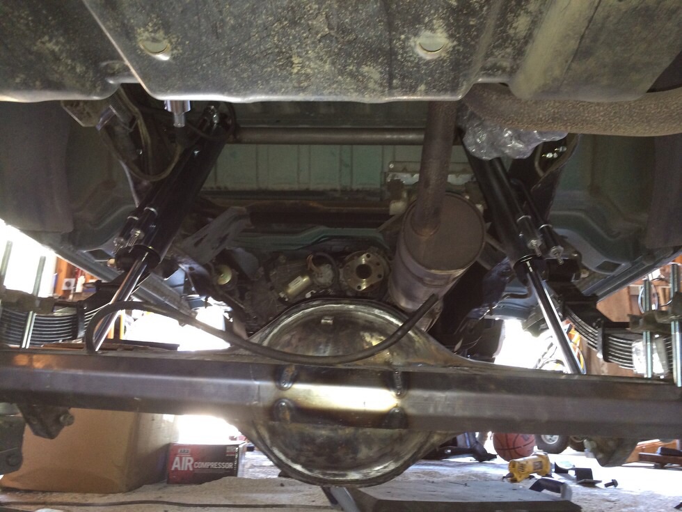

Side view b4 trimming of the u bolts
And rotating the rear shocks
Gonna need a shorter muffler....
Any recommendations ????
- image.jpg (274.83 KiB) Viewed 2233 times
- Posts: 6028
( exhaust idea ) Out the side in front of the rear passenger side tire and straight pipe or single chamber flow master. You could use a flow through magnaflow also ( the cherry bomb style). If you look there's some sheet metal you cut away and there's a straight shot to the side just above the passenger side front leaf bracket. Quite a few have done it at this location.
Robert that real estate is usually taken up by the upper shock mount unless I'm thinking of the wrong location

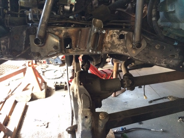

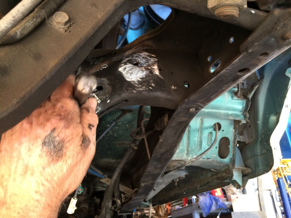

Autofab motor mounts are not simply bolt on.
- image.jpg (216.31 KiB) Viewed 2144 times
- image.jpg (193.19 KiB) Viewed 2144 times

- Posts: 4673
Uh you may have an issues. Mine were simply bolt on man.

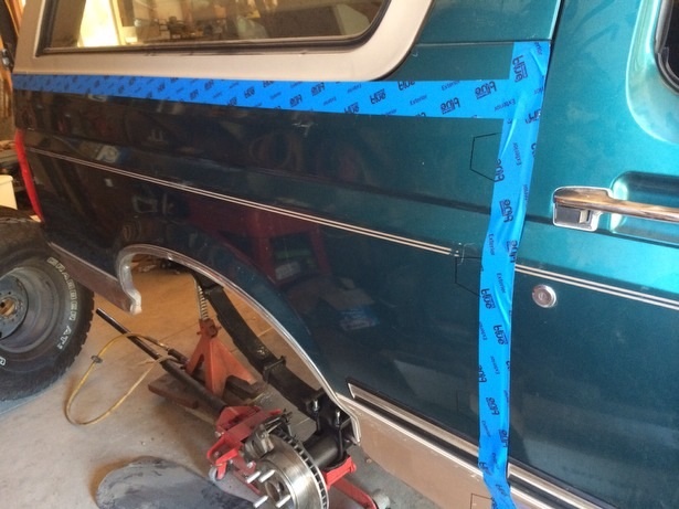

All taped up.
Ready for the cuttin wheel!

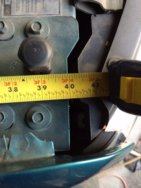

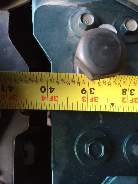

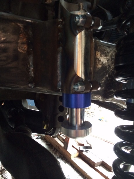

Measuring front end before removing fenders.
- image.jpg (89.77 KiB) Viewed 1955 times
- image.jpg (94.29 KiB) Viewed 1955 times

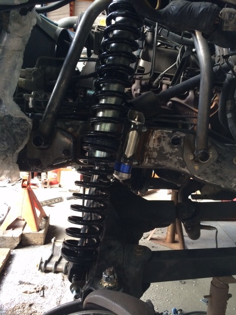

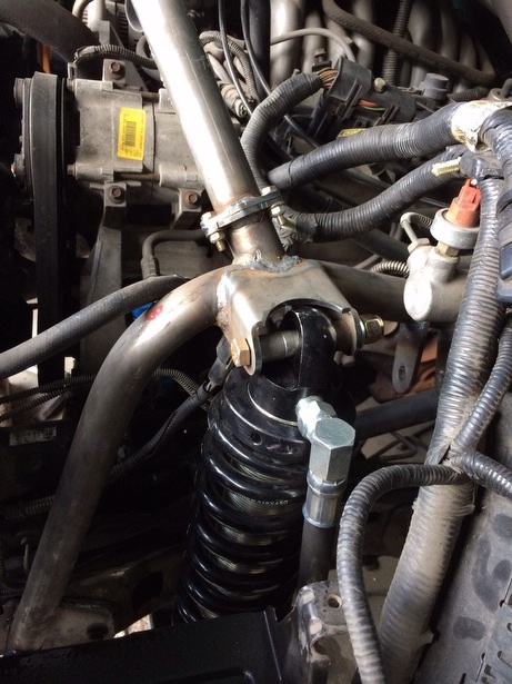

Getting the front end burned in.
Cycled several times, lots of measuring.
This is my first TTB build or any build for that matter, learning lots.

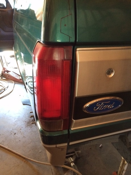

Trimming and hanging the rear glass.
Almost cried cutting up such a clean rust free body, sniff sniff!
So much for the original sleeper idea...
Haha, I'm over it, looks awesome with the wider glass!
Any ideas or thots on painting and colors???
