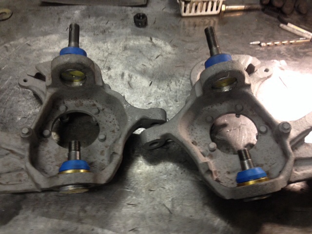

Ball Joint Bling!!
Got some new ball joint bling-- chicks dig "gold" ball joints :-). I am hoping the Raybestos premiums hold up to the TTB.

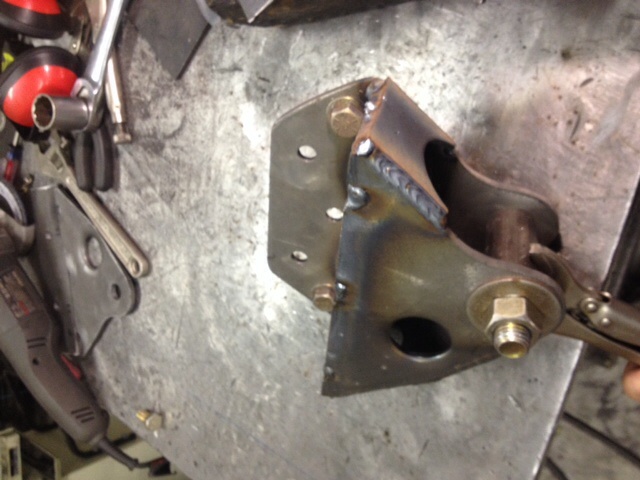

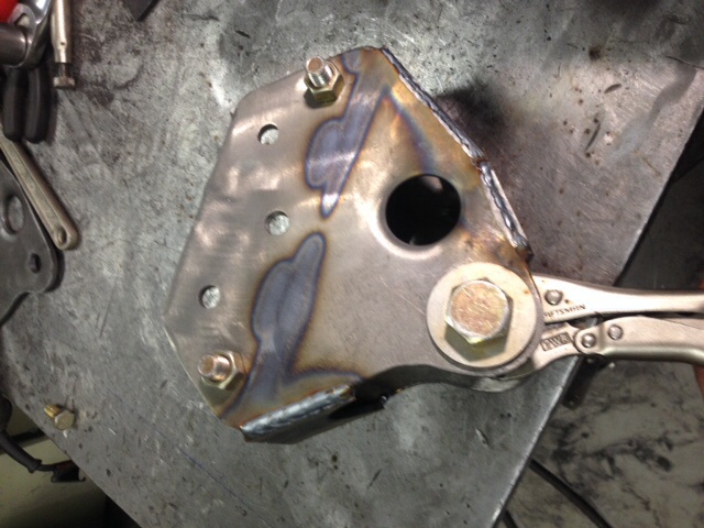

Rear Shocks Mounts
Rear shock mounts and the rear limit strap mounts

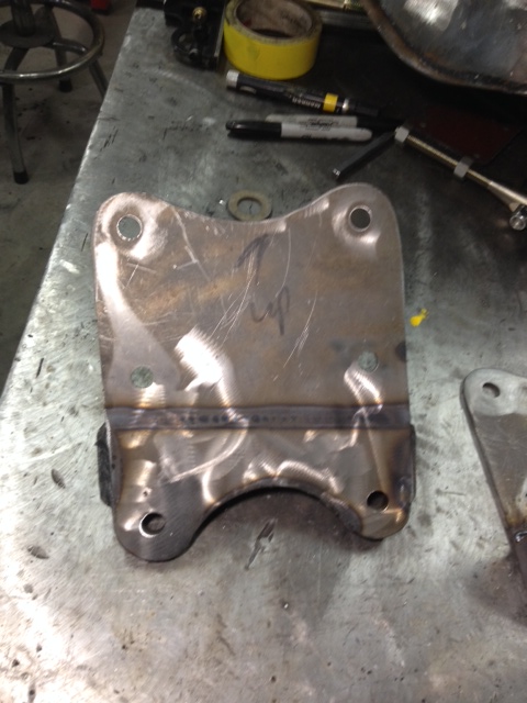

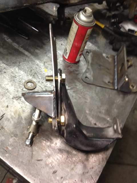

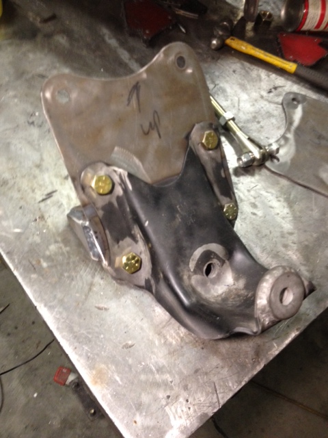

Rear Leaf Spring Drop Hangers
Here are the rear leaf spring drop hangers that I built. Hopefully these get me 3" lift on the rear but I dont want to spend the cash on the leafs at this point. In the future I want to run longer shackles anyway. Just made out of some 1/8" plate and some 1/4" angle iron. The Kel-fab units are so sexy and probably will get as set of those at some point. If the lift for some reason is sits too tall the beauty here is I can just just build longer shackles to lower the rear end. Hopefully this all works out .... hopefully :-)

Re: Rear Shocks Mounts
VintageIronFab wrote:Rear shock mounts and the rear limit strap mounts
Any plans to reinforce that rear shock mount once mounted?? I had my first mount built like this and it failed pretty quickly. A lot of load on that center disconnect. Just a thought.........
