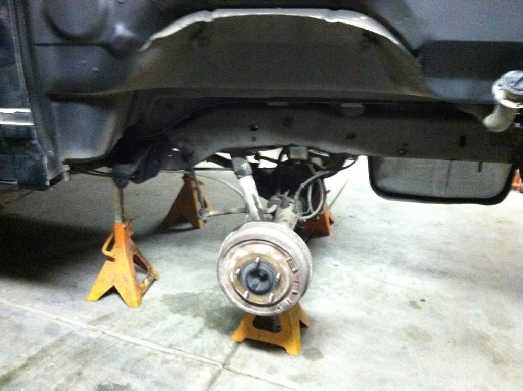

Finally tore into her
Re: 95 Bronco Build!
Shock mount is prety much done, also picked up a C6 and transfer case today

Ive got a shock mount identicle to to that and the side platea like to break at the point where the top plate ends at the tube. You may want to add a triangular gussett from the plate to the tube.

hobbyturnedobsession wrote:Ive got a shock mount identicle to to that and the side platea like to break at the point where the top plate ends at the tube. You may want to add a triangular gussett from the plate to the tube.
I am definitely going to do that, this set up has to be welded in to place once it's under the truck, I'll have to do the gussets at the same time.
Exactly what mine did too. Its really easy. I shouldve seen that before. Iy looks good!
