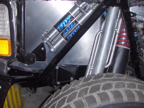

new bumper... with integrated snow plow/ deep rut high centering device. : /
But I feel that the skid needed to be that low to hopefully not bend a steering swinger or worse a swinger pivot.. I'll see how or if it works out haha

Re: Ryan's 91
nice and tight i like that. mine will be very simaler i can have anything sticking out due to the tilting glassfront i am using.
i like it keep up the nice work!

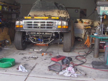

Re: Ryan's 91
Post by ryan B »
picturez
I wanted to put my oil temp sending unit in my oil pan. I didn't want to pull the oil pan So drilled the plug, and tapped it for 1/8 npt, and put the sending unit in the plug. I'll just put a single wire weatherpack connector so i can easily, and quickly do oil changes.
oil temp sending unit.jpg (152.56 KiB) Viewed 2247 times
drilled plug.jpg (156.26 KiB) Viewed 2247 times
I haven't pulled my skids in about a year :)
front view.jpg (143.92 KiB) Viewed 2247 times
Re: Ryan's 91
ok now i have figured out how i want my bumper. that looks awsome! allthough i wont copy exactly what you did but you gave me the right direction.
