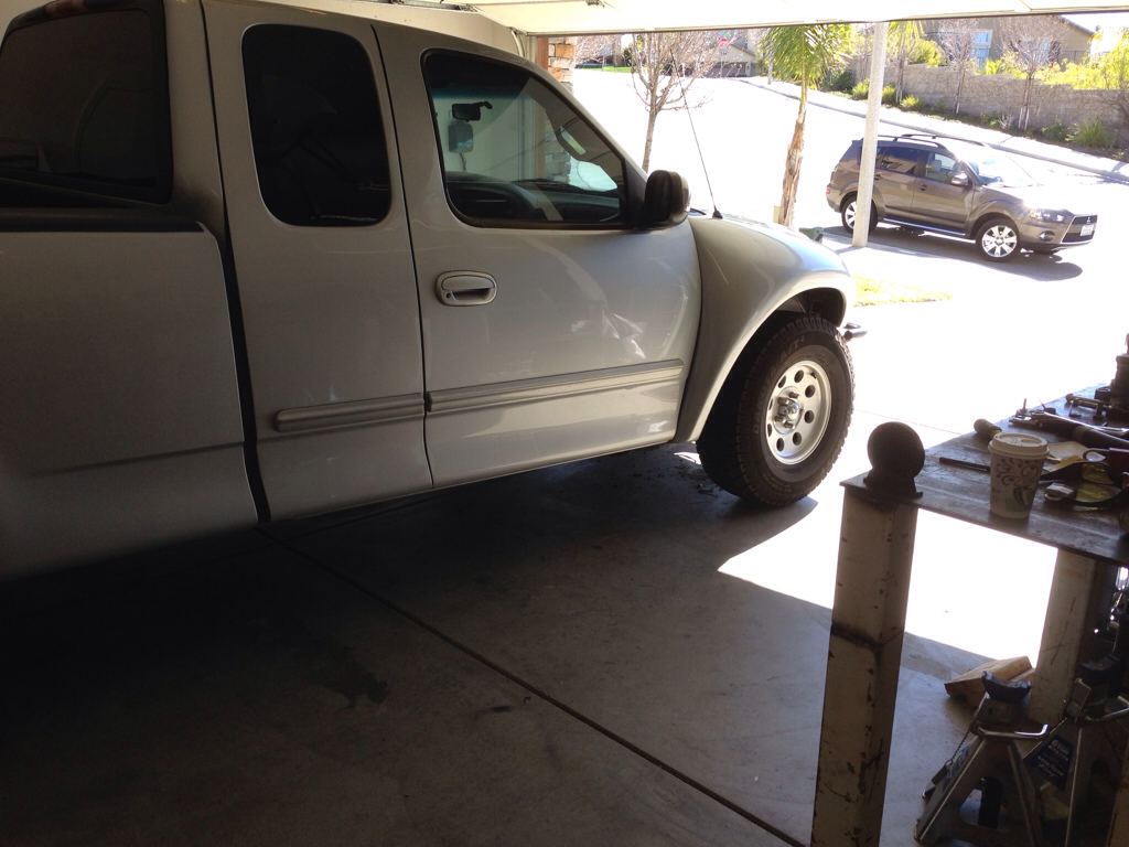

I was thinking of starting another build thread for the F150. But I think I'll just add my questions and updates here.
Here's a couple pics of probably a week or so after bringing it home. ( I think )
Had to pull the shocks to replace springs in the coilovers.

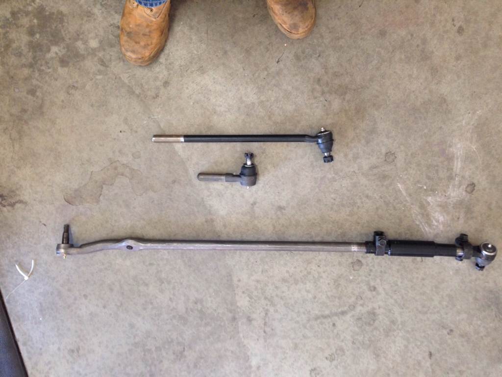

Also working on my steering a little

New steering made a difference. Took the unwanted slop out of the wheel.

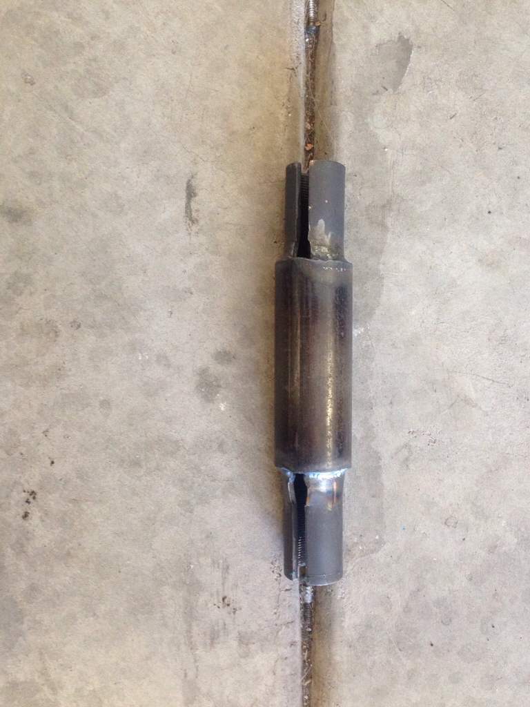

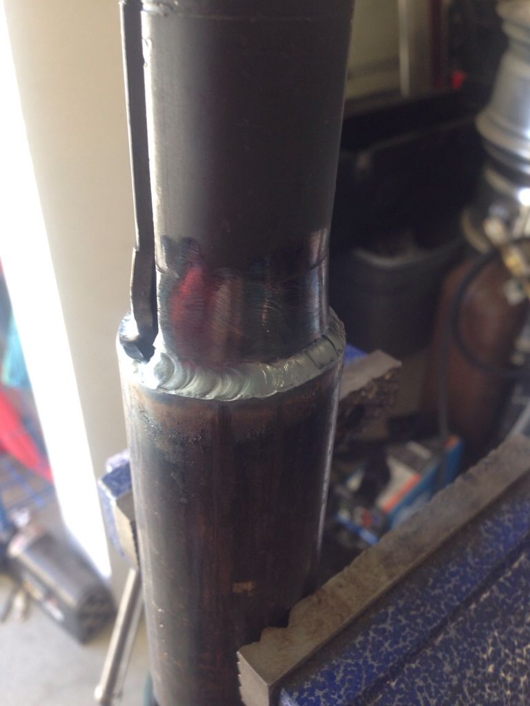

How did you extend the tie rods Jose?

I just extend the adjuster. It has worked good so far.
Re: Jose's 94
that's how people have done them for years. Should be fine
Posts: 4619
Re: Jose's 94
Looks good! I was just curious as I couldn't see it in the pictures.
Posts: 6026
Re: Jose's 94
I and my friends have beat the holy crapola out of the type of extension and never a failure. The ball joints fail before that union. I also rosette it on each side in 2 places. You'll have no issues.
