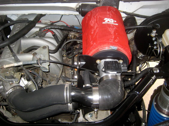

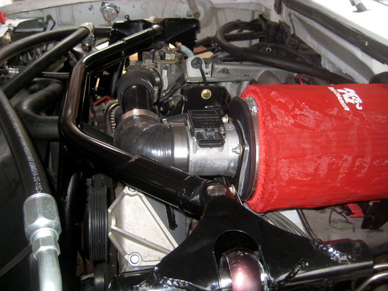

Got the bracket for the air filter done tonight. One more thing down!

Re: Brian's '96
Hey Brian, if I remember correct, the shorter the intake the less torque / more hp the longer the intake the more torque you get. Kinda random...
Re: Brian's '96
Good point; however, for now I'm just trying to make things fit. This is certainly not the set up I'm dreaming about.

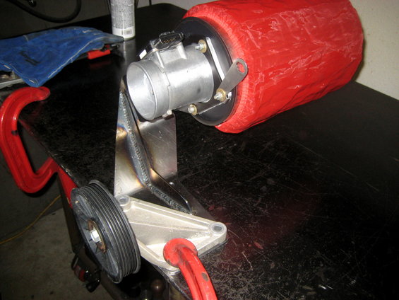

Haven't got much done the last few days, but finished up the bracket for the air cleaner.

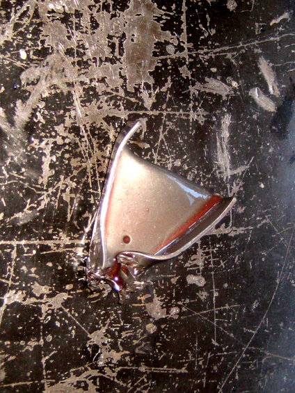

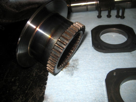

Well, shiz! After sitting on the garage floor for a few months I'm finally ready to get the T-case swapped in. It was seeping a bit, so I bought seals and cracked it open to re-glue the case. Much to my dismay, the anti-rotation plate to the pump was broken and laying in the bottom of the case. I doubt parts stores carry these things, but I guess it's worth a try. Bahhhhhh!
Re: Brian's '96
Take it out of you electric t-case. That part should be the same.

The range hub is quite warn and beat up. Probably needs to be replaced as well.
