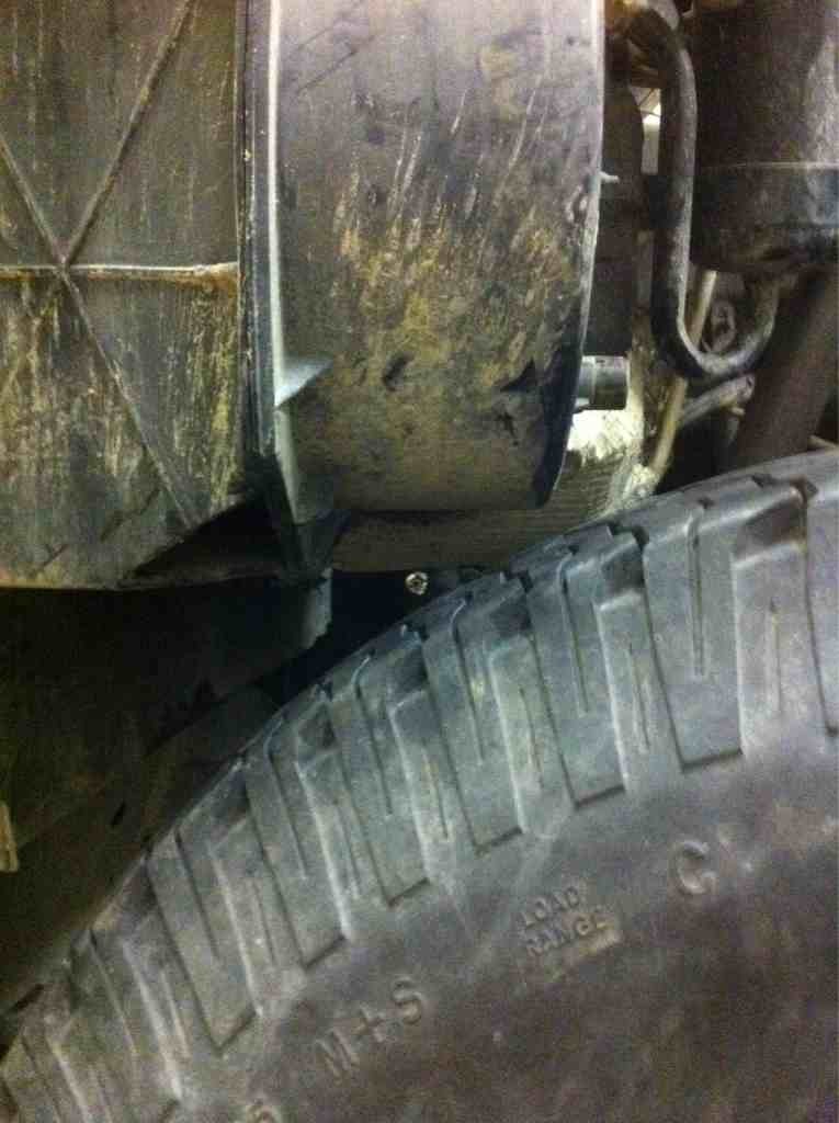

Hey Philo,
I take it you're going to pull the heater/air box to clear the 37's?

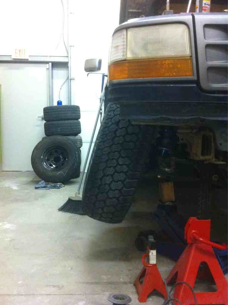

Philo's 93 Bronco aka "Lucky Bronco #3"
I limited my up travel a little bit and also started trimming the box.
As you can see the negative camber is excessive on the passenger side and will shorten the life of the knuckles and bearings if it went farther. Limiting the bump also will give more room for the steering as it hits the frame before the beam does.
